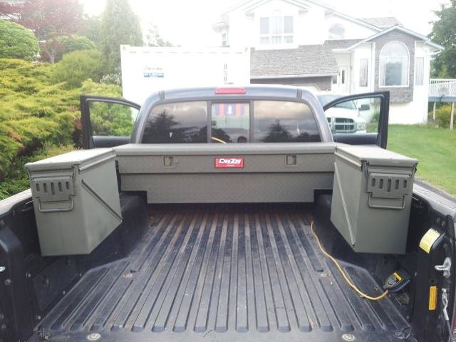

    Here is my contribution not for every buddy but I love the extra sealed storage they add, 2 bolts each with washes that fit in the bed rails some nuts and a drill took me all of about 20 min for both.

    Looks pretty interesting. I think cool, but where'd you get those ammo boxes?

    Work, I can get some on occasial but there is a bit of work that goes into them so I can take them home.

    What size are those? I've been thinking of mounting some hinges and doing a swing out ammo can.

    I'll measure em up after work for yeah.
    Where they are mounted right now is just temporary, they work well where they are, but they do sometimes get in the way when I'm using the Box for hauling stuff. I'm just not sure where else I'm gonna put them. I would like to put a propane stove in the tail gate with a cover on it, and have a sloped rear cover similar to the to green polar edition Tacoma down in Texas just without the fuel cells and have it a little more functional for tail gate camping, just not sure how I'm gonna do it just yet.

    If you put much weight in them they will likely tear out the bed rail - put a spacer behind them with a rubber bumper to go against the bed so they don't rock around .

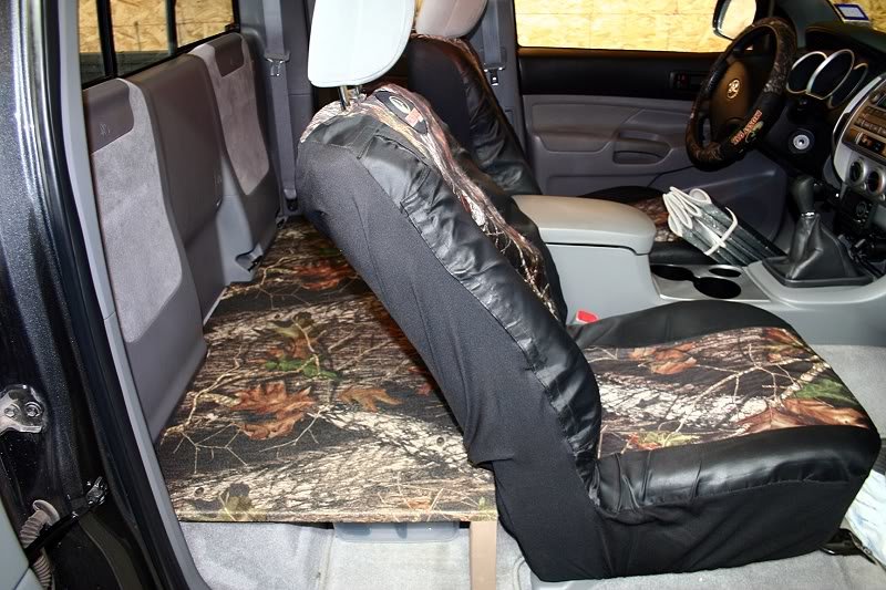

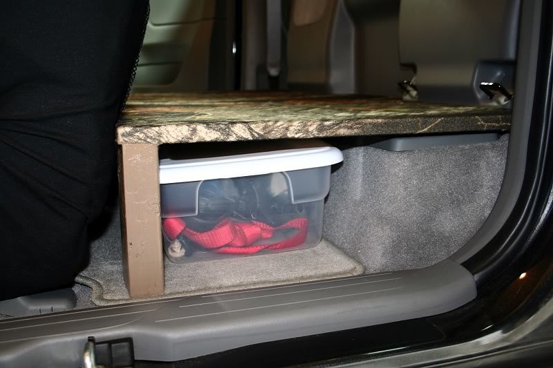

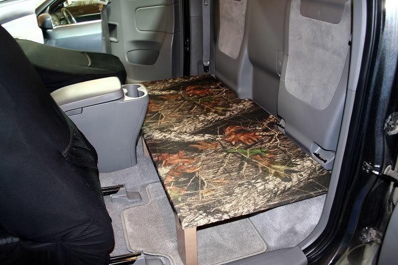

    I built this in my access cab, removed the seats and back console. I did this for more storage.

    I have been thinking of making a rear "deck" like this but then how do you get to your storage bins?

    the Ammo cans are 8 1/4 x 18 1/2 x 14 1/2 inches

    yeah though of that, there is not much wieght in them 2 can of napha and a small emergency stove in one and two jack stands with my jumper cables in the other.

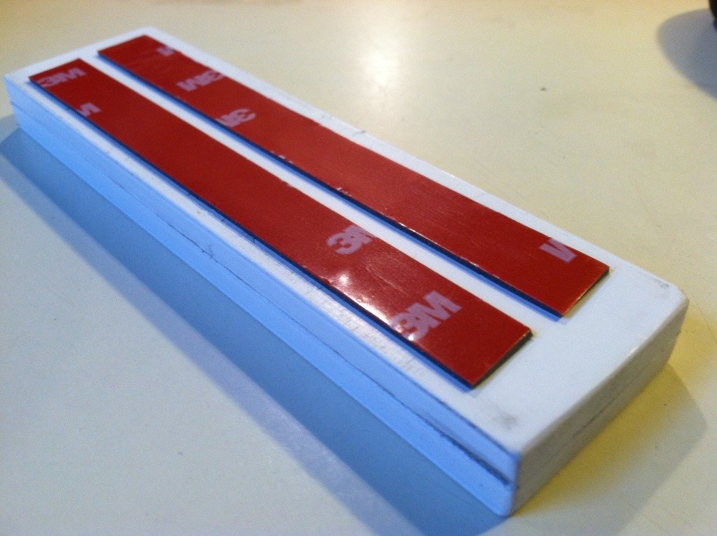

    Good advice. I used just ordinary rubber hose washers to cushion mine. Over years of being in the bed the cans started to crack a bit around the holes. I then added a spacer on the bottom of the can to make it fit against the side of the bed to stop it bouncing.
    Hardware.
    Spacer.
