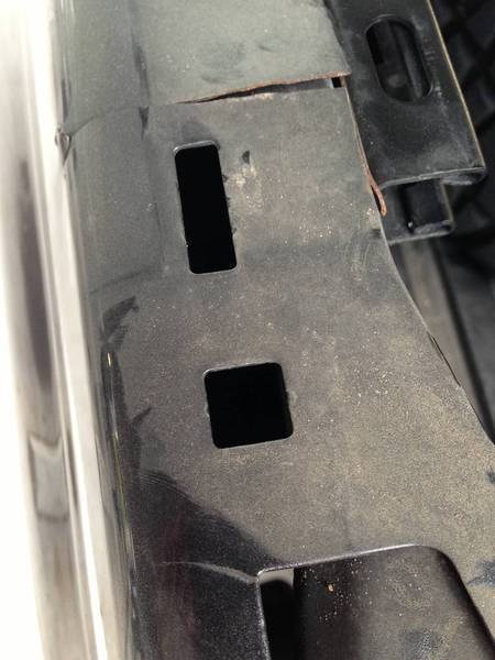

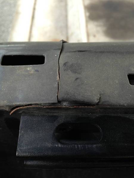

    I hope that you have those boxes supported by more than just the bed rails. My spare tire was mounted to the rails and sat fully on the floor of the bed, but still managed to move enough to crack the bedside under the rail cap.
    I can dig up the pictures of my cracked bed if you want to see them. I like the idea, but they're going to need more support.

    The design of the bedside is the issue. The composite bed goes straight up and stops. The metal bedside then wraps over the composite and is connected with the bolts holding the side rail. We don't have a fully boxed steel bedside like other pickups. Any repeated load on the bolts attaching the side rail to the bedside will cause issues.

    Just trying to help a guy out before he damages the bed of his truck.

    This damage is from the bedrail Spare Tire Carrier, correct?
    I was REALLY close to buying or building one like that, until I saw your thread.
    I still like the concept and use of space with that design, but it would need an addtl. brace tied-in to the bed or rear tailgate pillar to help displace the weight and lessen the shock/strain placed on the rail.

    So if you used a rail spare tire carrier and also used tie down straps and connected it to the bed, do you think this damage would still occur?
