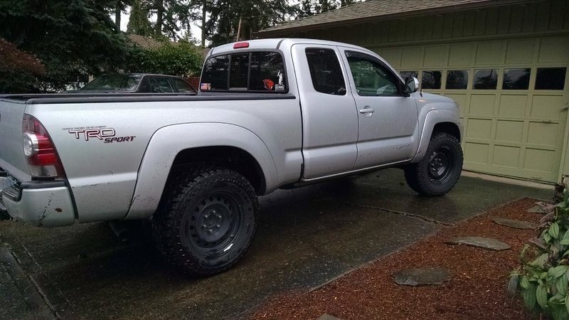

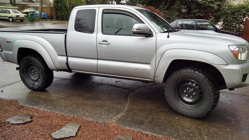

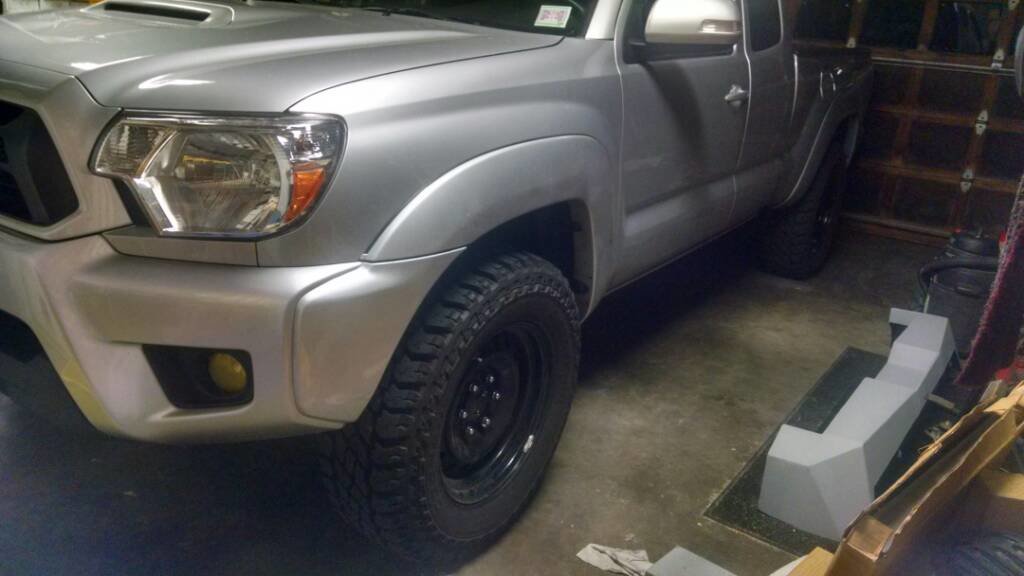

    BP, any more pics of the wheels?

    ^^What he said^^
    Looks good!

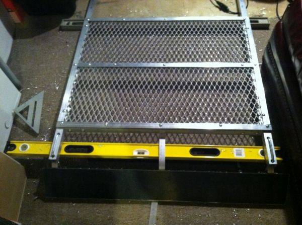

    Got a little bit more done on the rack today. Not going to win any beauty contests but it should work good. It's pretty stout, I have it propped up off the floor and I have been standing and walking all over it. It doesn't look like much but it has been a ton of work to get this thing to this point. I'm no engineer and there was a ton of little issues to work through. If I had to do it again I would do some things different, but I kind of had to modify my plans as I went. I just need to get the fairing worked out and get the Lexan corners and edges rounded. I have some more U-bolts I was thinking of using as tie downs but I like the low profile design. Besides, I think the mesh will be plenty sturdy for that purpose. One last thing to decide is if I want to paint it. It's all aluminum except for the hardware so it won't rust. I kind of like the aluminum but think it may look a little out of place.

    Looks real good Dennis! If it passes the walk on test your more than good! I know you have the black and silver going on on you wheels maybe try living with it "as is" for awhile. You can always paint it later on if you change your mind. Harder to do the other way around.
    Looking forward to seeing it on the truck:D

    Thanks Scott! Yeah, once together I'll get it on the truck and see how it looks.

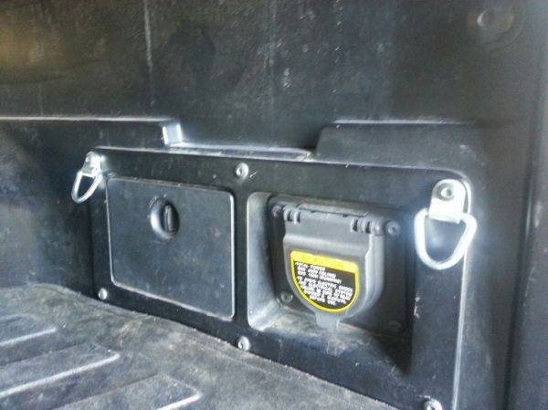

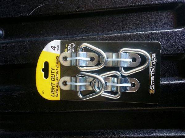

    Saw these at Home Depot and want to do this but I don't have a vise. Trying to come up with an idea on how to bend them.

    2 large vice grip pliars and heat the metal up first

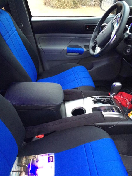

    CalTrend seat covers with paracord wrap on handle. I bought a Redlinegoods center console cover and it wasn't an easy install so I decided against buying their leather handle covers jus out of spite. IMG_1706.jpg

    just do what i did with the harbor freight D rings. Leave them as is, and simply drill another hole and add an extra screw and nut through the box. instead of bending them

    I have thought about just doing it that way, just hate to drill when I don't have to.

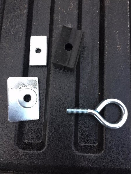

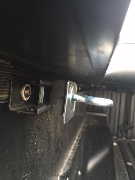

    I did some playing today, ever since I've had my bed cover I haven't been able to use the rail system so I picked up these tie downs from Wally World for $2.99 each.
    Had to cut the metal bracket down to fit inside the rail. Cut the length of the I bolt and the thickness of the rubber part and turned out pretty good IMO.

    Oh and had to cut the outer bracket to fit under the bed cover rail.

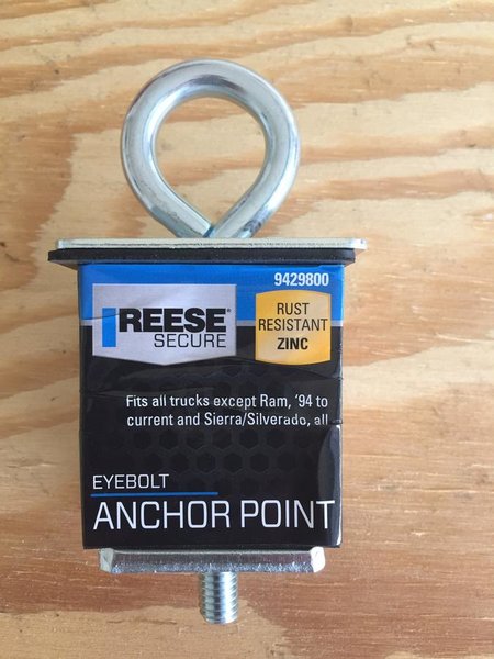

    Here is what I started with. Sorry can't figure out how to post multiple pics from my ipad. :eek:
