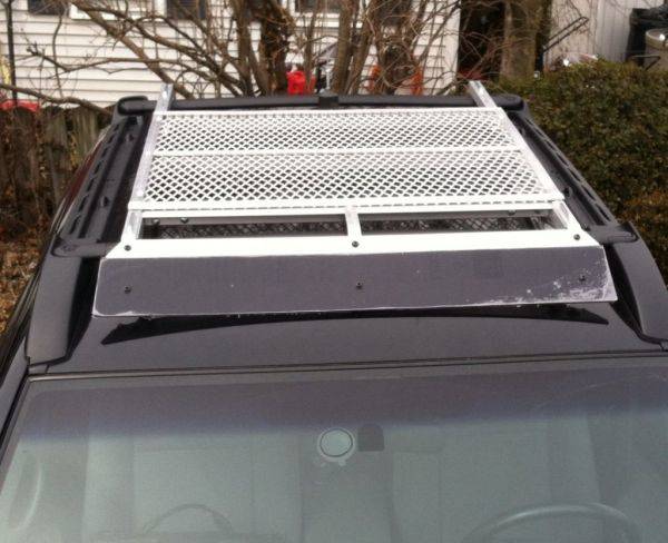

    Honeycomb composite sleeper platform.
    Perhaps consider some rectangle aluminum stock behind the faring spanning between the two points. If you have a metal supermarkets near you, they could help get the right material. I'd consider 6061 T6 as it is cheap and strong.

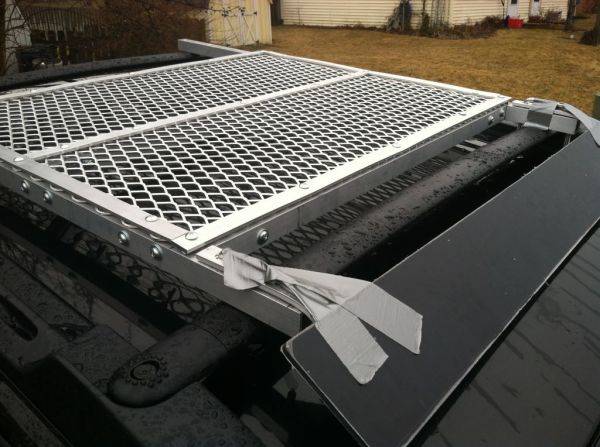

    Yeah, I have a good source for metal. I've bought a lot so far. :D My thought is some angle aluminum bolted to the existing bolts on the front of the main rack. That will leave a place to bolt the end of the center support. From there a strip of 1" at the top of the fairing tied into the supports. Then a square piece at the bottom of the supports tying them all together. Hoping that will work, I know it will take a lot of force from the wind.
    Side note: Anyone know a good way of shaping lexan?

    When I cut and bent my aux fuse tray thing out of lexan I used a harbor freight heat gun

    Roof rack is nearing completion. Just need to adjust the fairing and supports a bit. Still not sure if I am going to paint it yet. FWIW this was not the most frugal mod but it was DIY to the extreme. :)
