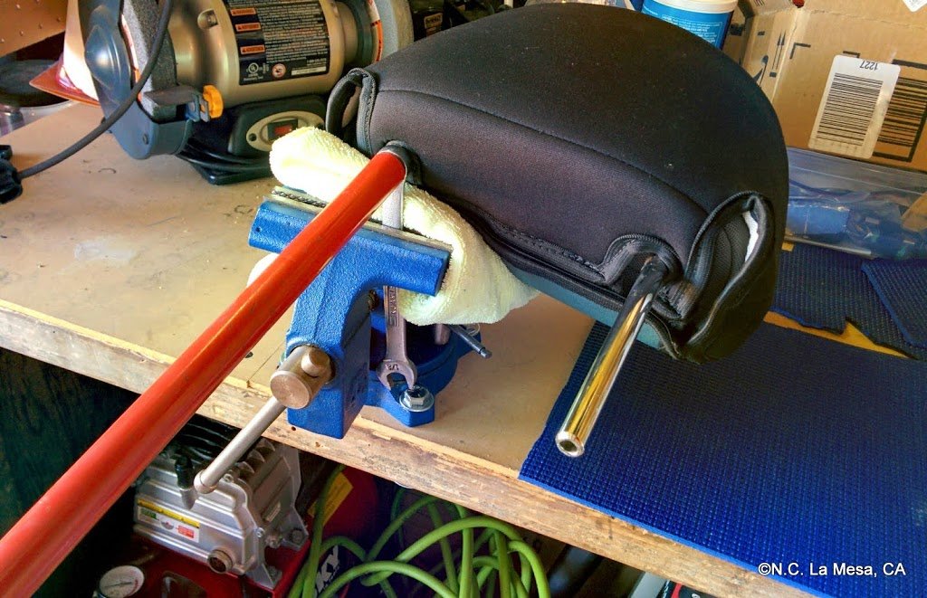

    After developing some neck issues I bent the stanchions on the head rests.
    Bench vice, 1/2" box wrench, steel pipe from floor jack, already all owned, so free mod for me.
    The angle is soooooo much better on the head rests!

    Been thinking about trying something like this since the back of my hat rubs on the headrest.

    Man that looks good. I need to pick up a couple from a local surplus store and do the same thing.

    Do you have pics of the modded headrests installed?
