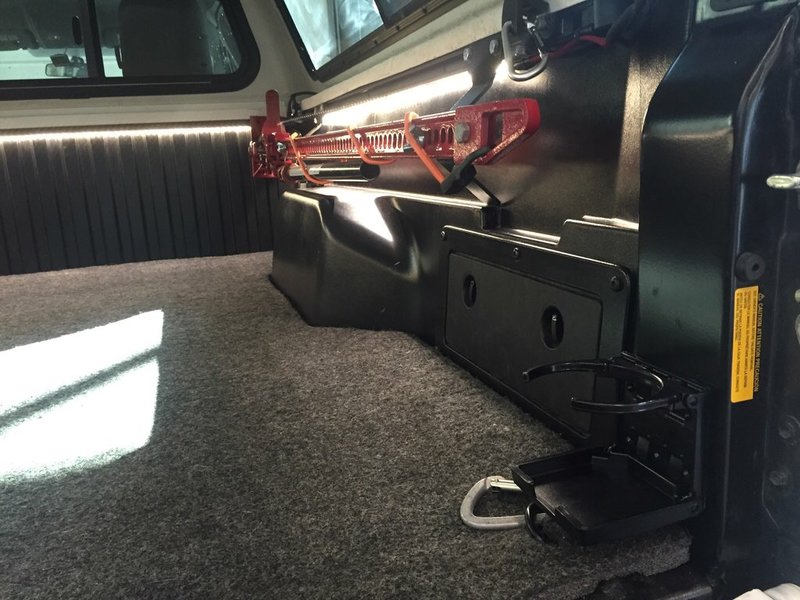

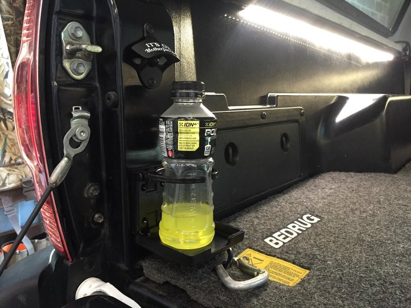

    I am sure it is back in this thread but where do I get these little cup holders?

    They work great I bought 8 of them and all of them are perfect. 4 in my truck 4 in my buddies boat.

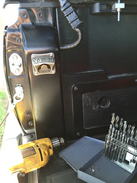

    Question to all you who screw in a bottle opener on the side of the bed: do you need special screws or anchors to hole it tight and handle the "torque" of a bottle? How long are the screws? I want to do this, but only if it's installed tight and won't loosen over the years.

    I'd imagine some washers on the back would greatly help, shouldn't be too bad. unless youre using that sucker 50 times a day :cheers:

    Yeti bottle opener, I used the stainless 3/4" screws it came with and its solid.

    You can pull the tail light assembly out (easy it's (2) 10mm bolts and grasp and pull taillight straight out, it's a 60 second job!), and access the rear section of the metal pillar to apply any backing washers / nuts.
    I did that to get my cargo system in.
