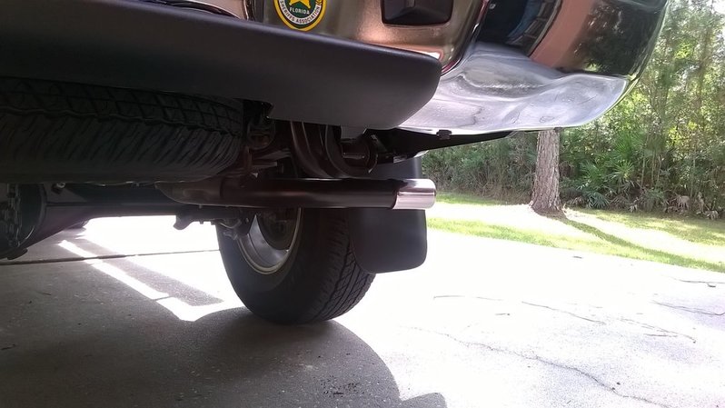

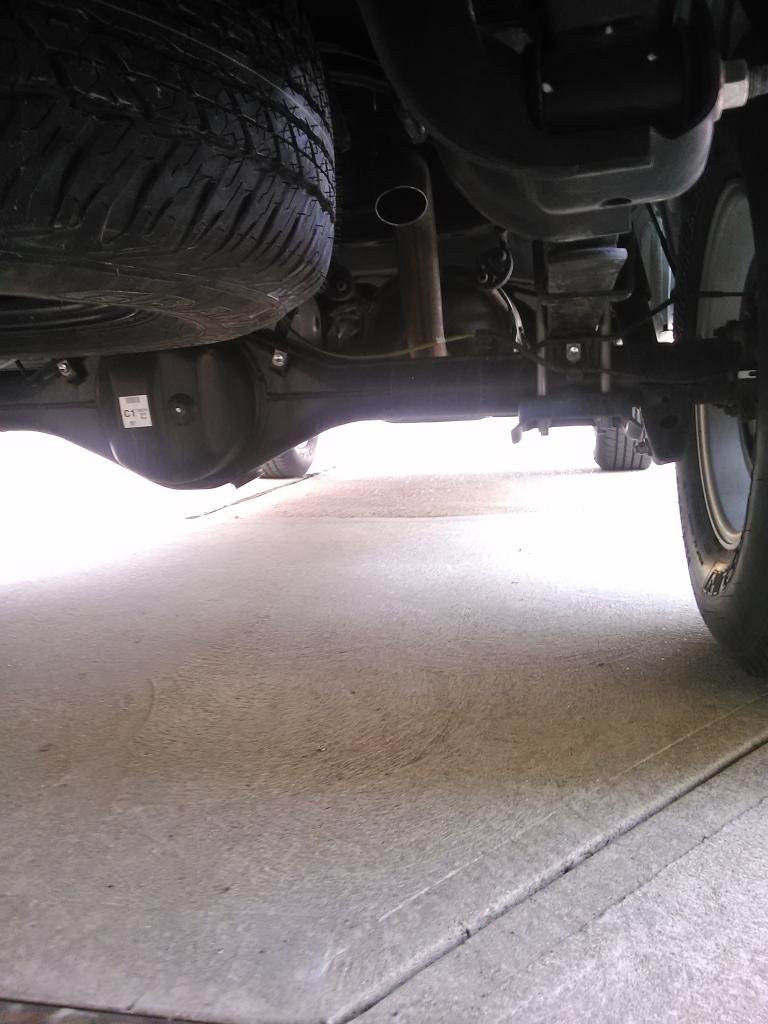

    Thanks! I sprayed the pipe all the way back to the last hanger. After that, the exhaust goes straight forward and you can't see it. Now the pipe looks good from the back and side.
    Tomorrow the paint will cure as I drive to work. It takes a few heat cycles up to 400 degrees to set the ceramic.
    You can see how far I sprayed in this pic. You almost have to be under the truck to see that part.

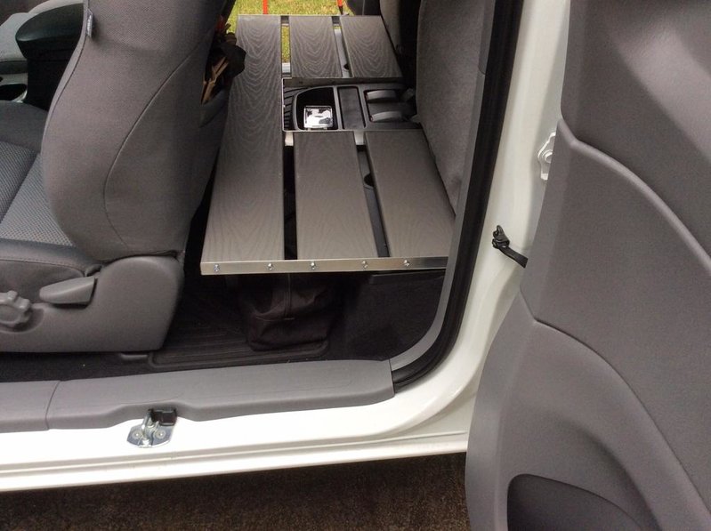

    I did a write in the original posting in dog platforms.
    I'll try to find it, I know I dusted the photos.
    Just used flat stock aluminum to create front legs, bound slats with angle aluminum.
    3/4" screws and power grab.
    Let me know, I can flip it over, get some fresh photos for you.

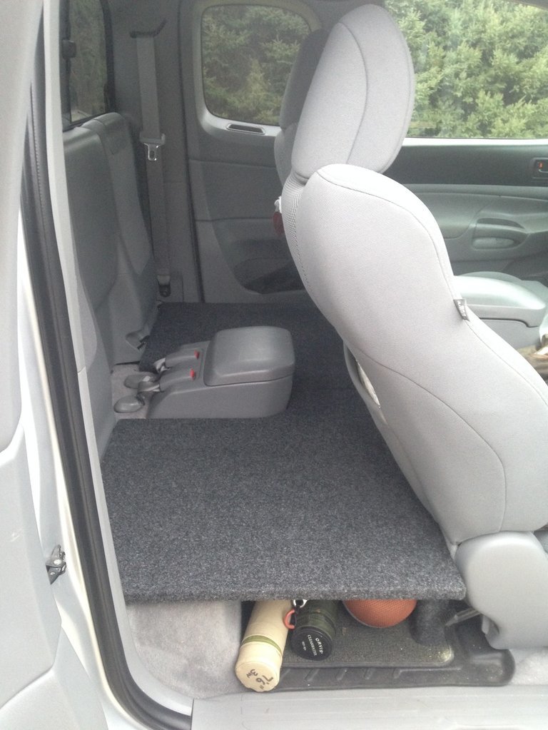

    The same shit everyone else has.
    Word of advice, 3/4" MDF makes a really nice platform. 1x1" makes fantastic legs. Wrap it all is speaker box carpet. 100% functional and very strong. It'll hold my weight no problem.

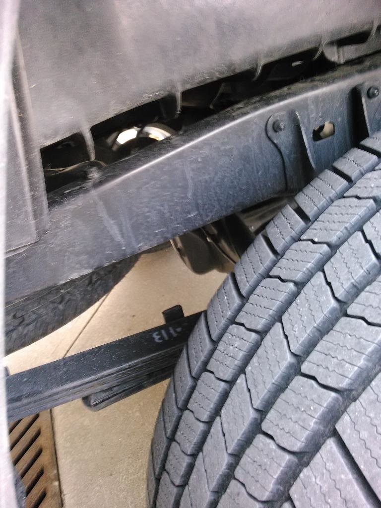

    2005 PIMP MOBILE

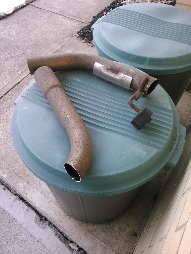

    Yes
    I cut these suckers off.
