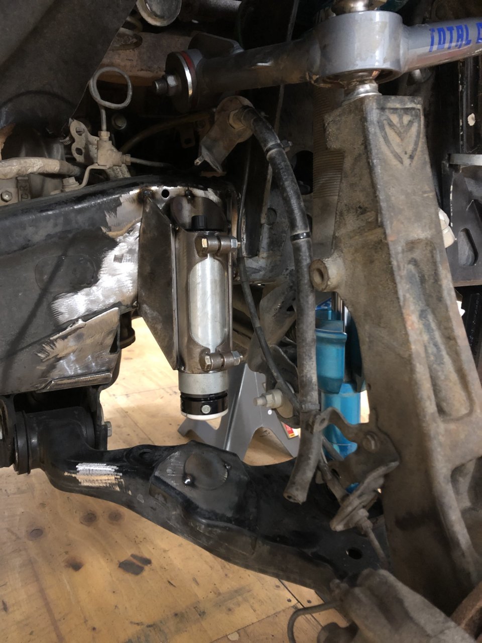

    20190112_155326.jpgStraight up and down I ended up with the pad travelling on the strike plate. I sure hope the bolts hold...

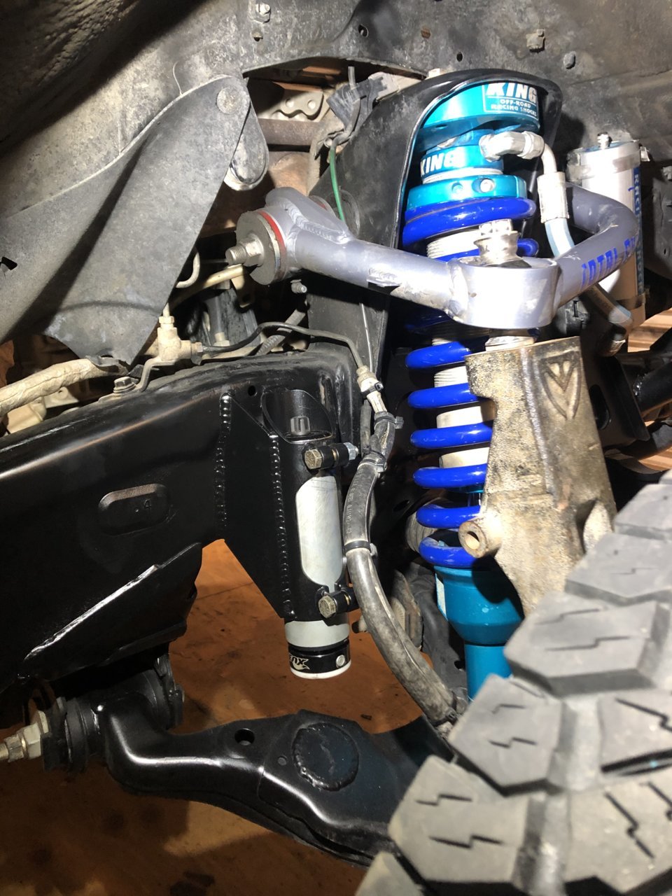

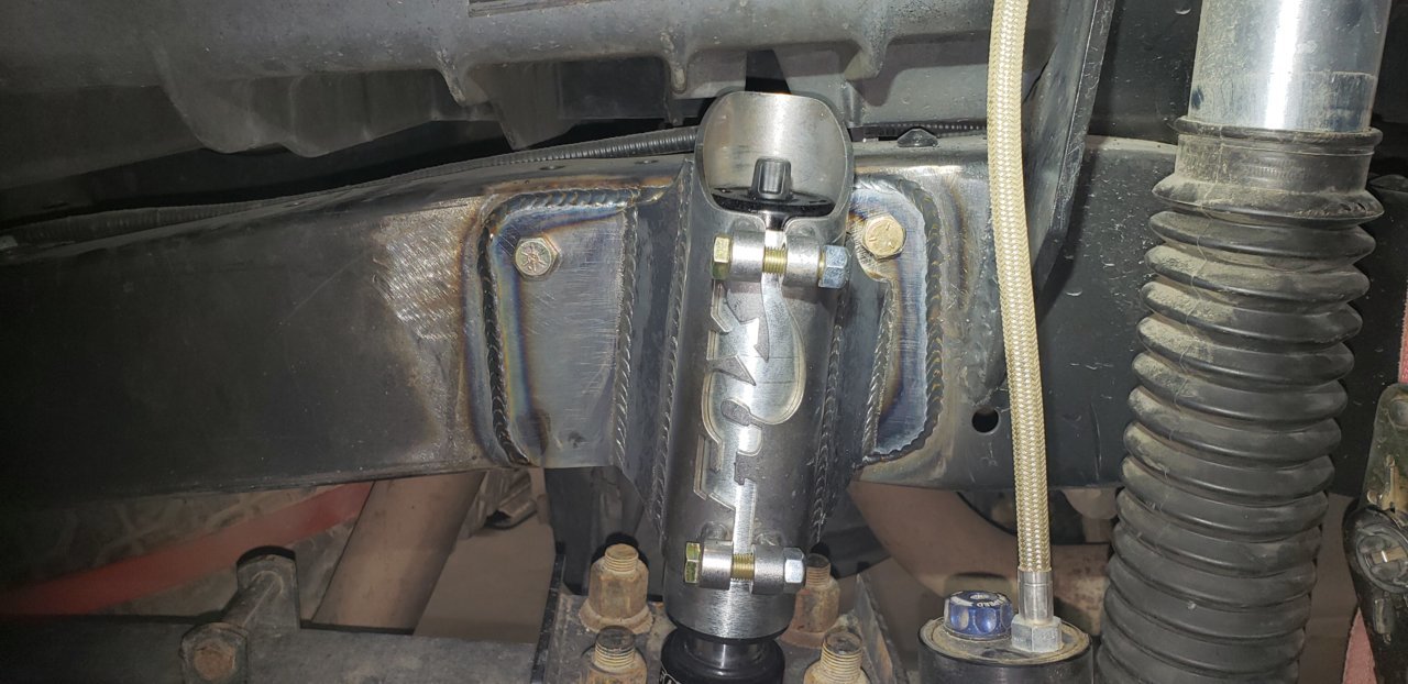

    046F5DAD-3B77-4A24-A025-97FECDADA4D0.jpg AFFC3839-7BA1-4704-801B-D2BDD866C9E8.jpg I did a lot of looking for answers regarding fox 2”x 2.0 bump stops on the front end of a 2nd gen Tacoma on stock lower arms. Didn’t find much at all and this thread kept coming up so thought I’d share my experience. Found a few photos of guys who had done it, and was frustrated with the 3rd gen mounting options compared to the 2nd gen which had done. In the end I had a buddy fabricate an option for me for a reasonable price. I’ll add some pictures of the results. Haven’t done a good desert trip on them yet but they fit nicely. Had them charged with nitrogen today and when at zero compression they barely sit above the lower arm.

    @Patolioli that looks like a nice, budget-minded setup. I'm having a hard time understanding your last statement, are you saying that at ride height, they are not contacting the lower a arm?

    That's a nice looking setup, sir
