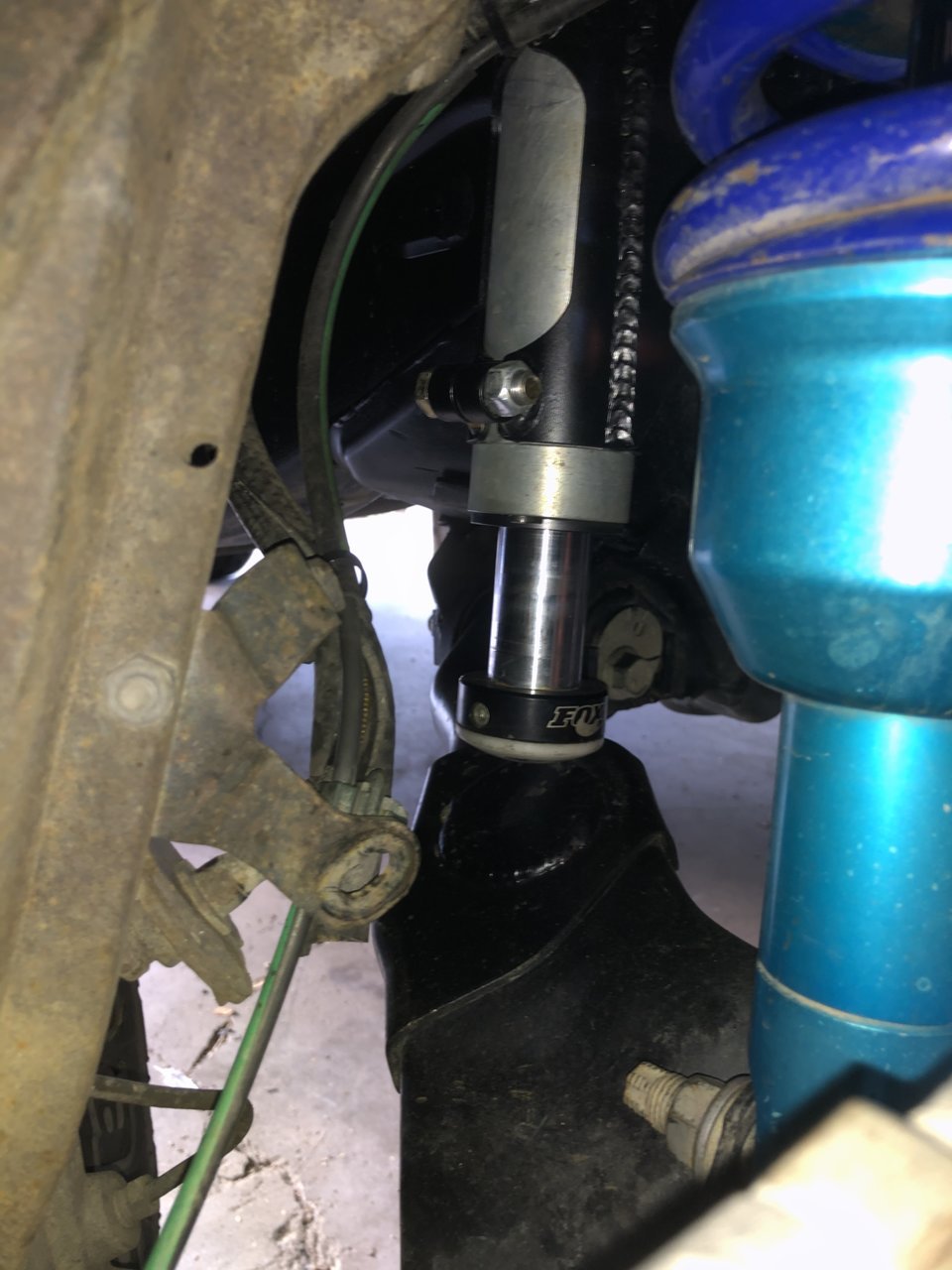

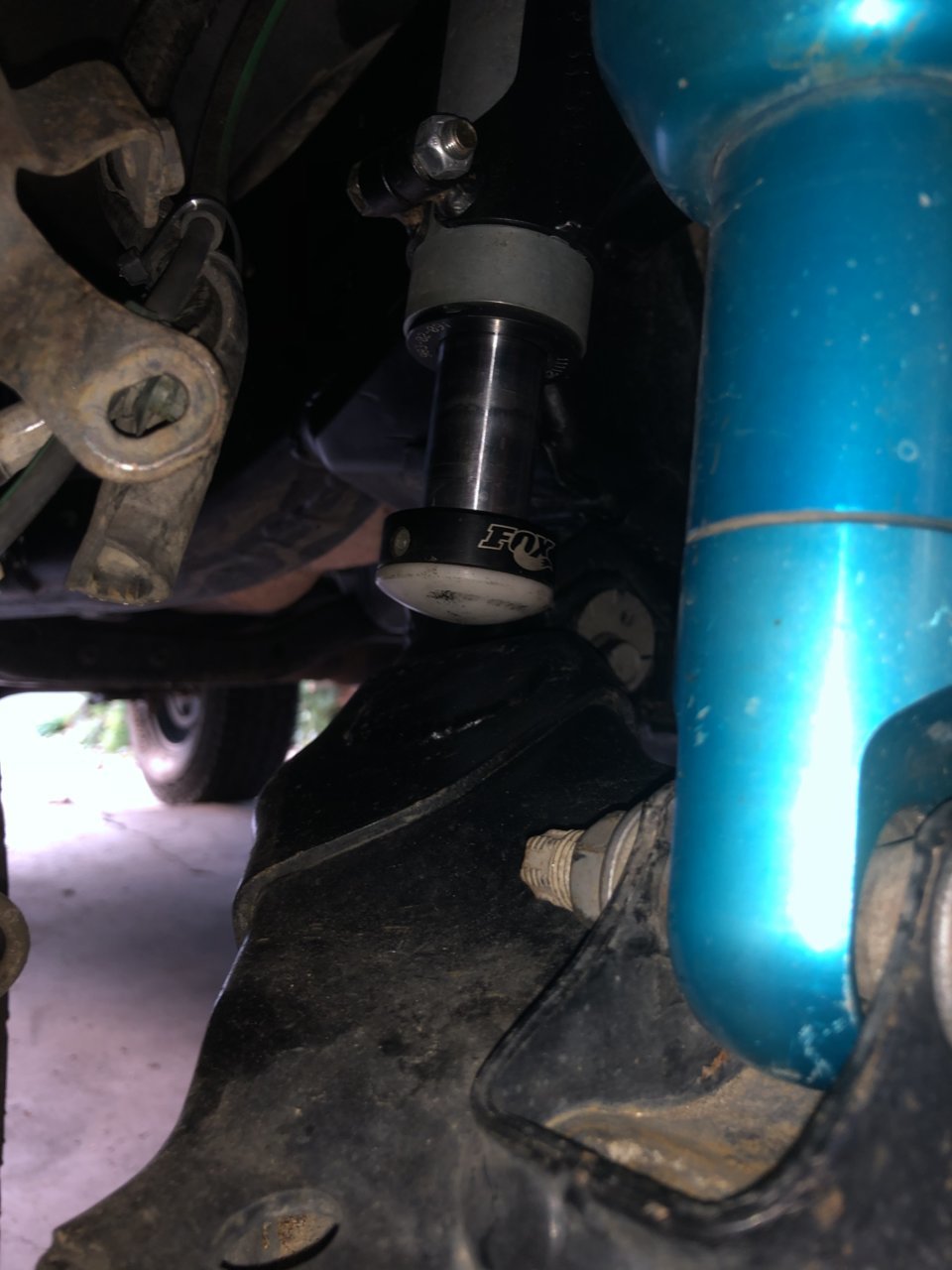

    @shmabs correct. At ride height they just about sit on the lower arms, and have a hair of clearance. Really decreased my body roll on turns since they contact at the slightest bump or turn.
    @m00seNUckLEz thanks! It works really well for what it is. Great daily, but also does well in desert and small jumps.

    @Patolioli are the contact surfaces between the bump and the pad on the A arm pretty close to parallel to one another when they strike?

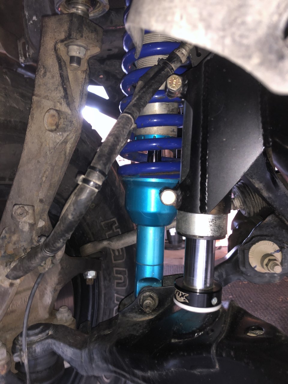

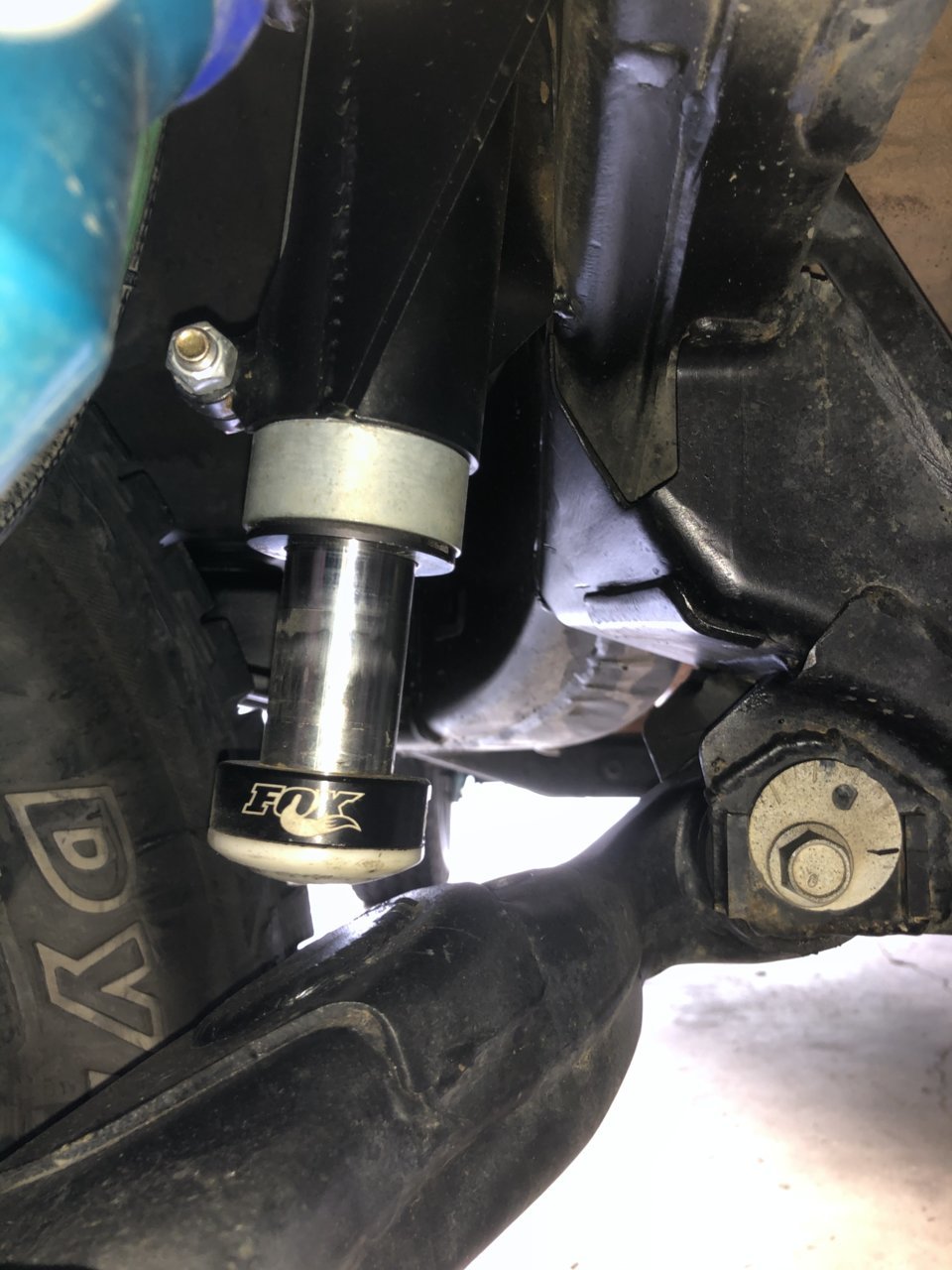

    @shmabs no it’s set at an angle so that it will be aligned (parallel?) when fully compressed. I’ll take a couple more photos in the morning.

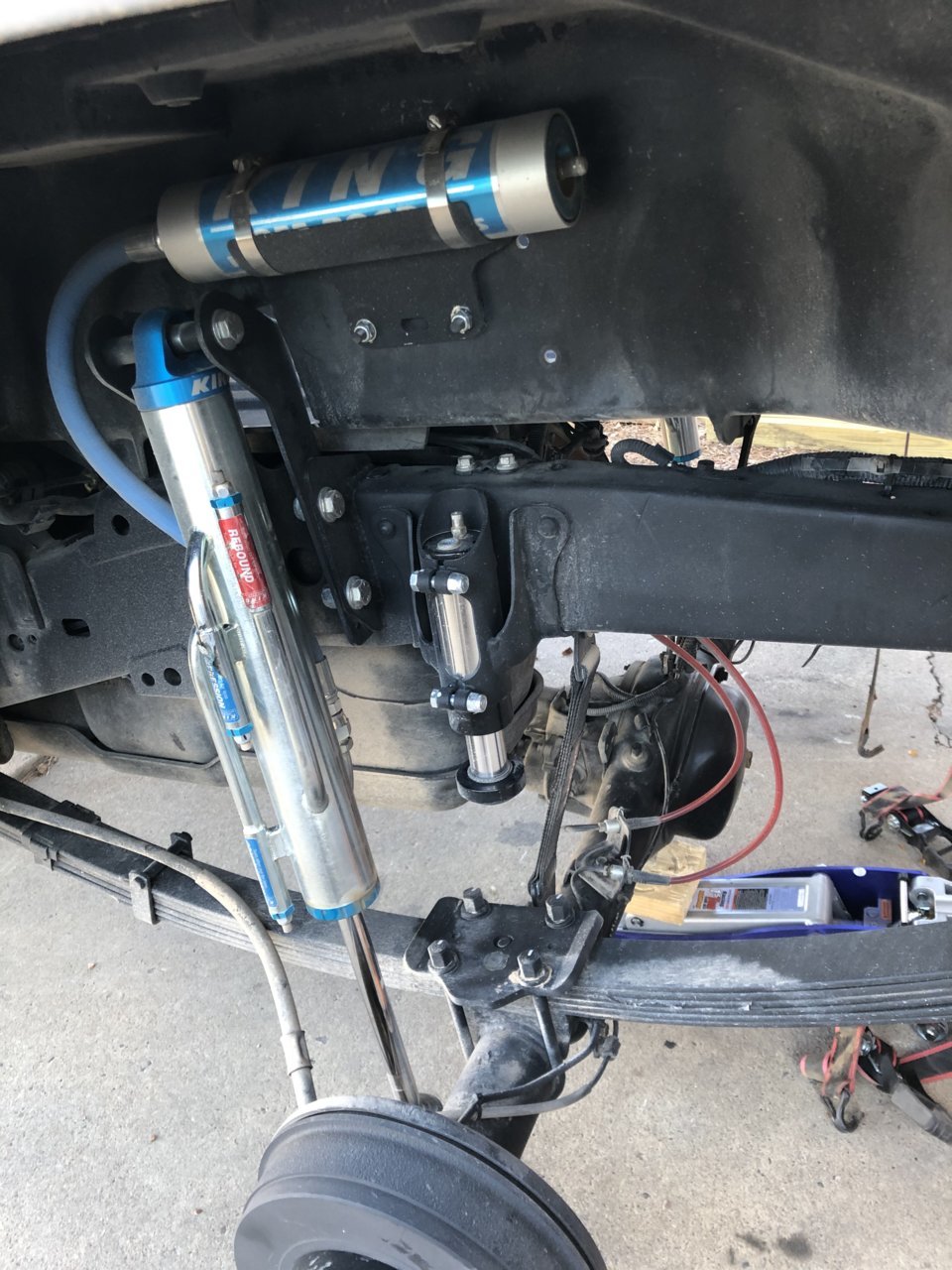

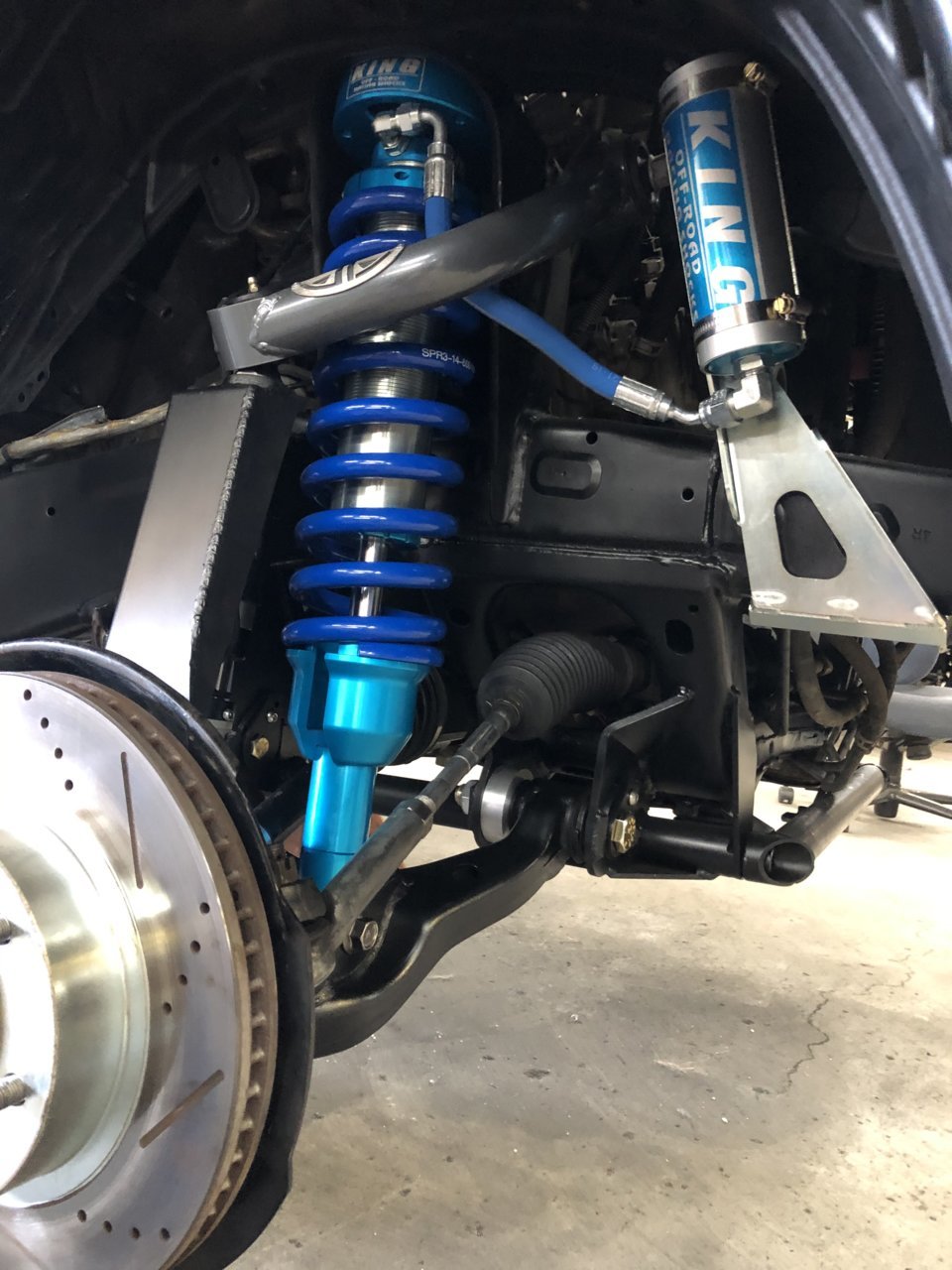

    Full Camburg LT front suspension, King coil overs, Rough Country spindles, King 2.5 reservoir rear shocks, OME Dakar spring packs, T100 E-locked rear axle, 35x12.5x17 tires, Fiberworx fenders and bedsides.
    FOA 2x2 bumps. 250 psi front/200 psi rear. All 4 running 20wt shock fluid. I’m actually really happy with this set up at this point...

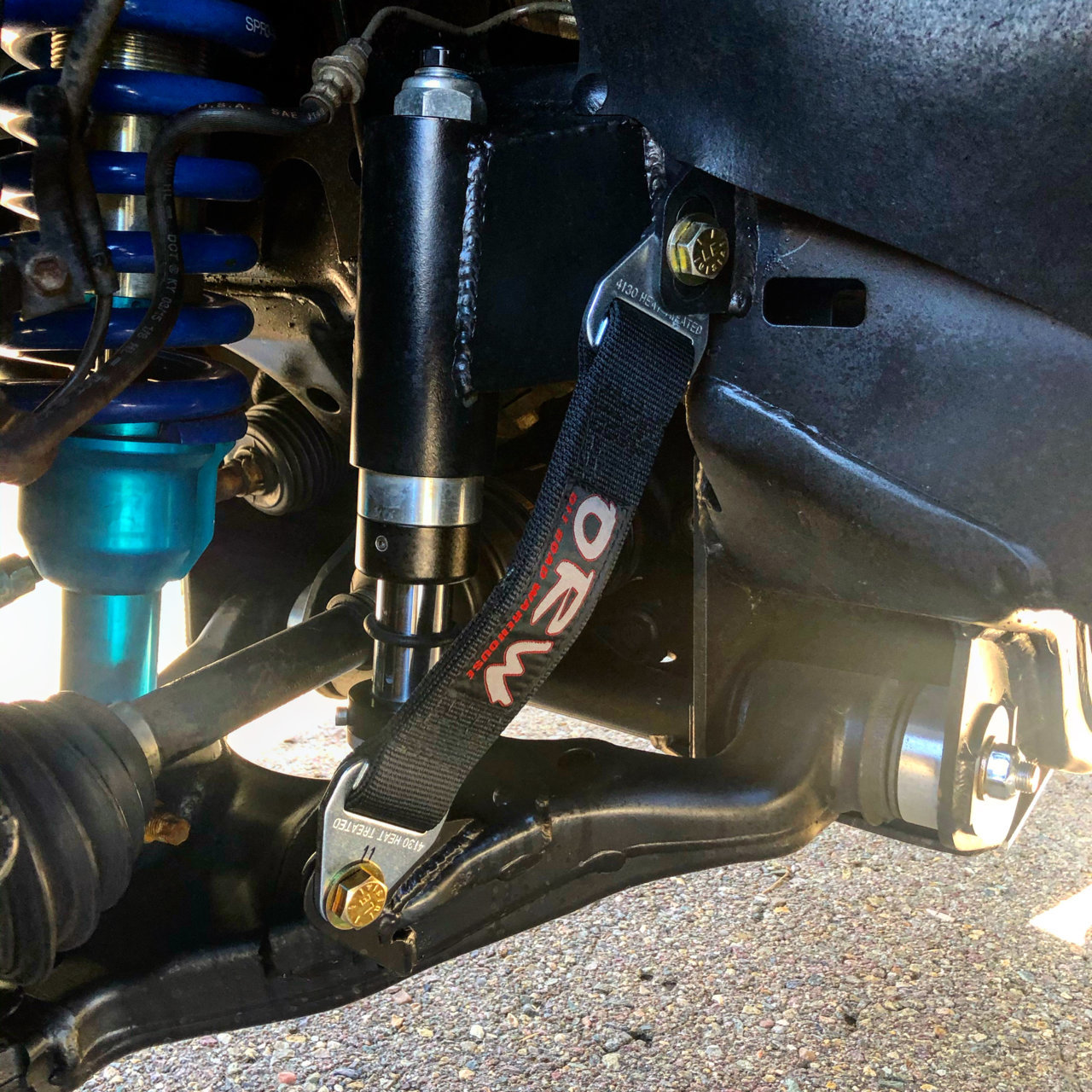

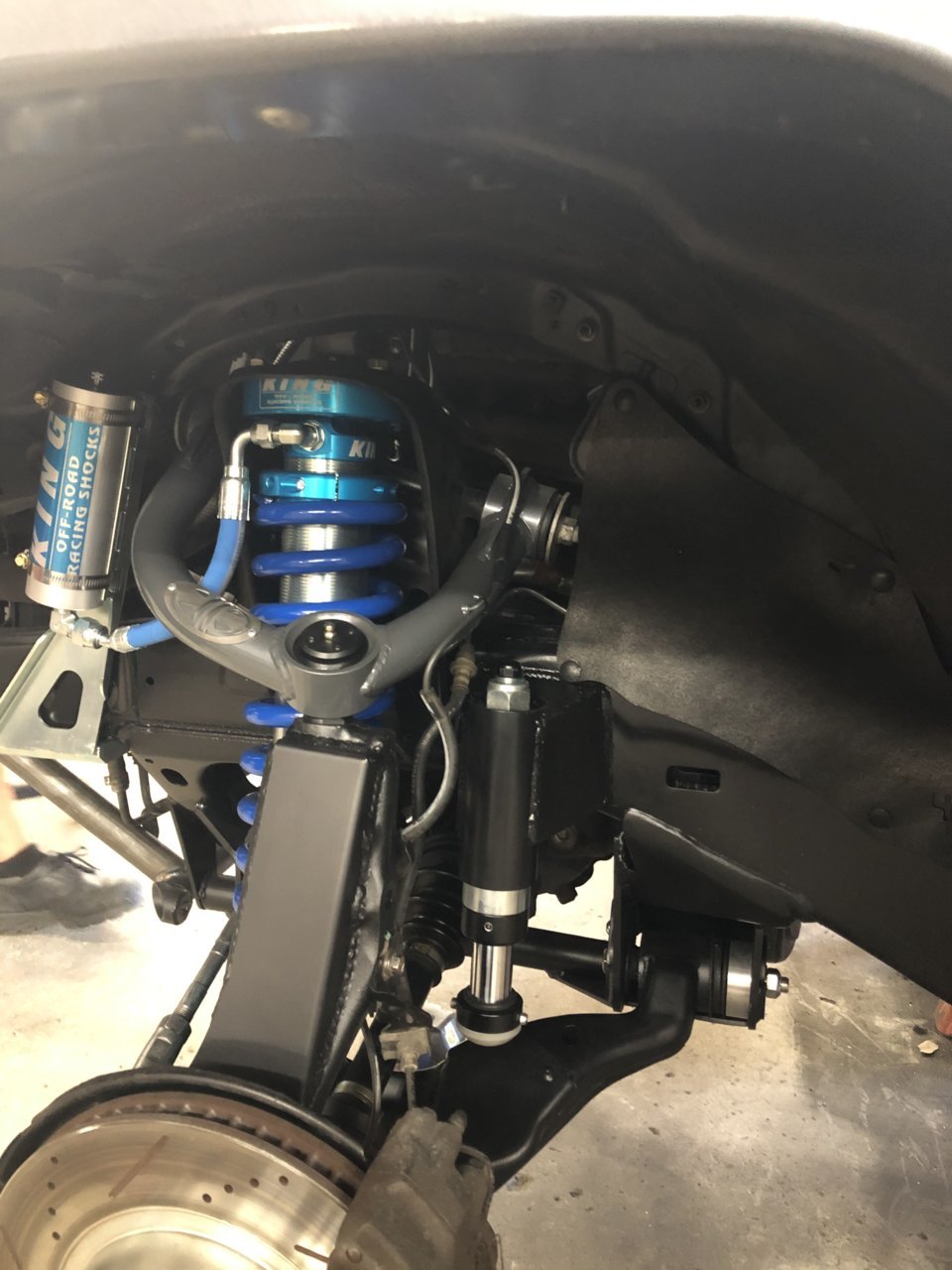

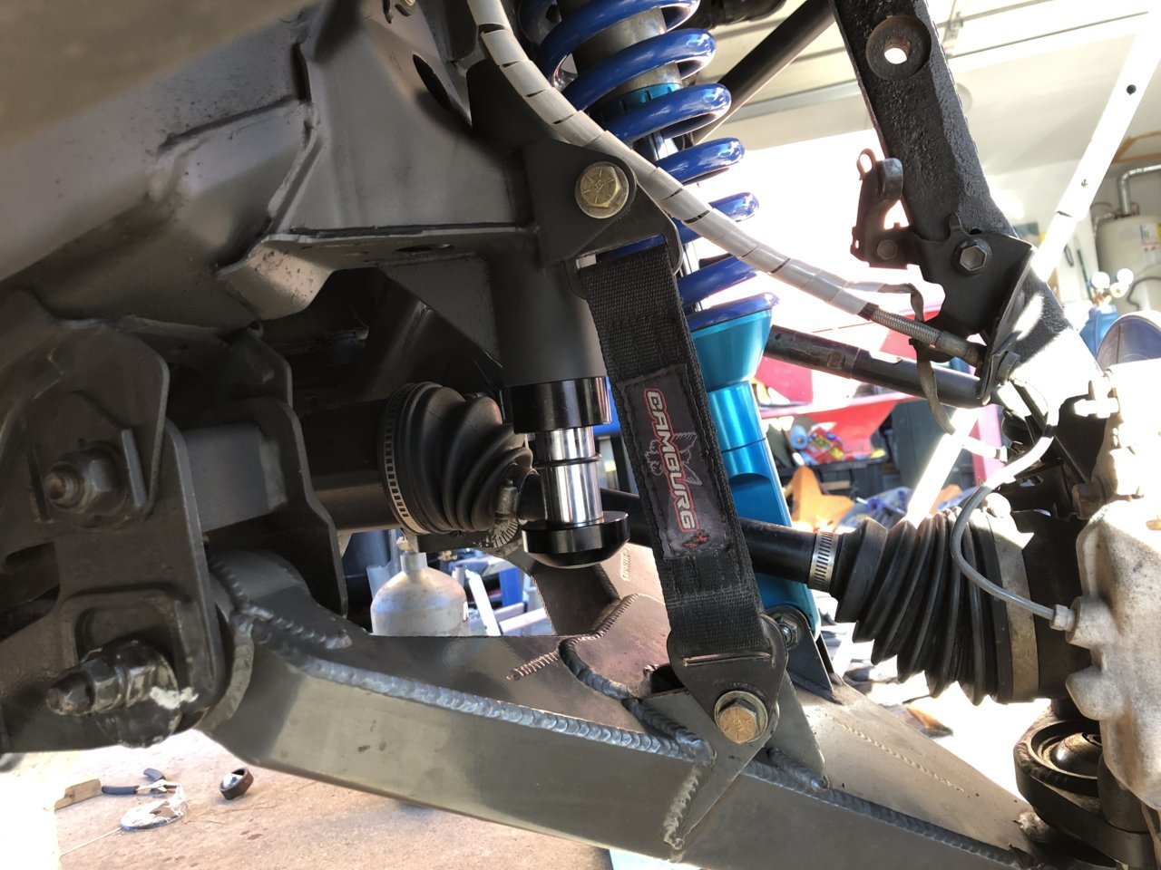

    Did mine a while ago, adding limit straps made the biggest difference to ride quality

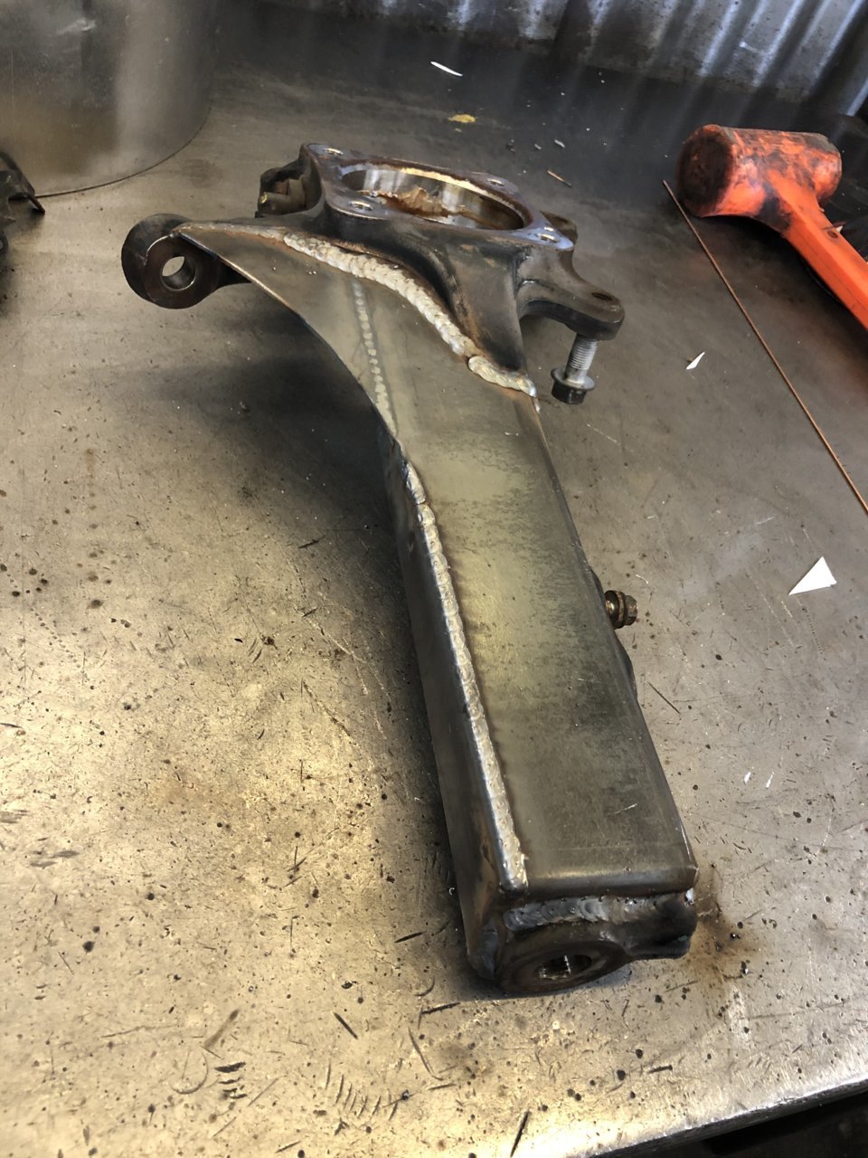

    @81Trekker sweet set up, are those solo spindles? Why do limit straps improve the ride so significantly? Might need weld a tab on there and throw some on. Also, what psi do you have your front bumps at? Tia for the interrogation.

    My own spindle gusset design which can now be purchased from JD Fabrications. The straps keep the suspension from having a harsh drop out and get rid of the clunk. I run 200psi

    Got it. Those look sweet. I also am running 200. Guess I never thought of the dropping out as being a harsh part of the ride, but it’s not exactly hard to add straps so I might as well try it out.

    What’s the deal with the big spacer in the lower arm bushing?

    If I'm not mistaken it looks like your upper limit strap tab is adjustable. Who makes that?

    @81Trekker I think you may have missed this. I'm just curious who makes that adjustable cam limit strap tab? I'd like to pick up a few.

    You can get them from trail gear or Kartek

    Hmm, just seeing normal limit strap tabs and clevis's on there, no cam style ones.
