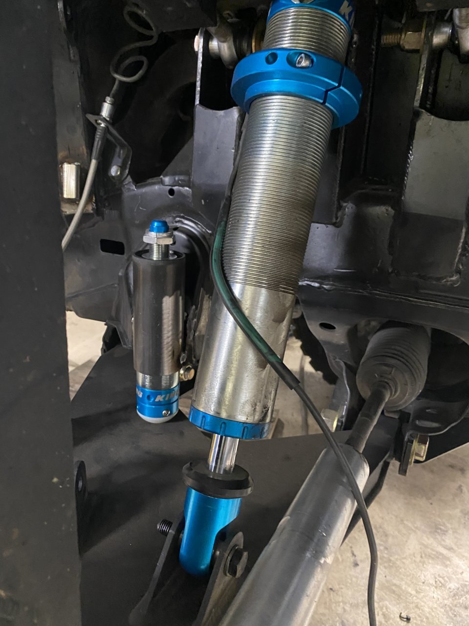

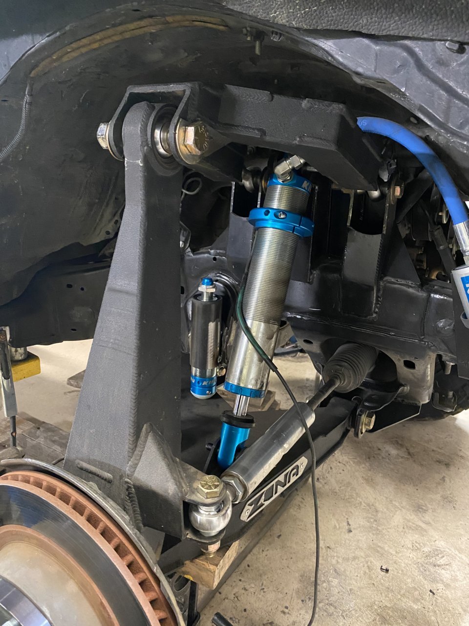

    Getting the bump stops set. 1.5" of shaft will be showing on the coilovers/bypasses at full bump.

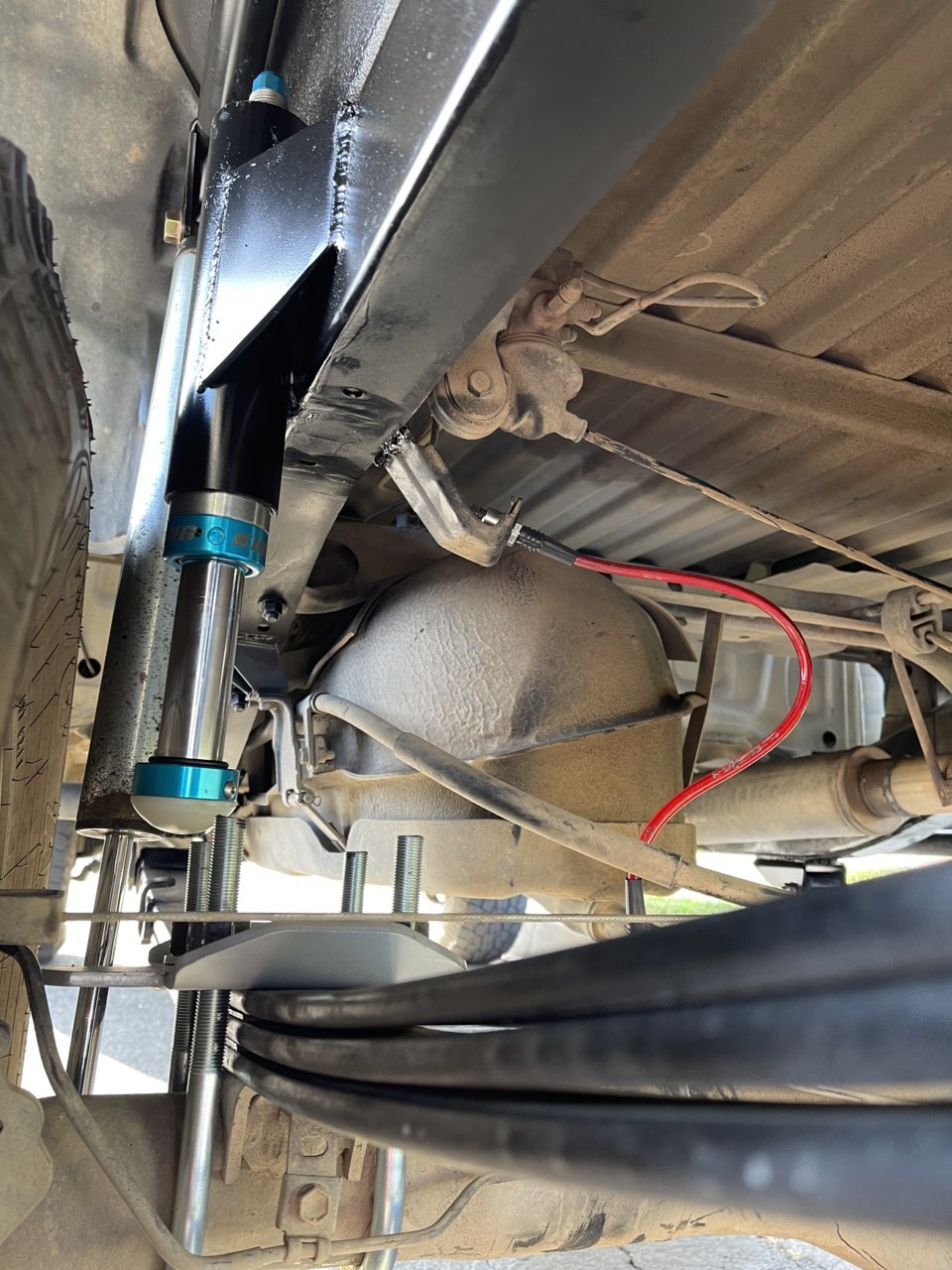

    Anybody have experience with any of the 3rd gen bolt on rear air bump mount kits? Just looking to see if any one is better than another, or all about the same.
    I can see the TC and Camburg have mount kits available, probably more that I could not find easily.
    Setup is/will be J66, Hammer hangers / Fox 2.0 bumps etc. Essentially making an Accutune 1A long travel rear kit with parts I have already accumulated, though I would still consider this to be mid travel since its still SOA

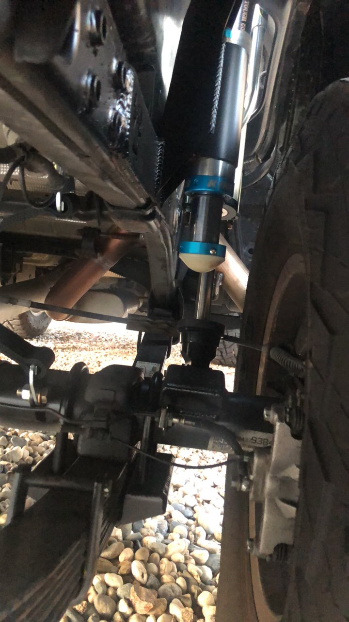

  18. Nov 13, 2021 at 5:21 PM
    #118
    anthony250f
    anthony250f Well-Known Member
    Feb 18, 2012
    #73066
    16,739
    Anthony
    San Diego, CA
    2008 dcsb trd offroad 4wd
    Do you trust that bump stop pad
    I wouldn’t
  19. Nov 13, 2021 at 5:30 PM
    #119
    Allex95
    Allex95 Well-Known Member
    Apr 6, 2020
    #324011
    1,380
    allex
    96 Tacoma 4x4 2.7l 4 cylinder
    How else would I do it.. I mean it’s welded on it’s thick enough I would think I’ve hit hard
  20. Nov 13, 2021 at 5:39 PM
    #120
    Redbeardfifty
    Redbeardfifty Well-Known Member
    Jun 3, 2020
    #330327
    289
    That bump pad is going to bend.
    You should cut the pad off, then weld a permanent pad box, with a cross or at least a single cross (so a box with at least one line of an “X” in the center) and then the pad needs to be the same height as your leaf pack too bracket.
    because when you hit the bump at any sort of flex that bump will be hitting the top of the leaf brackets.
    but yea. That pad is going to bend. I’ll find a friends who used thicker metal and it didn’t stick out as far as you and it bent on a simple fire road
