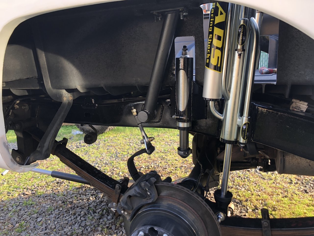

    ADS bumps. I really appreciate their can design. They’re made like King cans, but with a clamp on the bottom. Makes life a lot easier.1E8743AB-0AB8-4F94-B6CF-F5E2D798A3C7.jpg 8A976950-02F1-4D8C-9E2C-667C446A1C1E.jpg

    Do you really need to strap it?

    Absolutely. What made you ask?

    I don’t know I’m curious cause I’m wondering why. What’s the travel numbers?

    On a spring under axle application the shocks will be the limiting factor in droop as opposed to the springs like in the SOA applications where you don’t often see straps.

    A couple reasons, the full weight/momentum of the rear would damage the shocks and to avoid leaf separation and the shackle breaking the hanger.
    It’s a DMZ SUA, strapped and bumped slightly over 17” like most.

    So your running a 17” shock

    16s, they are set up to be vertical at full droop and and around 7 degrees compressed if I remember correctly.

    Curious how could it run 17 inches of travel on a 16inch shock?

    The greater the angle the shock is placed at, the more exaggerated the wheel travel will be relative to shaft travel.
    I forget the formula and it only loosely works with a leaf pack, but it’s a relationship between the shock angle, travel and sin.
    I think at 7 degrees it’s an extra 2” of travel, but like I mentioned, the arc that the shackle moves in, and the shortening of the leaf pack has the shock perpendicular to the frame at full droop, so that sin calculation is diminishing while moving from full compression to full droop.
    I’ll have to look in my notes for the formula unless someone smart chimes in.
    edit: degrees sin x shock travel (if I have it right) 1.95” in this case.

    The shock's at an angle.
