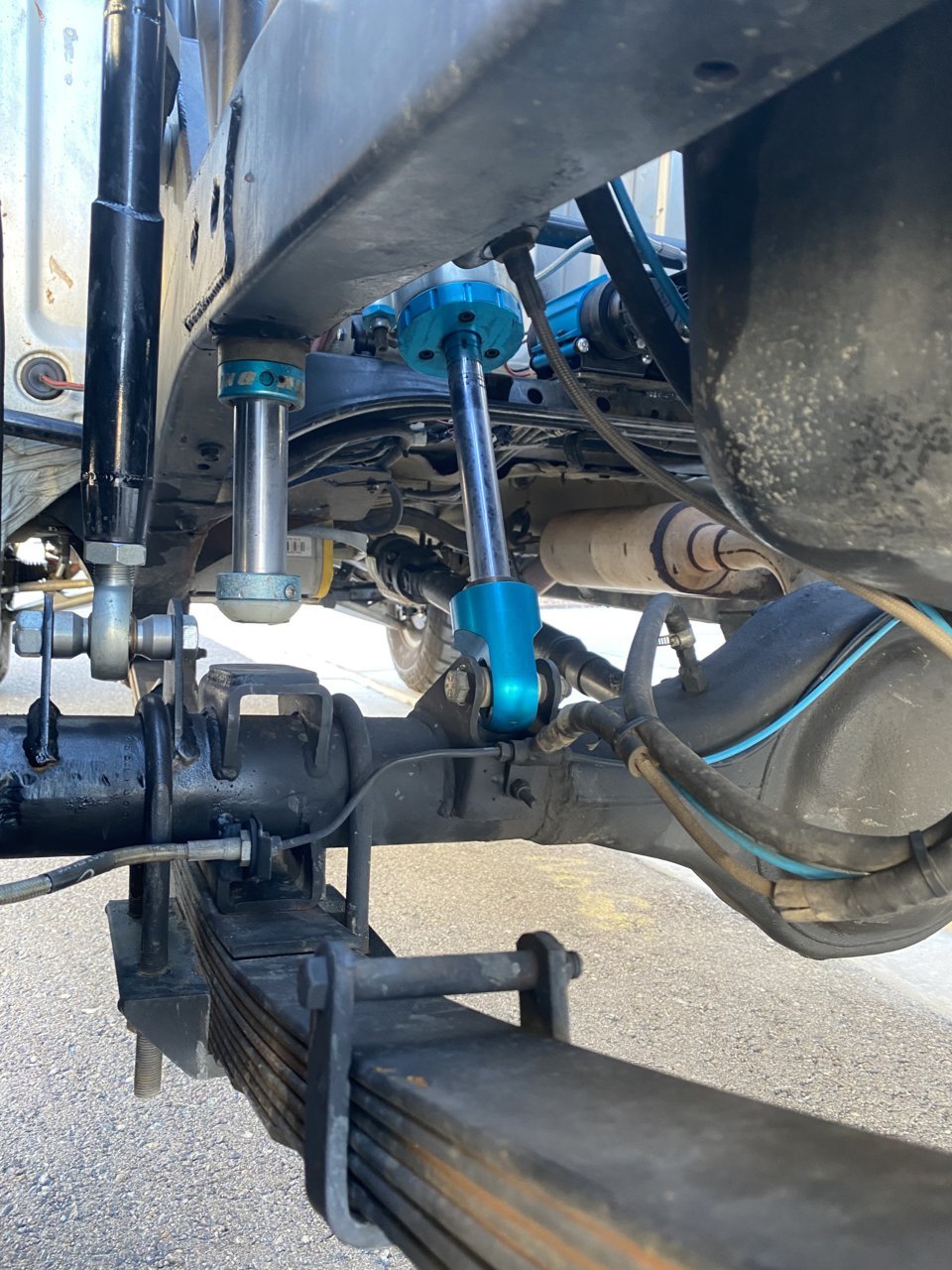

    I only have hydraulic bump stops on my rear end and I don't really have a problem bottoming my front out.

    Nice. You could put a spacer on those bumps to keep them to 2" stroke and have an easier time tuning since there's only about 2 inches before you hit them. What leaf springs you running?

    Thanks... no, I've owned the truck since late 2004 and did the rear long travel maybe around 2010? I feel like I've replaced the leaf pack at least once since originally having the 62" but not sure. I'm guessing that would be an issue for just about any extended length spring pack that was also trying to keep from being too stiff, no? Maybe it is just the price to pay (replace the pack every so many years)?
    When you guys say put spacers on the bump stops is that to pull them up a bit so that they would touch down later?

    Correct. Those are likely 4" travel bumps (or longer?), when you likely only need 2" travel. Those air bumps can be opened up and add a spacer to reduce the overall travel. Of course you should def measure things to make sure they will still hit first. In general we recommend your air bump travel should be 1/3 of your up travel. Once they are set properly you can adjust nitrogen level to meet your needs. Those bypasses should be doing most of the work

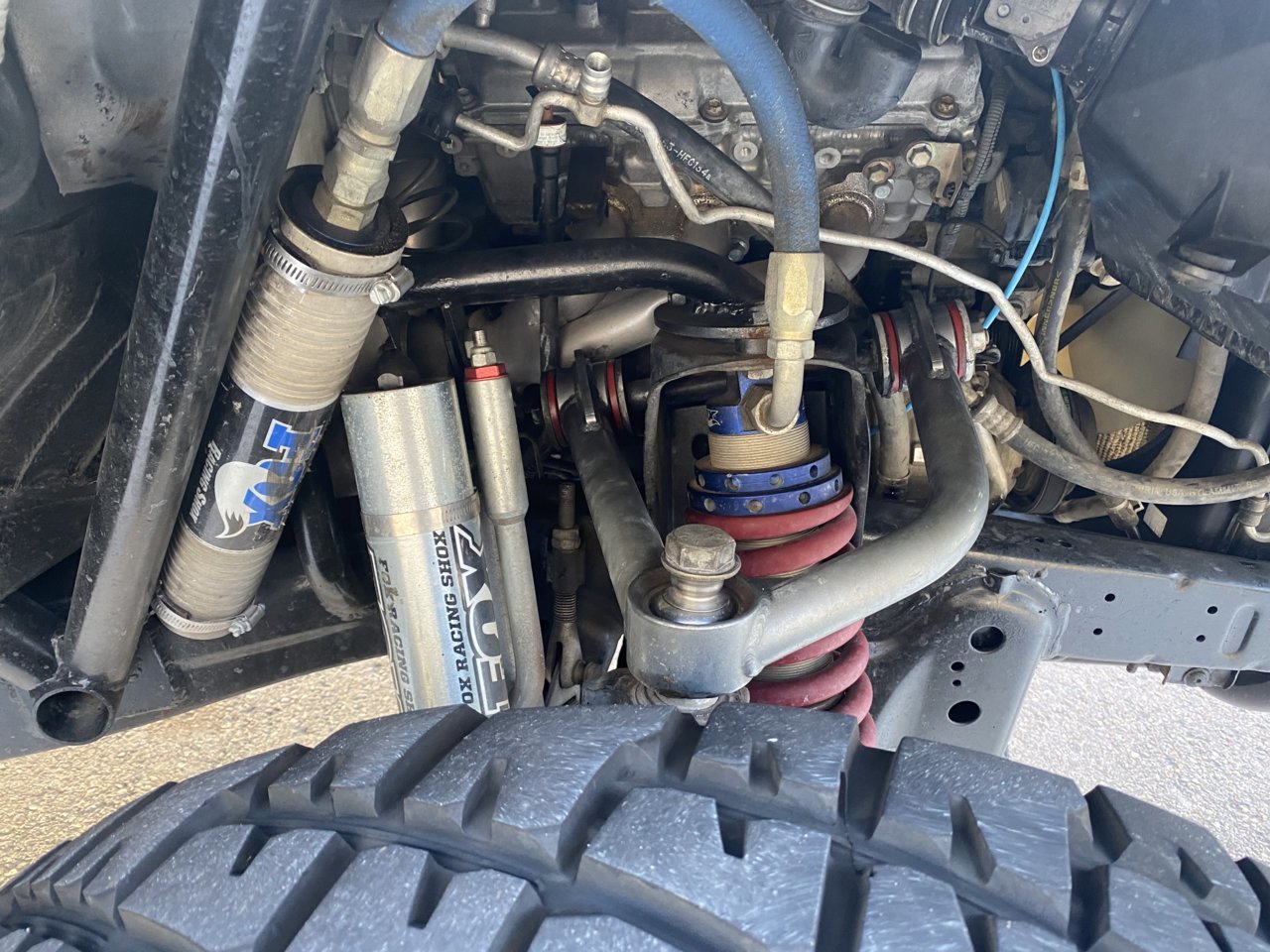

    Only pic I have, but threw in some 2.5" travel air bumps about a month ago. Dig the improvement over the superbumps, as I would compress them so much that they would start folding over/didnt have a reliable stop. Also another benefit is having the bumps out on the frame instead of inline with the frame, which makes bump at flex more relative to the vertical bump travel as the bumps are almost inline with the shock plane. Running 110 psi, which is just enough to keep the bump from bottoming at full flex/very hard hits. Might shorten them to 1.75"/2" someday just so I don't hear them on the street.

    I would have though the bump stop in line with the frame would be stronger. Can the side mounted bump twist the frame? or is the frame gusseted in the mounting location to prevent and frame issues?

    It can, but I plated the frame and added in another crossmember where the bumps mount.
