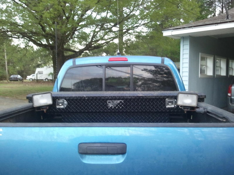

    Two lights bolted into the rail system in the back. They were originally on a Case IH cotton picker, so I just used the original brackets and wiring harnesses from the factory. The illuminated rocker switch in the cab is also from the cotton picker - it actually fit right into the blank perfectly.

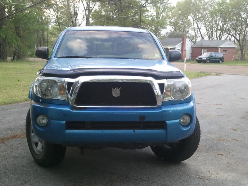

    Ignore the bumper issues - had to replace it and the body shop failed to use an adhesion promoter before painting it. I haven't had time to get it repainted yet, but will in the next week or so. Just used that shot to show the "satoshi" grill. after I did the dremel/epoxy work I put 6 coats of black on the plastic and expanded metal, then painted the aluminum sides of the radiator black to hide it. I also moved the horns to a different location so they wouldn't be visible. The truck is also now a Decepticon. Not sure how many of those are around, so that's my uniqueness.

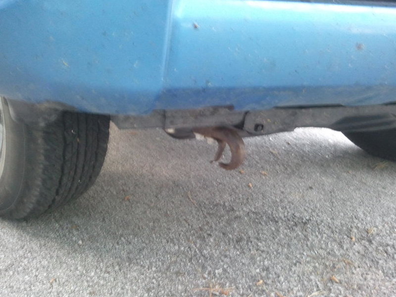

    The tow hook you see is probably one of my favorite things I've done to my truck. Why? My dad had a Toyota pickup in the mid 90's- probably 1995- and it burned completely. He managed to save a few random things like the tow hook, etc., and I came across it in our shop about a week ago. Turns out the bolt holes match up from a ~1995 to a 2010. It's a much larger hook and also has a spring to help prevent chain from slipping out.

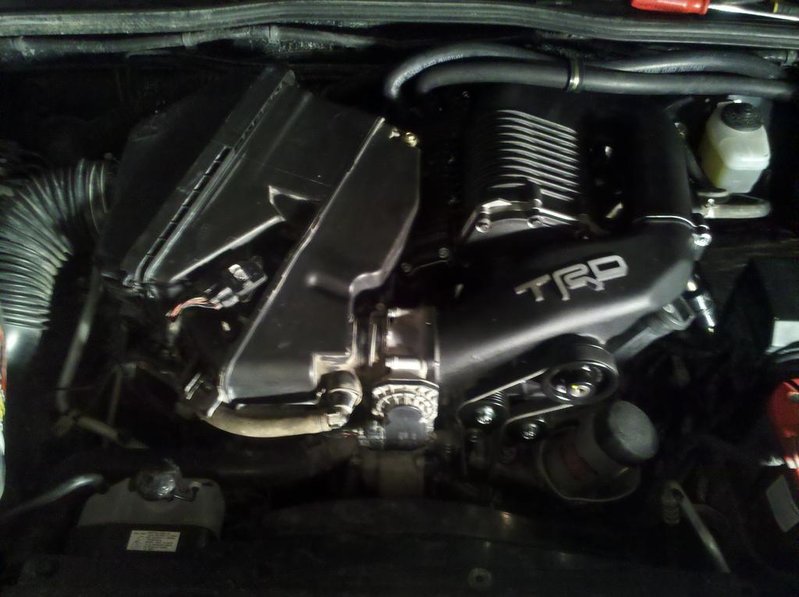

    My supercharger I installed...I would say its unique cause not alot of peeps here have one :D CAI and exhaust coming soon

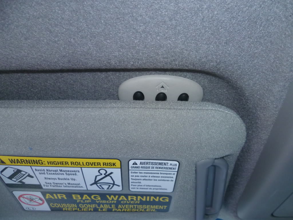

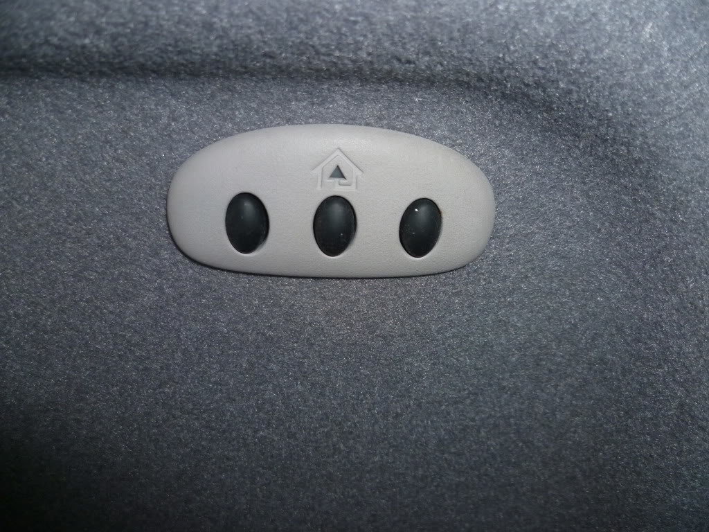

    Hidden homelink
    Some more coming

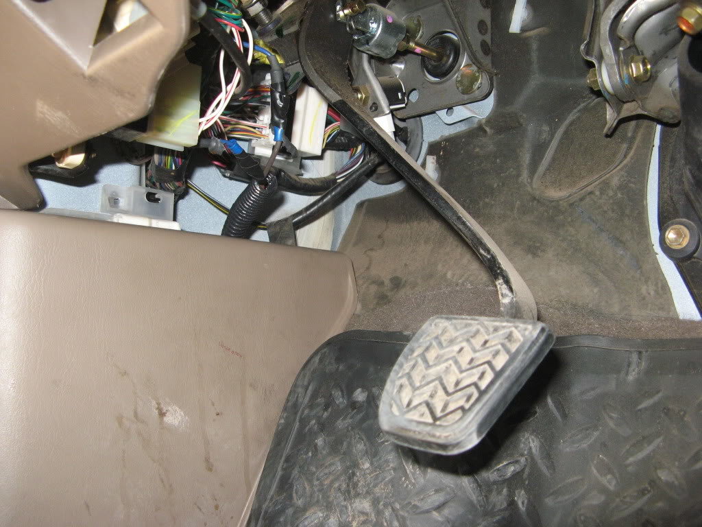

    fuel pump kill switch, not saying where it is though:D
    I spliced in a toggle switch on the blue wire.

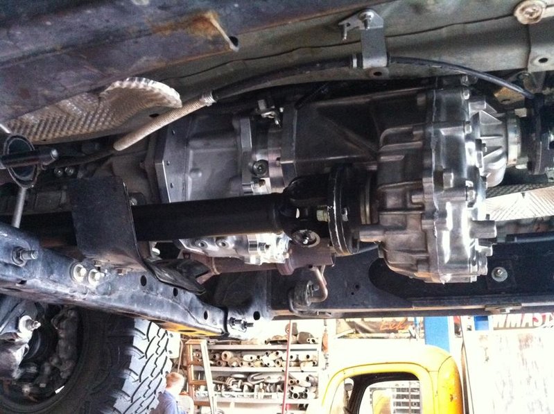

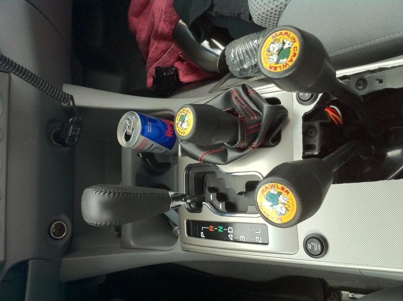

    Just put in an ATO rear high clearance bumper and FJ twin stick t-case with Marlin crawl box with RST
    Video of crawl box: http://www.youtube.com/watch?v=xNmZvmP46UY
    A few pics of the bumper and box (I am cleaning up the shifters - adding shift boots soon) Oh ya and seat warmers :) switches on the center console...

    i like that bumper

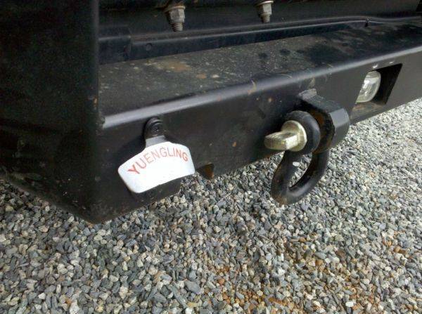

    I'm lov'n the Yuengling mod. Did the tour and got a jacket while there. Didn't think of the mod tho. Nice work.:D
