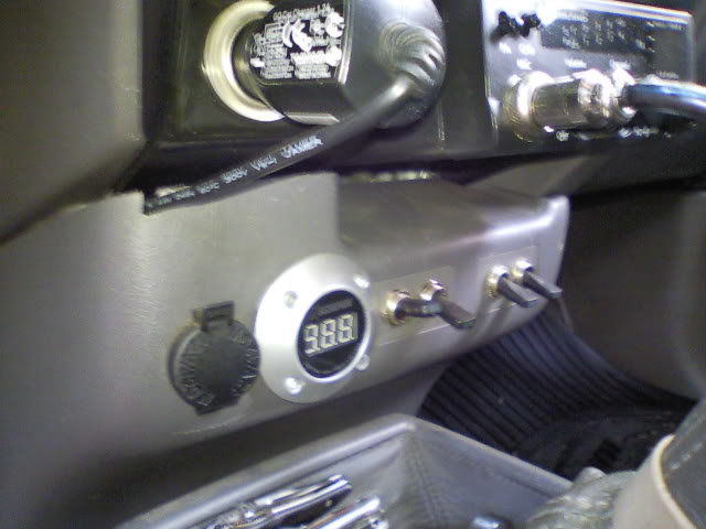

    I dont really know how uniqe this is but my switch setup and voltage meter, havent seen anyone put their switches like this int he 1st gen.

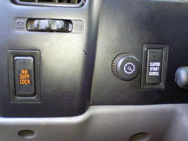

    & i relocated the RR Diff and Clutch Start Cancel buttons cause i use the Diff button more and toyota had it cramed back behind the steering wheel tilt lever, its much better right here!

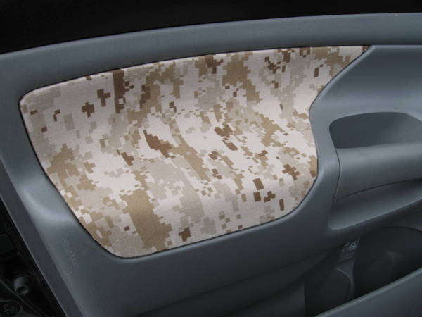

    My arm rest mod looks good but need to be worked on again.

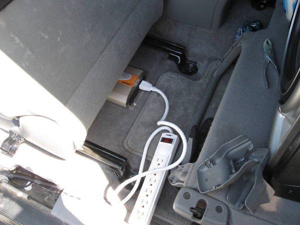

    1000 WATT inverter with power strip, the power strip really came in handy on a three day trip. we charged my phone, my camera, my video camera. Charged my buddies camera, his IPOD, his cell phone and used my pump to inflate my blow up mattress.

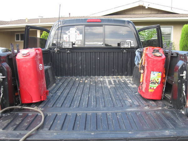

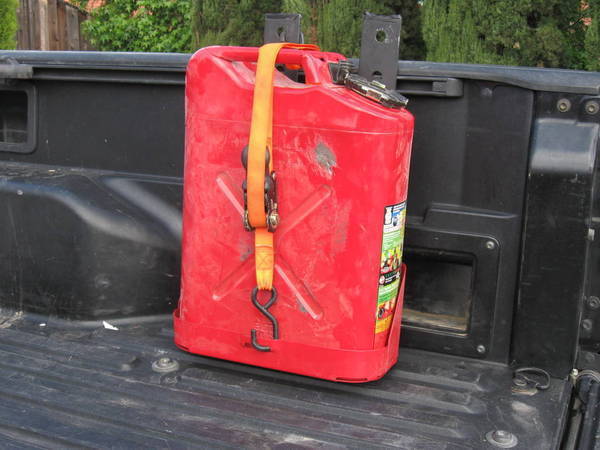

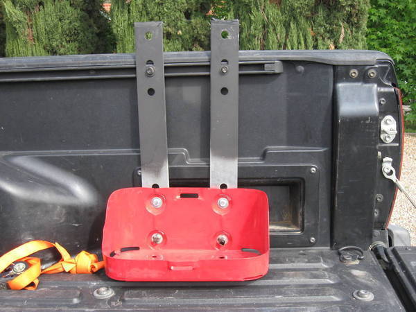

    and my fuel cans attatched to the rail system.

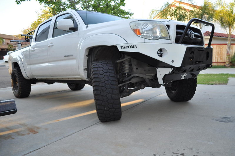

    My bumper

    Front view? That half white thing looks weird from that angle.

    Ha! You're right....

    ^ I like it. How did you match it?

    The white?? Autozone had it in rattle can...I did gray primer on the bare steel first. For the black, I did black primer and then Matte black enamel...Clearcoated the whole thing....Shaved down the PIAA guards to squeeze them into the holes.

    Front angle looks good. Maybe some further away shots? Either which way, I like it for originality :thumbsup:

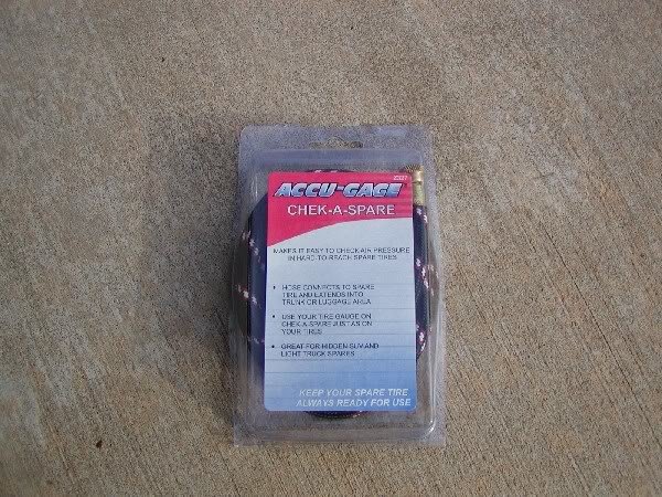

    Posted this on TN a few years back.
    This allows you check the psi in your spare and add air if necessary without getting under the truck.
    Not a big deal, but cheap, easy, and works.
    These are available commercially:
    http://www.amazon.com/Accu-gage-Chek-Spare-Valve-Extender/dp/B0006O2S8M

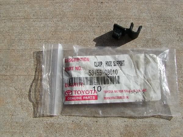

    My idea was to add this:
    Any one will work. There are a lot of different ones for different cars.
    There are some holes in the bumper where you can mount it easily.
    Invisible from outside the truck, but just reach under, unhook, and air up.

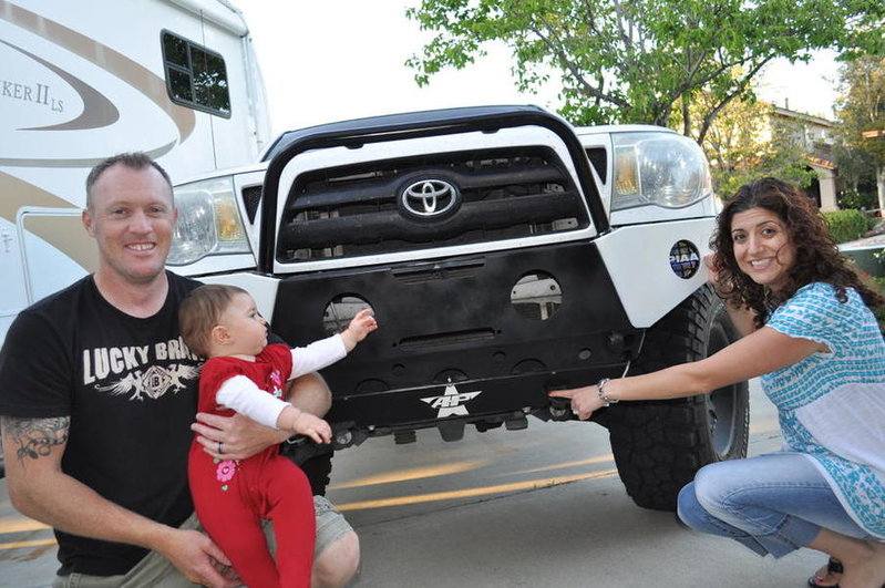

    ...How's this? [​IMG]

    Great idea. I was thinking about doing something like this, now I know what parts to get. How long have you had this hooked up, and are there any rot issues with the hose?

    Thanks guys.
    These pics are from about 4yr ago. It's dirtier under there now, but still works like a charm. No issues so far.

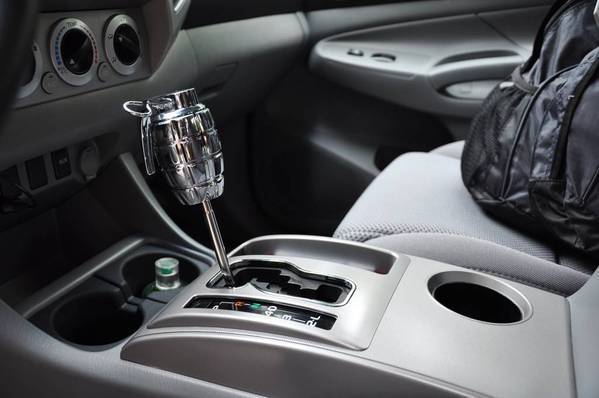

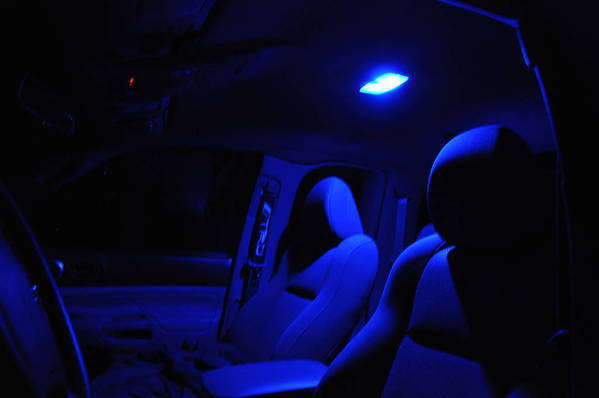

    Check out my Build to See!
    Blue LEDS
    And Shifter knob

    Is that the cup holder that comes in the 2011. I would like to throw that in the 2009.
