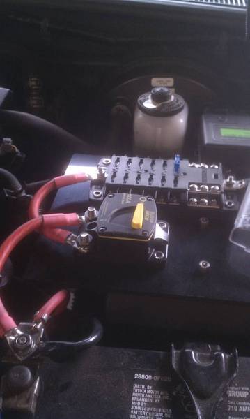

    My Blue Sea panel mount.

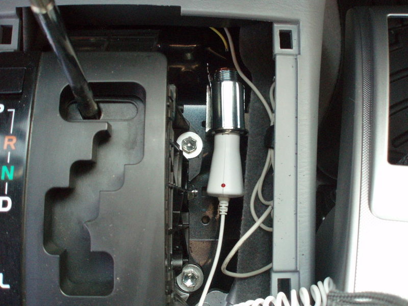

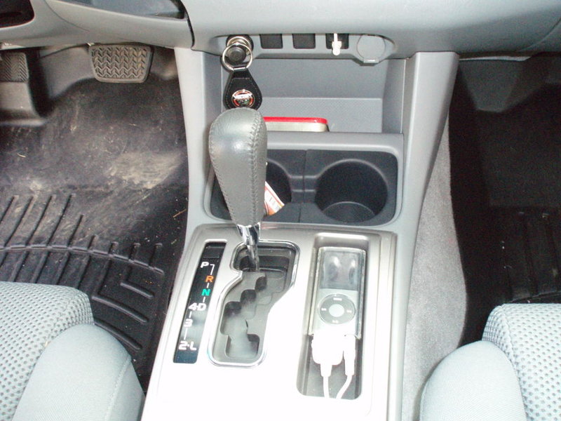

    Well, since I don't have the funds for the nav head unit I want yet, and hate cables strung around, I added a 12v power source in my console and hid the wires for a nice clean ipod install. I drilled a hole directly above the aux jack so I could run the cable through, and pulled the dash apart so I could wire a cig. lighter type ( $6 at the auto parts store) 12v power source in, jumped off the factory one. Finally, I dremmeled a hole in the console, which gets hiden by the little mat, so the cables could be run through. I can leave the ipod out for access, or pull up the mat and put it over the ipod and cables for stealth mode. The only additional thing I'd like to do is swap both cables for black ones, to make them less noticeable. When I finally get an aftermarket H/U, I can pull all the cables out and have none of the holes I made be visable.

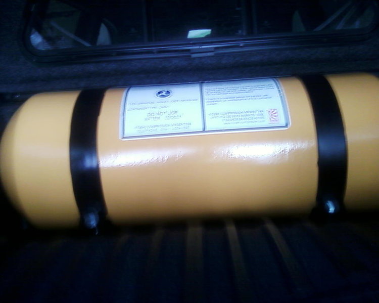

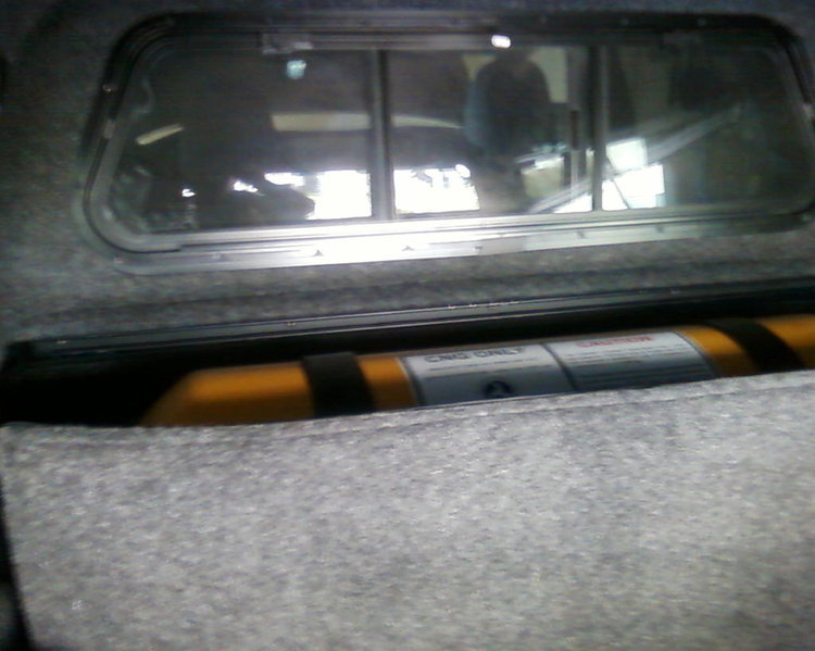

    Only one i know of running CNG:)

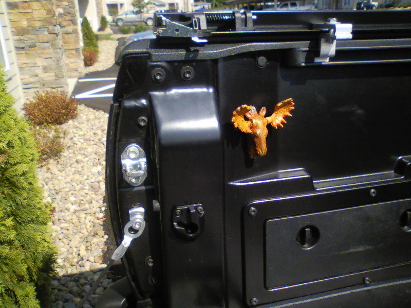

    Moose bottle opener in the bed
