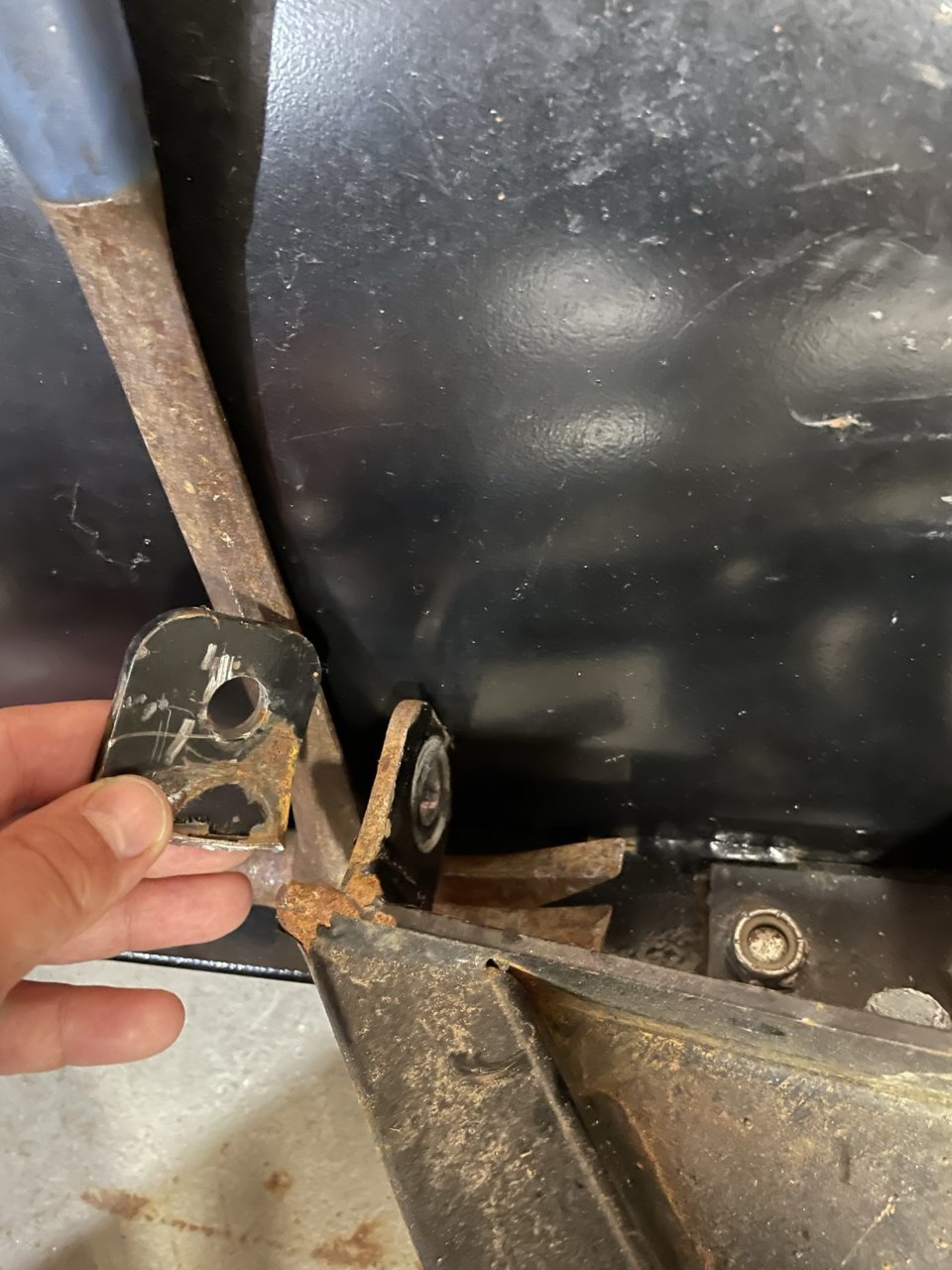

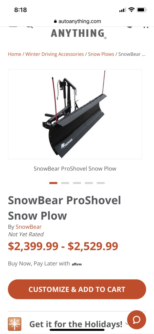

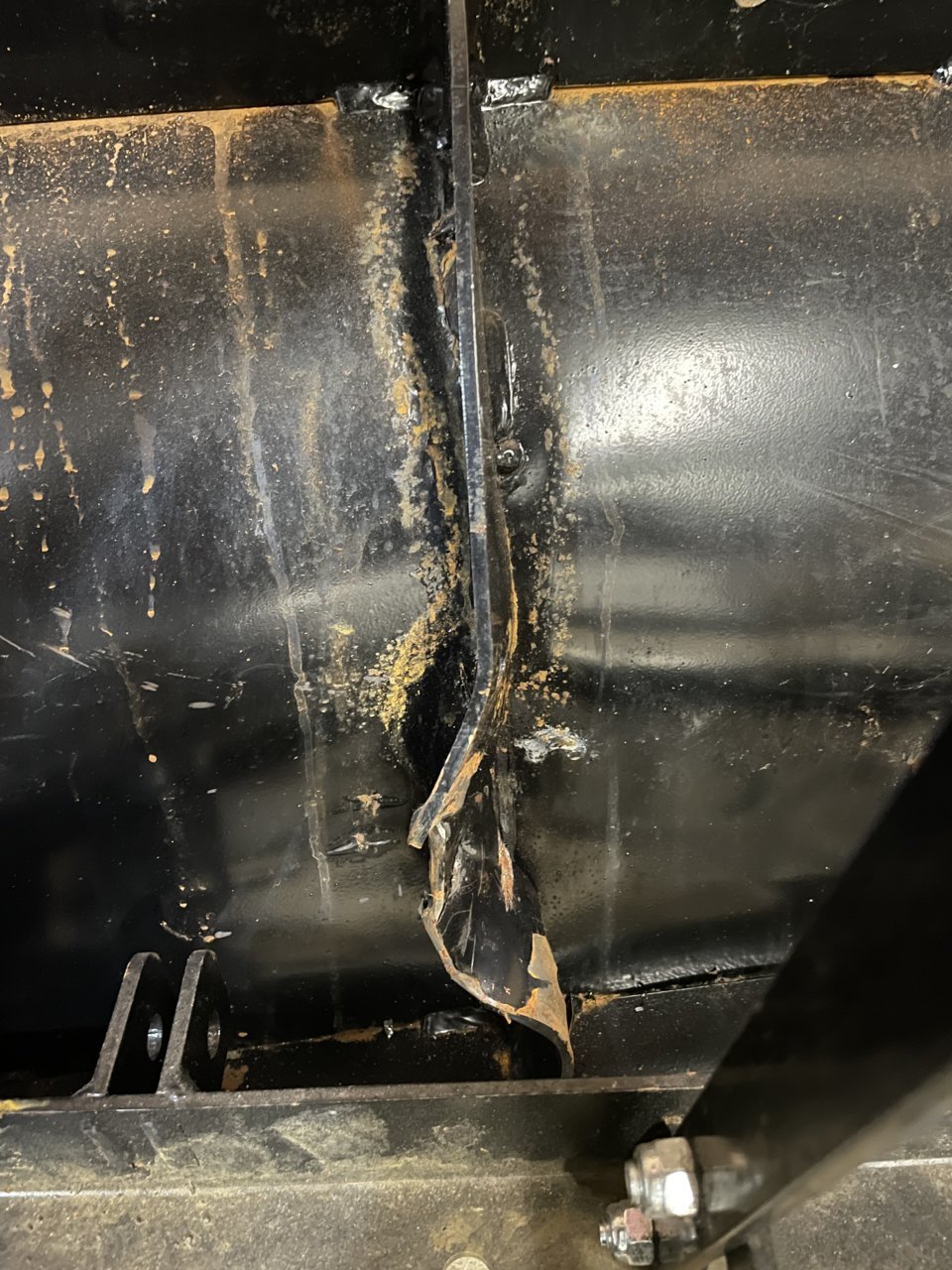

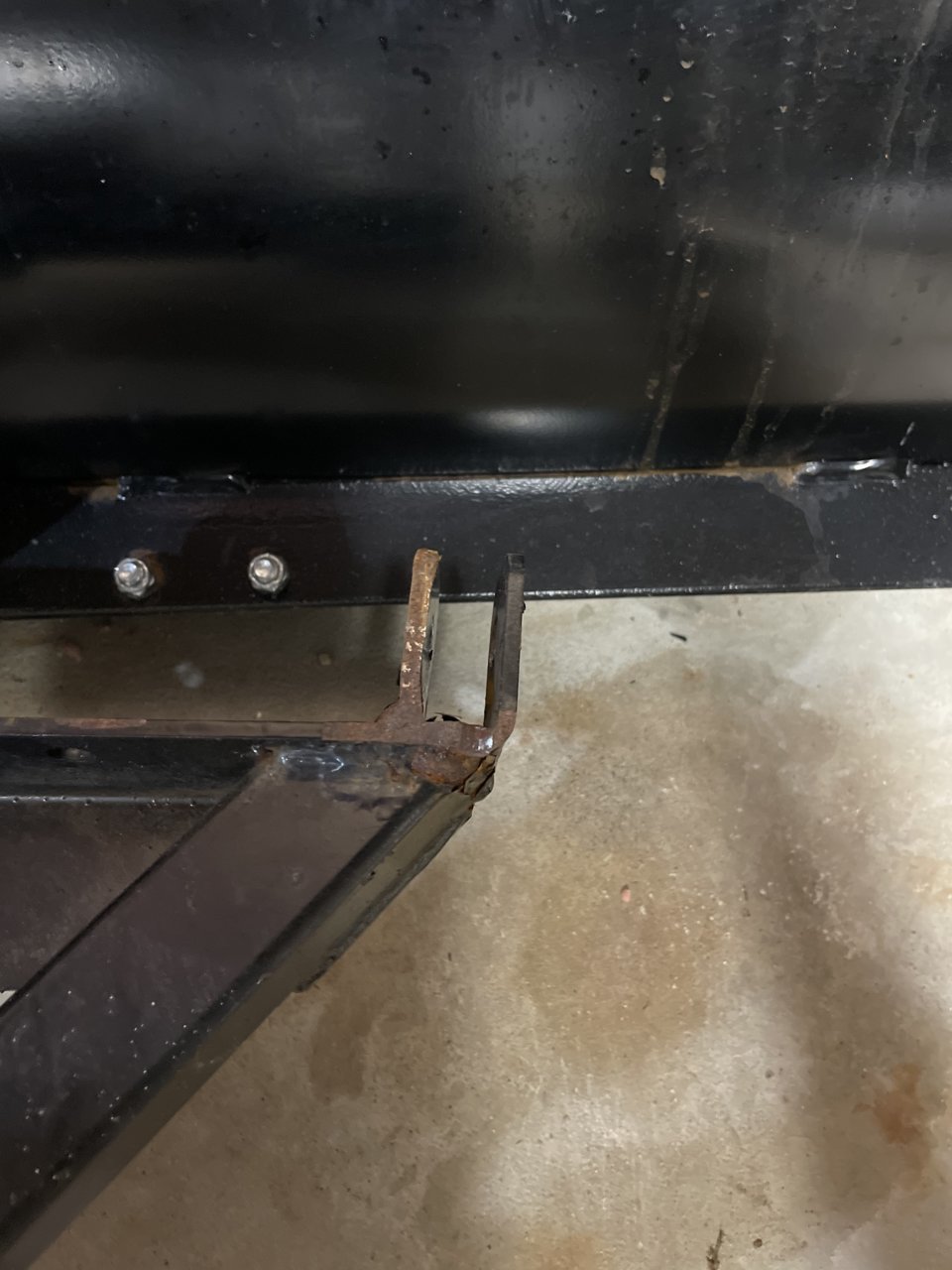

    I got the snowbear with electric actuator up/down. Came with Wireless or wired controller.
    If you can afford it go with a fisher or something more heavy duty. It got bent up after only 2 plows. I just kept running it while arguing with snowbear to cover it under their warranty. They refused. By the end of the winter it was barely hanging on for dear life. Brought it to my buddy this fall and he welded up some new supports and added some welds to strengthen it. Works better than new now. It does the job, but if I could go back in time I would spend more on a better one. A8E9735B-4B32-429F-9C92-446E0A5A5B9F.jpg5B0835C1-C1A7-437A-BAA0-9E4458B8AD12.jpg CA8D8886-9ACD-468E-A7D6-27FCD43A8076.jpg4B6735C6-75D7-454E-9950-1F9A4A5B514E.jpg

    It also is front hitch mounted so I had to buy that also. When I bought the plow, it was around $1700-1800. Now it’s way more. And I personally don’t think the quality is worth the new price. 96EC7629-C96F-4CE3-8462-A073E87B5D87.jpg

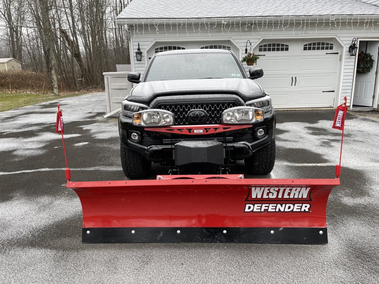

    I'm ready for the snow.. So far the plow is sitting on the side of my garage..

    Looking good! How much did that set up run you?

    I was going to do a front hitch setup but after getting one, Meyer Home Plow, and it was defective. Then taking 2.5 weeks to get it shipped back which was hell in itself. Then the lack of any available Meyer Home Plows at all I decided to go with a real plow setup. Local company here had on in stock and arranged to have it installed with in a week. That was the beginning of December. As for cost around 5K for the plow and installation.

    Can't really say how good or bad the Meyer plow would have been. I never had the chance to use it. One thing about it it was only hydraulic up and down. The Angle of the plow was determined on how much snow was on one side. It would auto angle.. You could have pinned it at the angle but if you wanted to plow straight you would have to get out of the truck and remove the pin.
    This plow is full hydraulic. 4.1K for just the plow assembly. Install was 675. Then of course there is the state tax on top of that..

    Twins! Just picked this thing up off craigslist. How do you like it?

    So far so good. I like the idea of moving snow from the comfort of my warm truck listening to XM tunes...

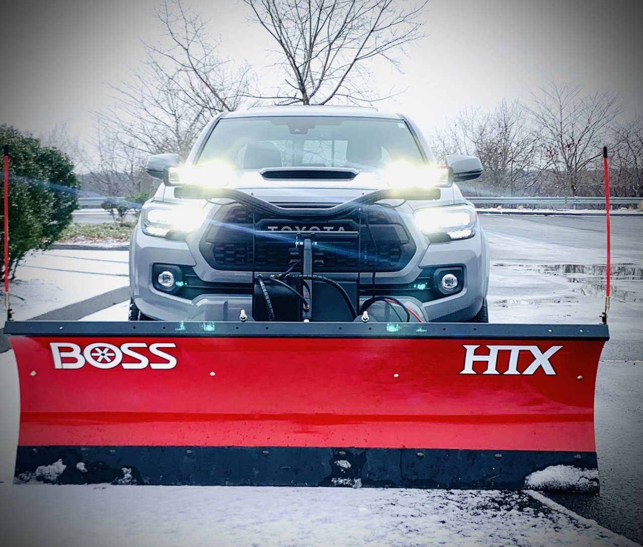

    I added Timbrens on all 4 corners to help with loaded ride manners, as well as 5100’s and SS brake lines. Same mods I ran on my 09 OR with a plow and it worked out great.
    Only issue is retaining factory stalk control for hi/low beam selection with factory LED setup. BOSS either doesn’t have an adaptor available, or its backordered .
    Currently I have to use a separate 3 way toggle switch to change hi/low beam on the plow which is a pain. Waiting to hear back from BOSS to see if there is a fix yet .
    I had wanted the Poly 7’ blade, but at the time there was a 4 month back order, so I have 7’6” steel. The added weight makes turning wheel a little ‘draggy’ when pulling out of a parking space. Once moving, that resistance begins to go away, and is completely unnoticeable at 5mph+.
    Edit: Update. After plowing 9+ inches of dry, powdery snow in this weekend’s Nor’easter, Im happy to report this setup worked beautifully. Zero issues with the BOSS and the Tacoma . 24 driveways and not one hiccup.

    HTX is a breeze to mount/dismount. One finger to flip a switch as the plow is self powered.. Just need to line up correctly, the unit does the rest. It takes more effort to bend down and plug the harnesses together. Level/flat ground is key.
