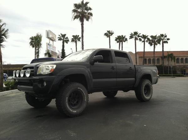

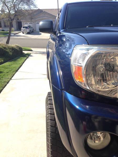

    Finally installed Camburg spindles... Couldn't be happier!

    Your truck looks good man! I was about to pull the trigger on the Maxtrac spindles but I stumbled upon a good deal on these Camburgs from a local member. Just need to figure out what the next mod will be

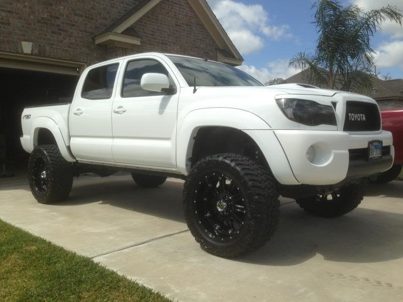

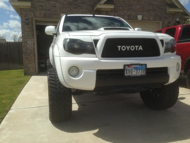

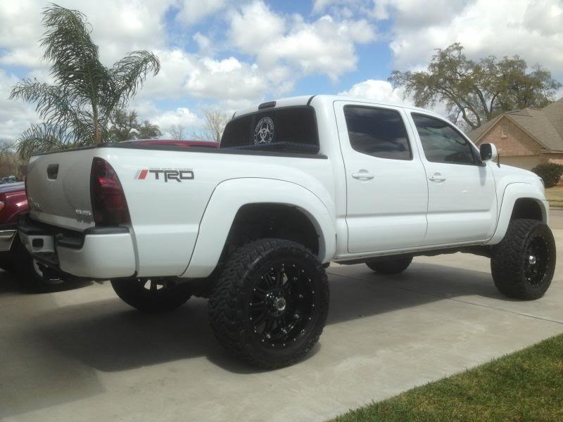

    I've got the Maxtrac spindles with the front bilstiens set at 0.85 and extended bilstiens in the rear with 3" blocks. Just a hardcore concrete cowboy! :D
    I love how wide the stance is now! Since the spindles kicked out the front wheels almost an inch, I installed 1.25" spidertraxx spacers in the rear to even it out a little.

    chris duby,
    Looks nice!! What is your backspacing and offset of your wheels?

    Thanks! :D

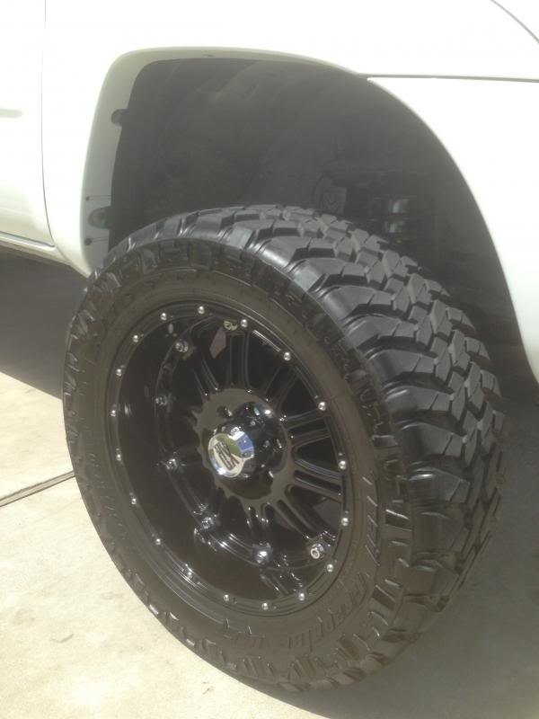

    4.5" backspacing... They already stuck out before the spindles but now it's almost a third of the tire that is past the fenders.

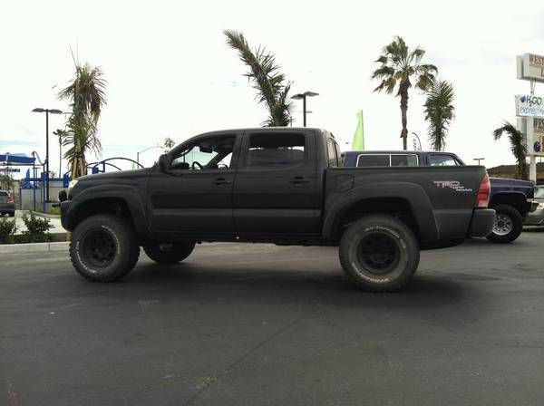

    i couldve sworn i posted in here already..guess not :cool:
    4" maxtrac spindles
    5100s at 1.75"
    Eibach 1.6" lift springs
    4 leaf tsb springs
    1.5" aal
    2" block
    extended lines all the way around
    35x12.50x17 Nitto Trail grapplers
    Im about 1.5" low in the rear right now
    Alcans are coming very soon to replace all that crap in the rear

    Is that with a -12mm backspacing?

    4.5" backspacing is the same as -12mm offset... it's what is recommended when going to aftermarket wheels.

    Its not the same..backspace and offset are different..However most wheels that are 9" wide have a backspace of 4.5" which is the center of the wheel..and a -12mm offset...which is how much metal goes past the center...-12mm means it is thicker on the inside which causes it to stick out more +12 would pull it in...

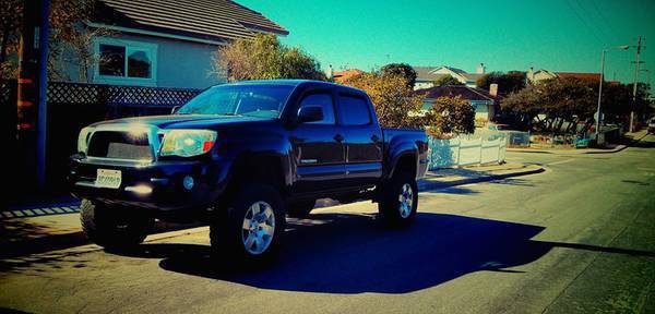

    Here is my setup
    Front: Maxtrac spindles, 5100's with OME 883 coils
    Rear: 2'' Toytec AAL 1.5'' block with extend length 5100's

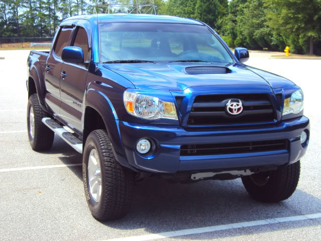

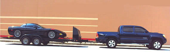

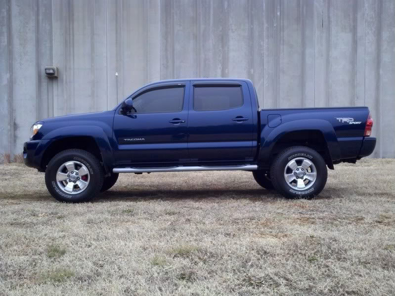

    bump.. I have 3" lift with front 5100 set to max with stock springs and LR Upper control arms. Rear is 5150 I think with a AAL. 1.25 spidertrax spacers.
    Im wanting to get the 4" Maxtrac spindles and a 3" leafpack for the rear.
    im bumping for more pics of others setups to help me on this decision.
    Here is my truck.. Not as cool or lifted as all the others guys in this thread.. but looking to be soon.
