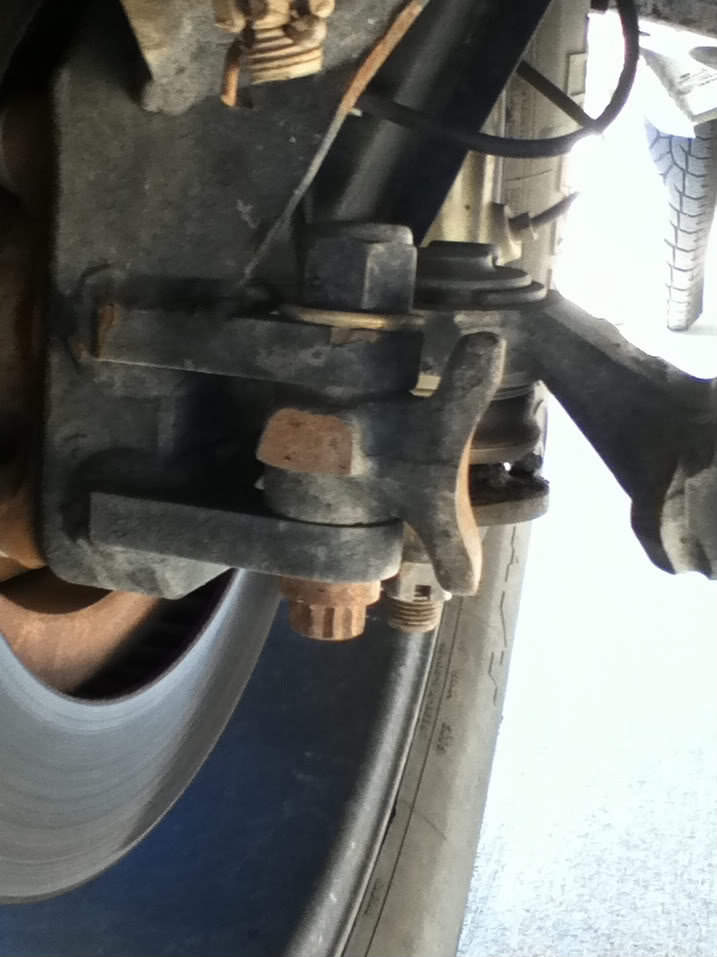

    I'm curious... does anyone have a camburg spindle that's single shear where it mounts to the lower ball joint. In other words do the two big 12 point bolts down there by your lower control that holds the spindle to the toyota ball joint, do they pass through three layers of metal or just two? My spindle has tabs on top, and on the bottom of the ball joint bracket. But I've seen versions with only one tab coming of the spindle.

    One only on mine.

    mine are only single sheared. the original allieds were double sheared. i could have sworn at least the first run of the OEM ones were double sheared. i was told by camburg that all the OEM replacement spindles are single sheared, whereas the LT version is double sheared. hope that helps

    I wonder if I have a long travel spindle? Does it matter?

    Long travel spindles do not have holes for your sway bar. Easy way to tell.

    i have lt spindles with single shear :confused:

    Really? I need to check mine.

    camburgs are single sheared tc's are doubled

    Ok. Just looked. Mine are single.
