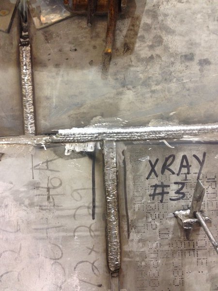

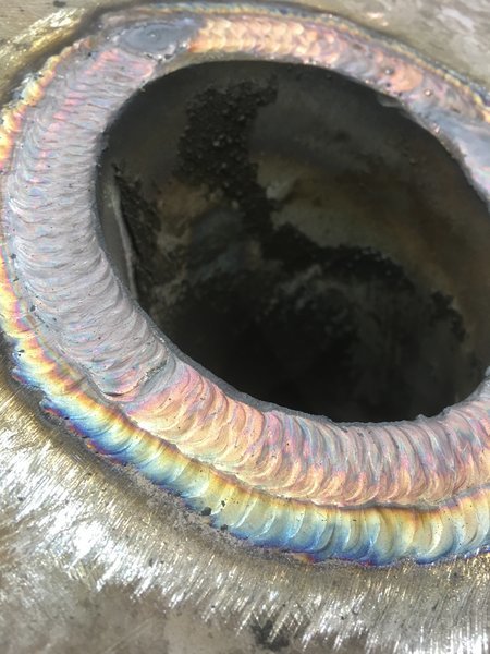

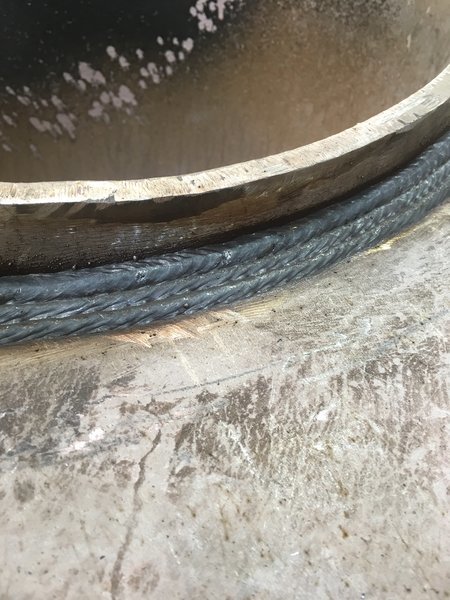

    image.jpg image.jpg image.jpg 2209 T-joint x Ray. Horizontal was 12 passes on the outside.

    No jumbo and 5/32 for cap? Makes it a little quicker for me personally

    Nope Just a #8 and 1/8 is all I had to work with.

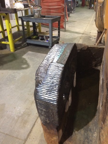

    Little repair work... 1/16" E801-S flux core. Roughly 30 hours of weld time to rebuild hoist trunnion on an 88 yard Esco bucket.image.jpg

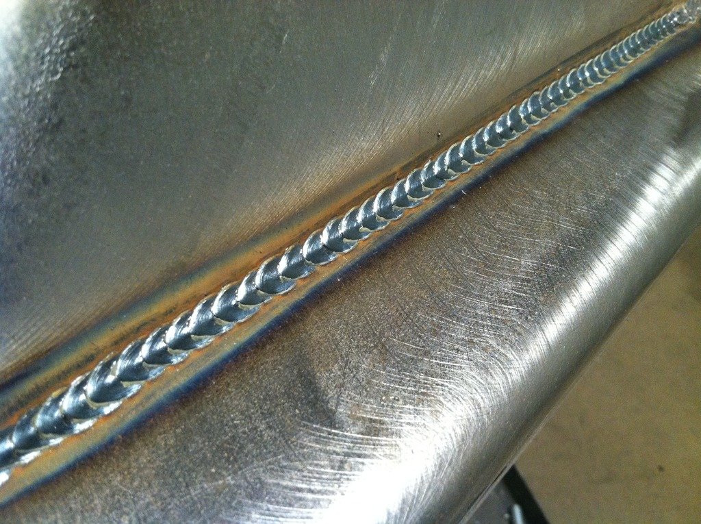

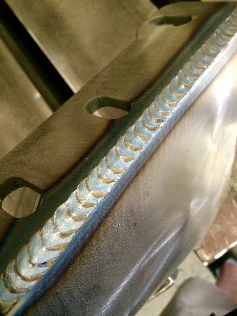

    Lots of nice welds in this thread!
    Couple of mine
    .035 w/ 100% C02
    E1E7D976-436A-42C3-BFB3-D4A5E47543EB_zps_d3c3cba8dbe10669b0f0258b6a5cafb1ddb51b1f.jpg

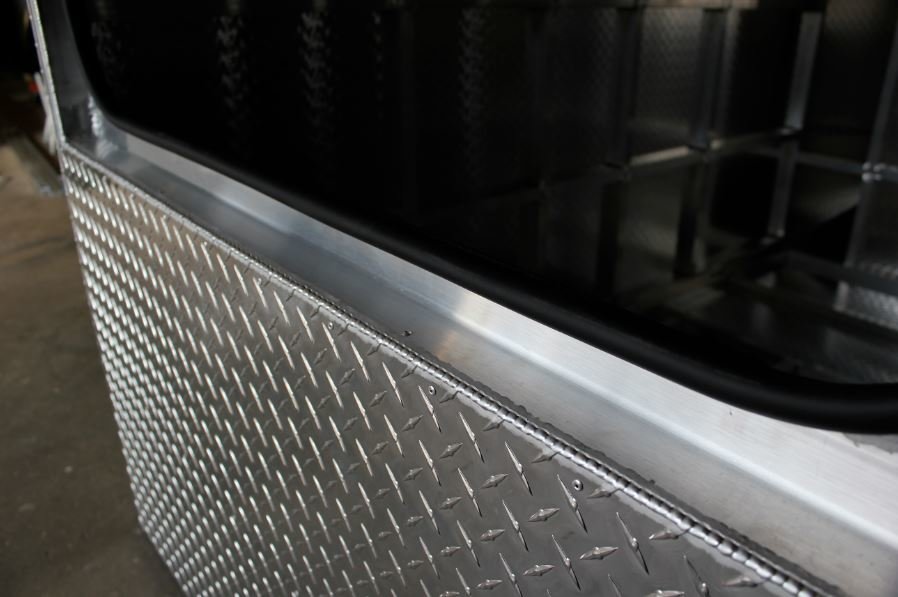

    A256573F-916D-439D-BF77-D7B763AD31BE_zps_f5789005106c10f44d6779e34b4a573e632bb1fa.jpg

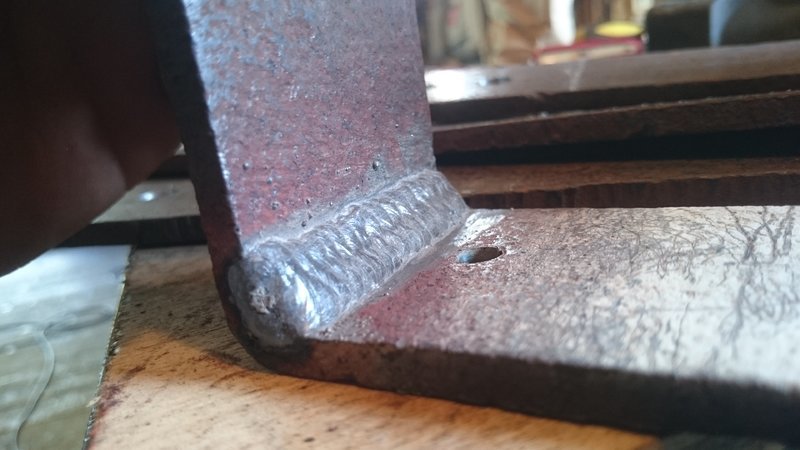

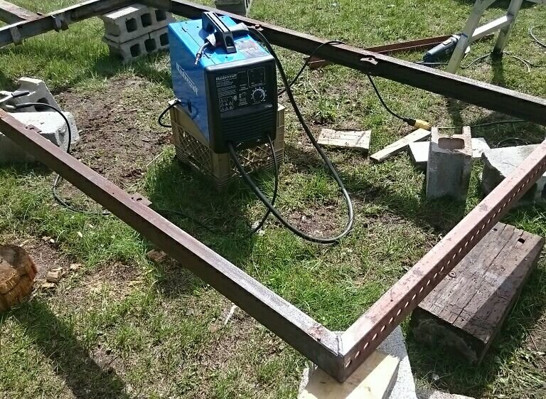

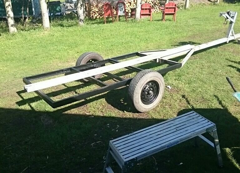

    I have fun with my $170 mastercraft welder maxed out with 0.8 nr-211 fcaw-s. Ive since became a certified welder and looking to find myself an engine drive rig.

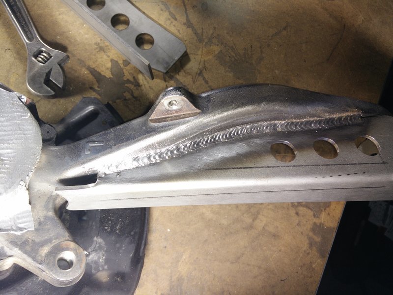

    Welded some spindle gussets!

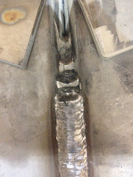

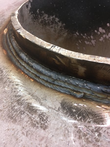

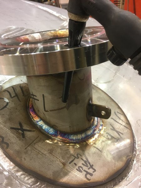

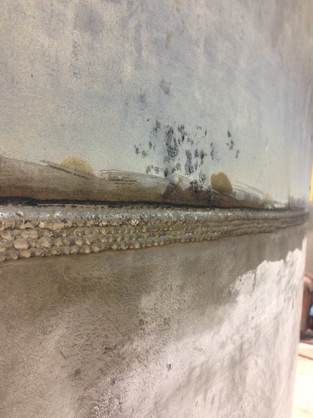

    15 passes to fill bevel, 3 pass cap. 308H (hardware) pulsed. 100%xray. IMG_7561.jpg IMG_7560.jpg

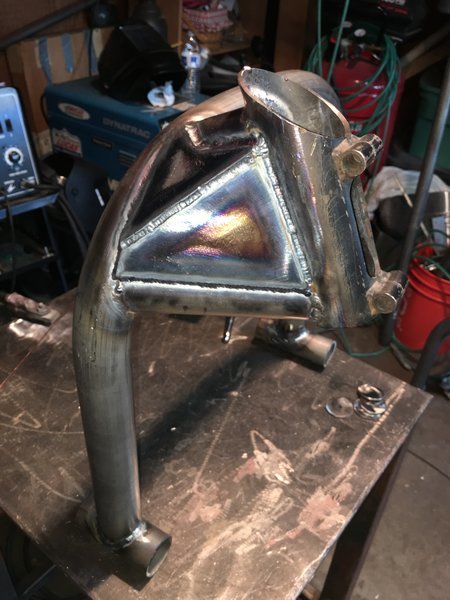

    Fabbed up some shock hoops and bump mounts for a buddy with a rangerIMG_4954.jpg

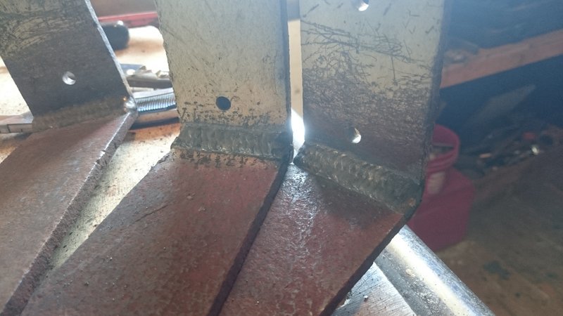

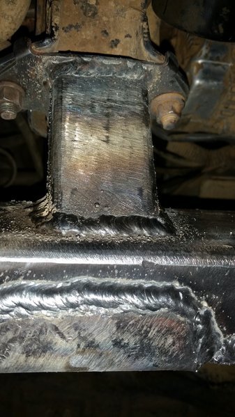

    All overhead flux core with my hobart 140. Motor mount welded to my new frame and fish plate for the steering box mount.20160621_230301.jpg

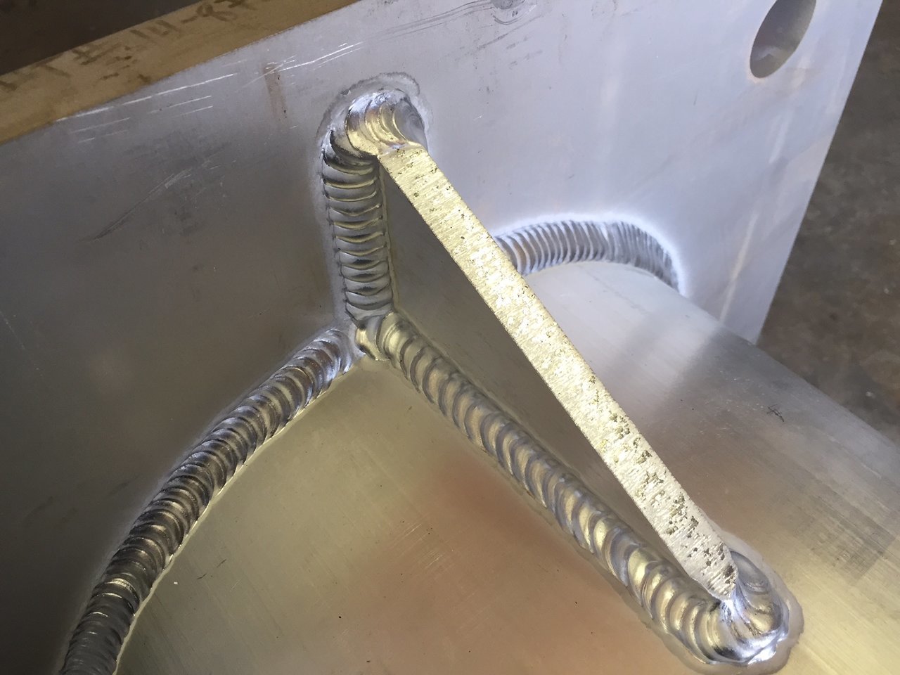

    12" aluminum pipe to 1" plate

    Nice first post dood! Beautiful work

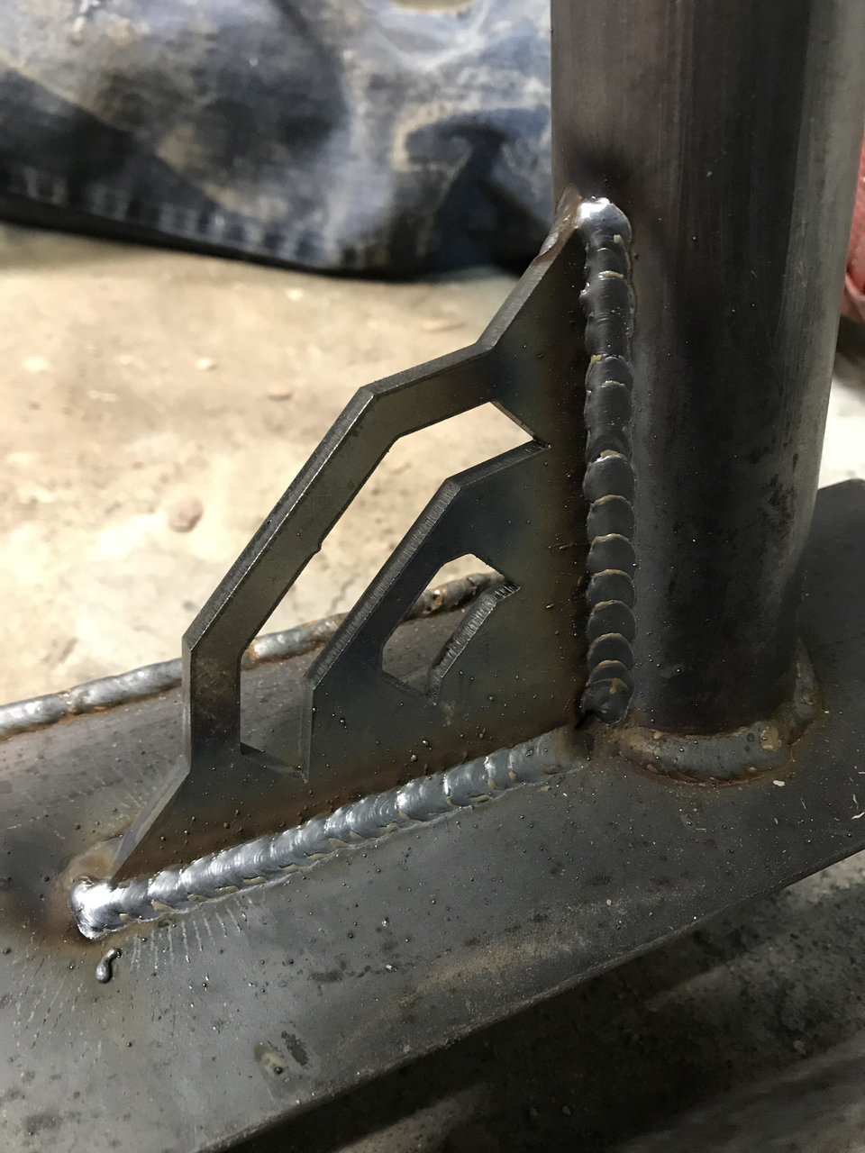

    Building my RTT rack last weekend! Bought the gussets from @JLee. What do you guys think? I'm not a welder by any means, so I would love to hear some recommendations/tips/tricks/criticism. guss.jpg rack.jpg
