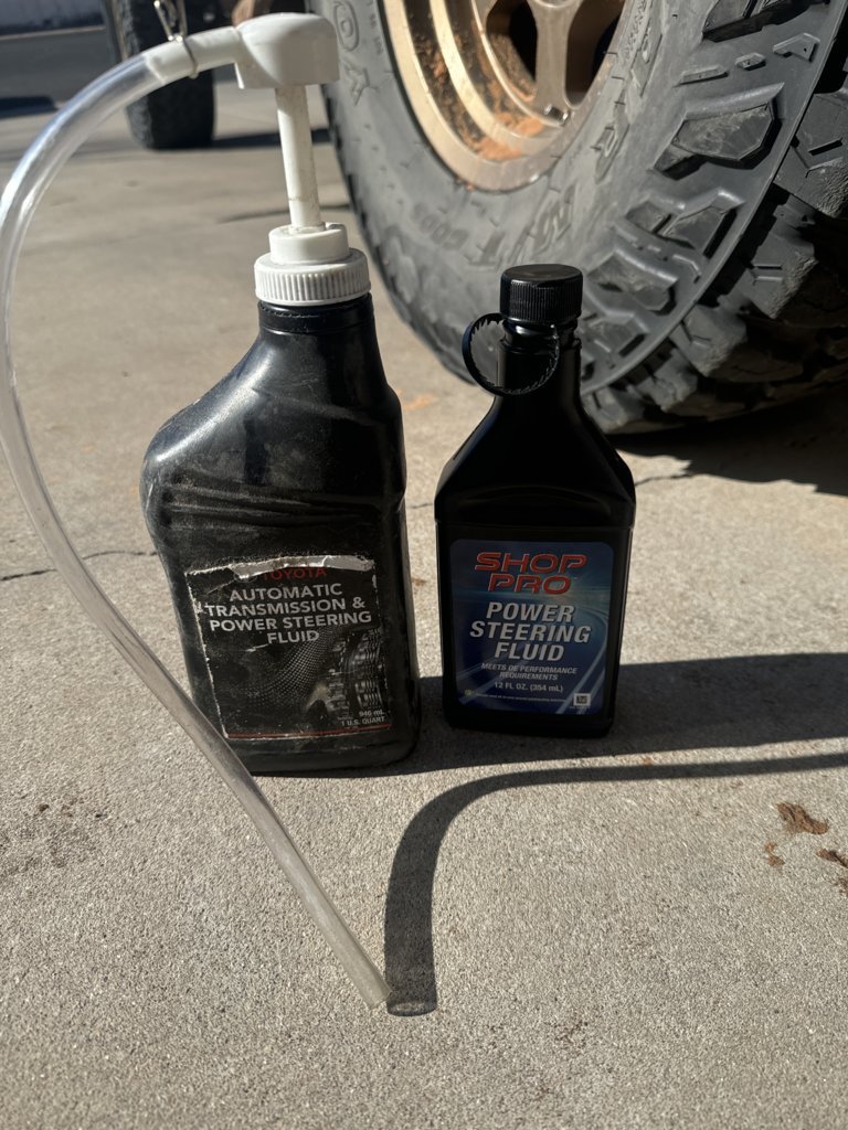

    Guys which power steering do I use for my 3rd gen Tacoma? The fluid in thier seems to be a dark bluish color. I have Toyota atf and power steering fluid which is bright red, and some sshop pro power steering which is a clear color. Photo below which one??

    From 2022 owners manual..
    https://www.toyota.com/owners/warranty-owners-manuals/vehicle/tacoma/2022/
    Power steering fluid type Automatic transmission fluid DEXRON ® II or III
    Not sure what type of ATF is in that bottle but if its is the one that list dexron II/III on the back you are fine. On my 2015 the transmission uses toyota WS atf, but not the power steering specifies Dexron II/III atf just like your 2022. So saying the power steering uses "ATF" without specifying the type isn't correct. There are so many different formulations.

    The left bottle. This is what Toyota calls out to use.

    The reason people get confused is because lube shops will throw regular clear p/s fluid in there as a top-off and then the next time somebody looks it looks clear..

    How can you get confused when the owners manual and even the top of the PS reservoir tell you to use Dexron III.

    The fact that Dexron III isn't "officially" made anymore I'm sure also plays into the confusion (no bottle in a store actually says "Dexron III" on the front (haven't since 2008 or so), you have to look at the back of the bottle to see that it says "Meets Dexron III requirements" or something similar). Such bottles are most-often labeled "Dex/Merc" on the front.

    Jeez some of yall need to take the stick out of ur a$$. I noticed the fluid in the resevior was a darker bluish color so I wasn’t totally sure if the red dextron III shit was correct. AutoZone told me this clear ps fluid was correct then I heard the red was the stuff. Added in the red power steering fluid and returned the clear crap after clarifying on here. Thanks to the people for double clarifying.
