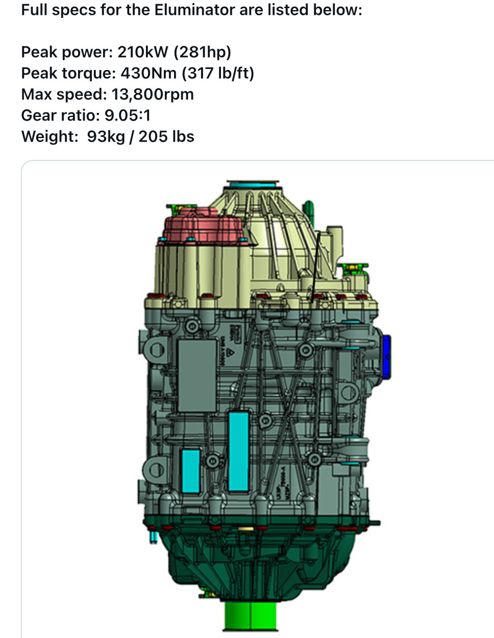

    So I found this on an EV site I go to. Regarding the Ford EV crate miter specs. It shows a gear ratio so it looks like you may not need a transmission or other torque multiplier. . If you can hook up a torque multiplier of any type is unknown but I’m just wondering if this could be hooked via a driveshaft to a transfer case? Hmmm. But still the other parts that are needed will increase the conversion cost mostly the batteries. But for $4k that’s not bad. Inverter cost is yet to be revealed. They can be expensive. Time will tell.
    Kiloyard[OP] likes this.
