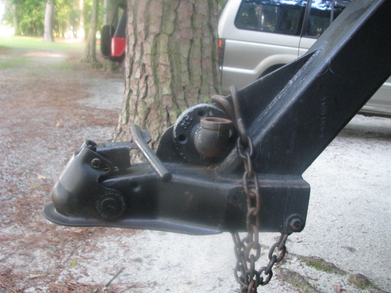

    Yep, 2000 19 Deluxe w/ front bath, built in October of 99. Although they’re often referred to as fifth wheels, the trailer portion of the hitch is actually a bumper type coupler which connects to a ball mounted to a crossbar in the bed of the truck. To the best of my knowledge, this setup is unique to Scamp and a bit of fabrication is required to adapt it to the composite bed in a Tacoma.

    They are typically referred to as goose neck trailers. This is the ball and hitch design for horse trailers. When I had my F250 and 350, I had a set up that was under the bed. There was a thin bar in the wheel well that you pulled and you could flip the ball upside down so it would lay flat with the bed when not in use. Since we have composite beds, I was unsure if this system would work with our trucks.
    Interesting.....
    What does your Scamp weigh unloaded?

    We have a couple of gooseneck equipment trailers on the farm and its not exactly one of those either but that's a closer description than fifth wheel. I attached the hitch towers to two pieces of 60" x 6" flat stock and then mounted those to the bed using the three (per side) OE bed bolts. The ball goes on 3" 'C' channel between the towers. Nothing relies on the actual bed for strength so the composite construction isn't an issue. Home made but it works.

    I bet that does tow like a dream. Moving the leverage point to the axle really makes for a rock solid tow. That is a really great setup. The history you will have with that trailer is going to be the stuff of legend. 20 years still going strong.
