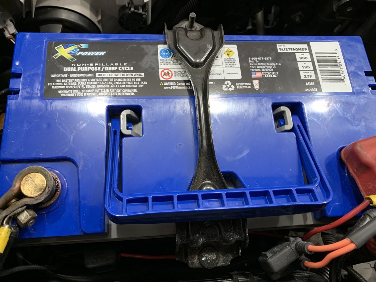

    Hey @crashnburn80 since you seem pretty knowledgeable, is swapping out the stock battery for the x2 power pretty much detach, pullout, replace, and reattach? How should I do it? Black cable off first then red or vice versa?

    Same battery, just the X2 is sold under the Batteries Plus brand. The X2 says NorthStar right on the side. I run the X2 version as my battery was on deaths door and I needed it ASAP.
    Engineers love facts. Facts make everything way easier, no need to debate on opinion. Who doesn’t love a good comparison spreadsheet.
    Yep. There is one minor catch where the integrated handle in the NorthStar is just a bit wider at the top of the battery than stock. I did my change quickly in a parking lot in below freezing weather wearing a T-shirt and went through the handle instead of over it. I’ve seen people mess with it and be able to get it over the handle though.
    Black cable should be detached first and attached last.

    This post is exactly what I needed today. I'm currently deployed and the guy watching my truck back home just told me the stock battery died so based on TW's recommendations I'm thinking I'm gonna go with the X2 27F.
    My only concern is that since I'm not there and someone else will be putting it in for me, will the larger size fit on the stock 3rd gen tray? I already feel bad the guy has to deal with changing it so I just wanna make sure I dont get a battery that won't fit so he has to deal with that too. It seemed like other people said it will fit, just hang over the edge a little, but I just wanted to double check.
