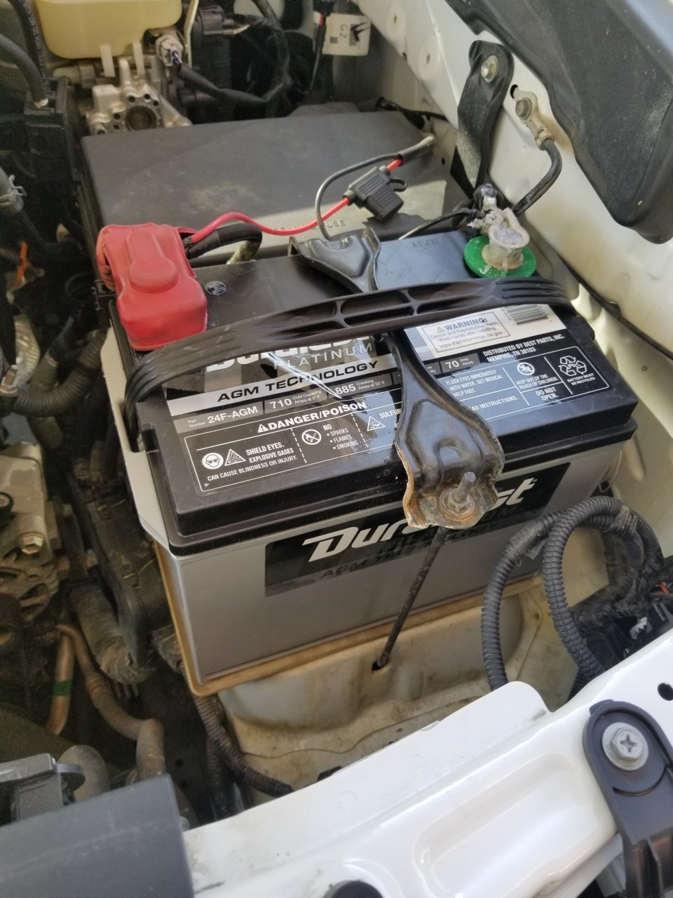

    Picked up a duralast 24f AGM today from autozone. Hopefully it will last 40k miles like the stock battery did.
    shakerhood likes this.
