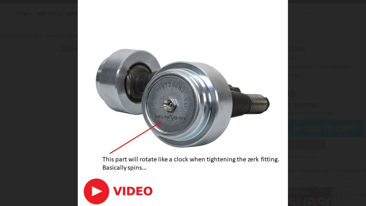

    Anyone with Delta Joints experiencing this issue? When screwing in the zerk fitting to the top of the housing (Cap) protecting the joint it spins. Major issue as I can't tighten the zerk fitting into the housing. Just wondered if anyone else had that issue. Only having the issue with one side...
    Pic for reference:

    The kit comes with a standard zerk and a special needle zerk. I put the standard zerk in.
    I used the C-clamp style rental balljoint kit from whatever auto parts store with the Icon UCA still on the truck. It was a little tedious because I had to keep swapping out the adapters as clearances would change so it wasn't just press and done. However, I don't think it was too bad. I had a heck of a time popping the original uniballs out, when they broke loose, they really broke loose. No harm done though and got the deltajoints pressed in just fine. No other special tools needed.
    Optimal? Heck no. Doable? Absolutely
    I am really loving my DJ Retrofits. The original Uniballs were shot and had tons of slop in them and squeaked like crazy. These DJ are silent and solid. NO issues and definitely satisfied!

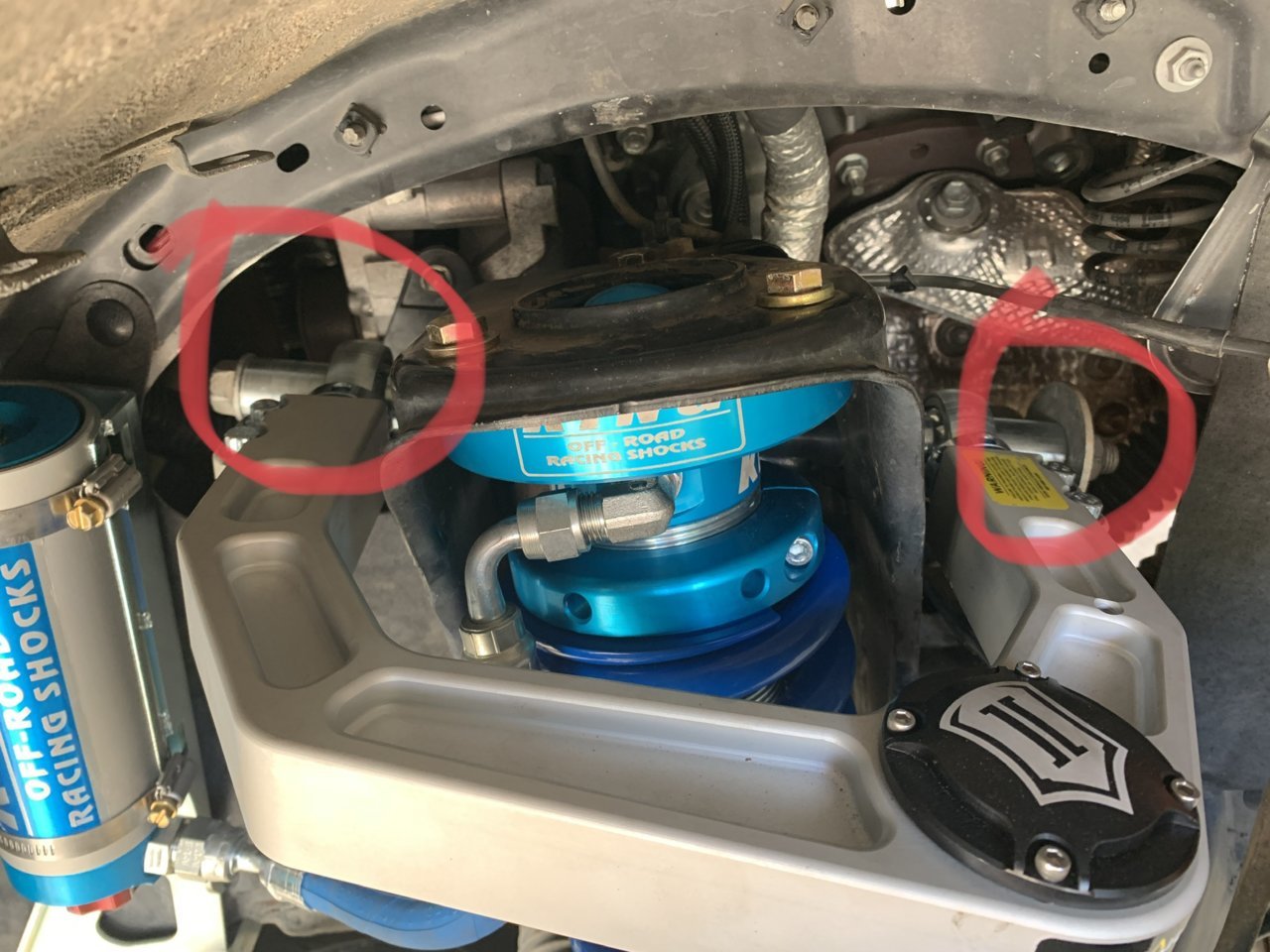

    Los Angeles
    does anyone know where an install guide is? icon directions suck.... and im currently sitting my my garage at 9:30pm with my truck ripped apart. ughhh

    What are you struggling with?
  19. Jul 3, 2019 at 8:20 AM
    #259
    @T.A.C.O.M.A
    @T.A.C.O.M.A Well-Known Member
    Dec 27, 2018
    #277156
    336
    Los Angeles
    There are two large washers that go through the pivot bolt on top. Do those go back in or stay out?
    When I torque that down, the UCA gets super tight and hard to move.
    I put one washer back in on the right side to show you, they were obviously on both sides. I originally left them out.
