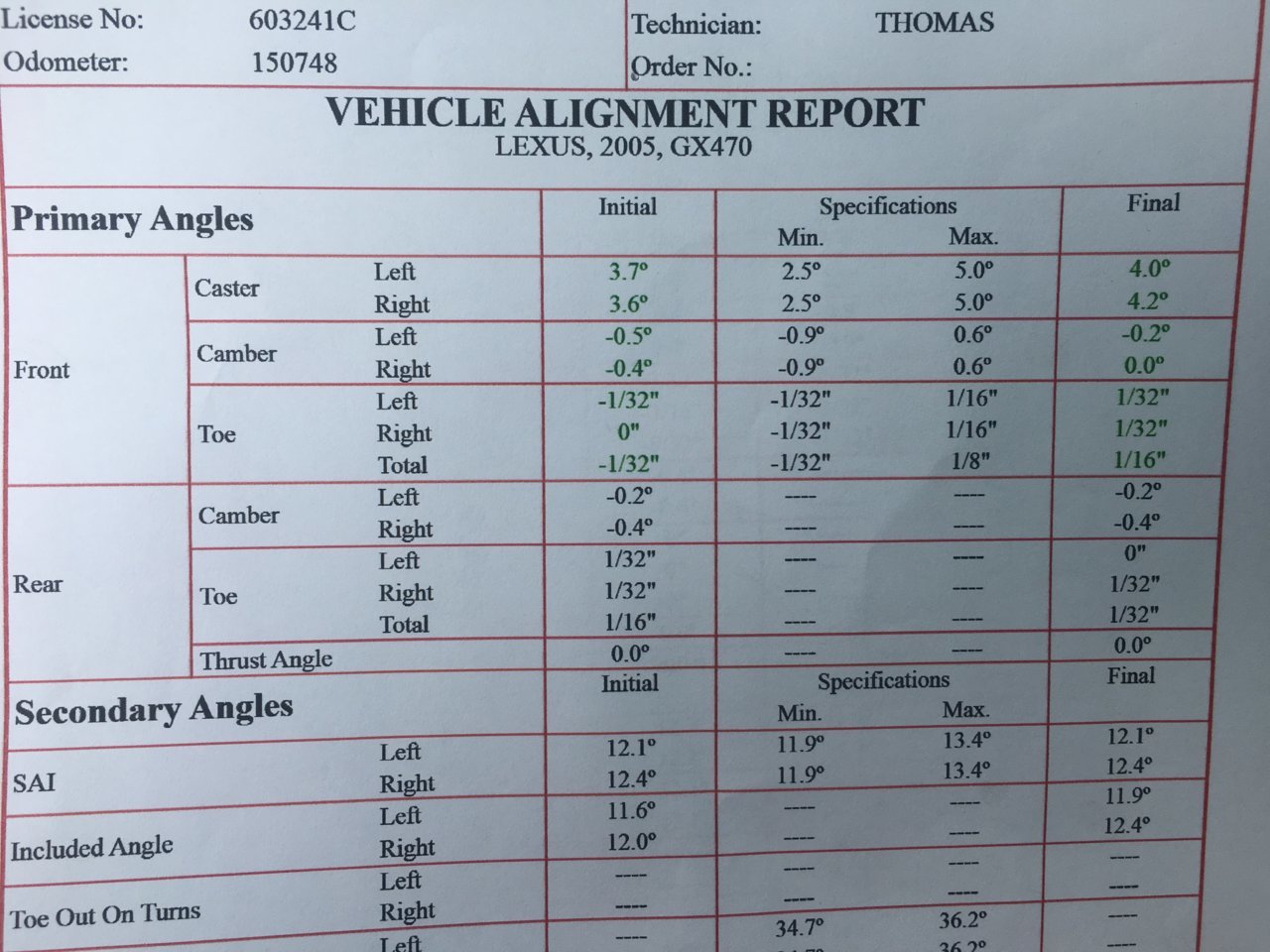

    Here you go. Factory specs for the GX calls for a lot more caster(2.5-5). Looks like I didn’t really need a alignment after I added the bumper, winch and new wheels and tires but at least now I know my alignment is good to go. Dang tires are expensive!

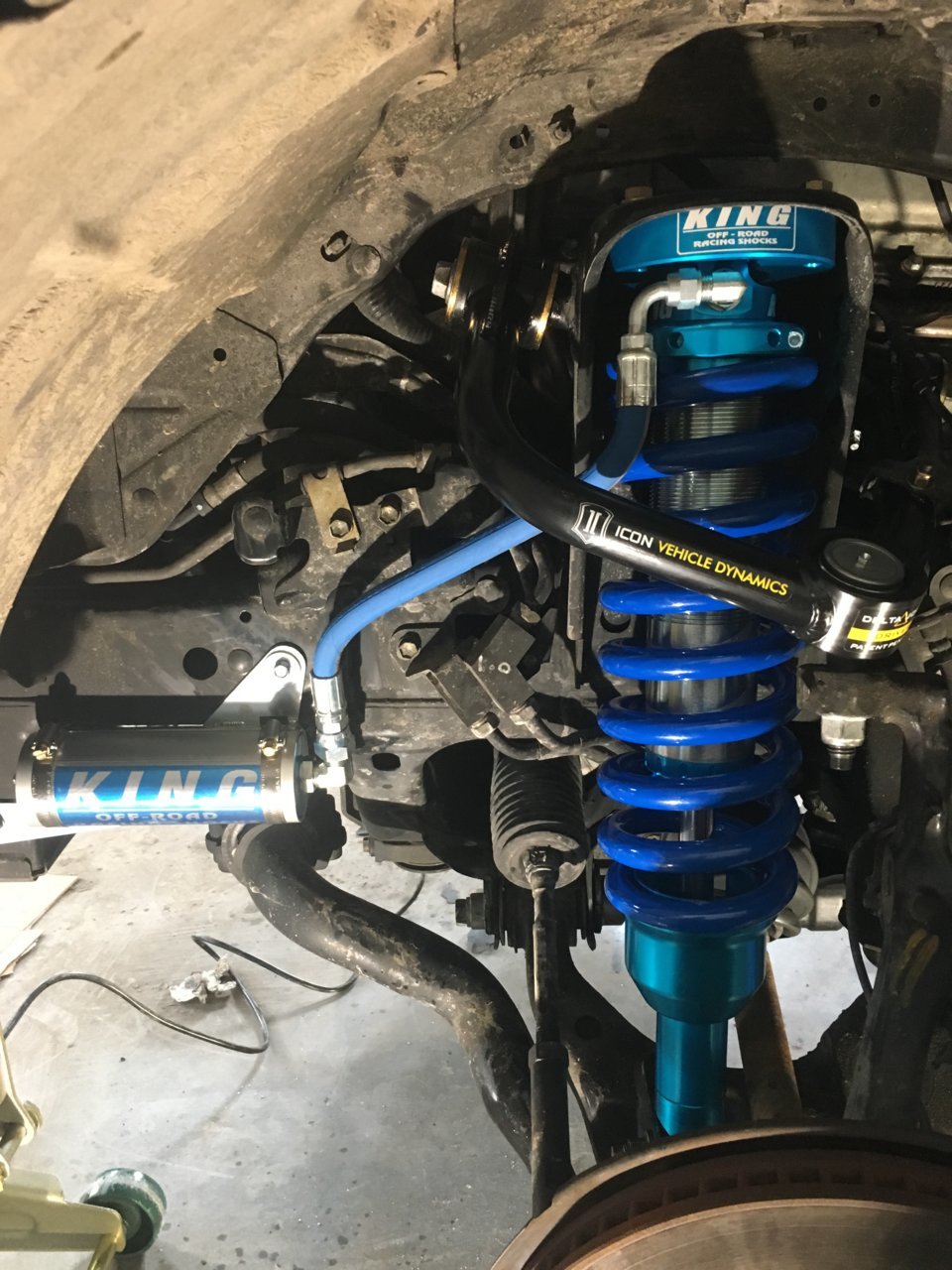

    There are 14 pages on this thread and not one person has posted pictures of the Delta Joint retrofits on TC or Dirt King, or similar control arms installed on their ride?!
  18. Feb 11, 2020 at 7:52 AM
    #278
    12TRDTacoma
    12TRDTacoma [OP] Powered by Ford, GM, VW, and Mercedes
    Aug 20, 2012
    #85133
    16,683
    Rob
    Concordia
    12 TRD Sport DCLB 4x4 Supercharged
    Boosted
    Fine. I'll do it myself.
    Gen 1 Dirt King tubular upper control arm retrofits. Whole different truck now.
