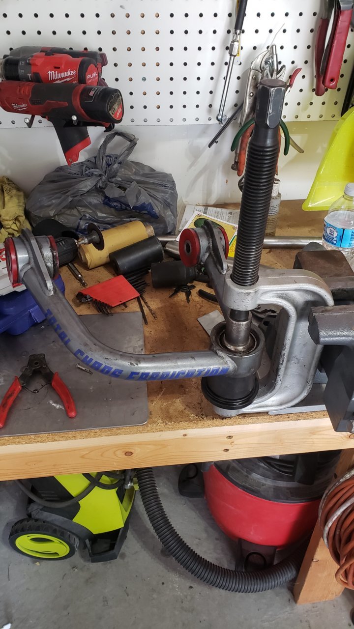

    Thanks to this thread, I was able to press these in today. Using the Autozone ball joint loaner tool kit with some sockets.20210718_144234.jpg 20210718_135527.jpg

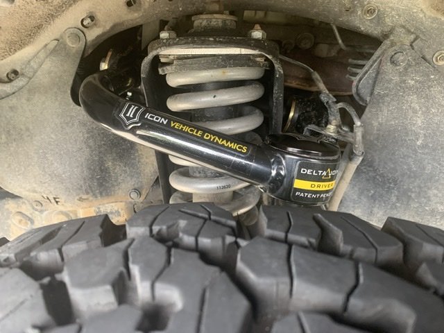

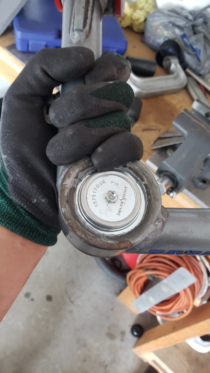

    Finally got around to putting these on my TC UCAs. However, the bearing bore on the control arm is about an 1/8" bigger than the delta joints. What am I missing? I purchased the 614560 kit, but I do notice the serial printed on the top of the delta joints differs from the ones in this thread. I show 157517BJ K20, not 157517DJR F18.
    ...I just busted out the calipers and measured. The deltas I have are 2" across...something must've been mixed up somewhere.

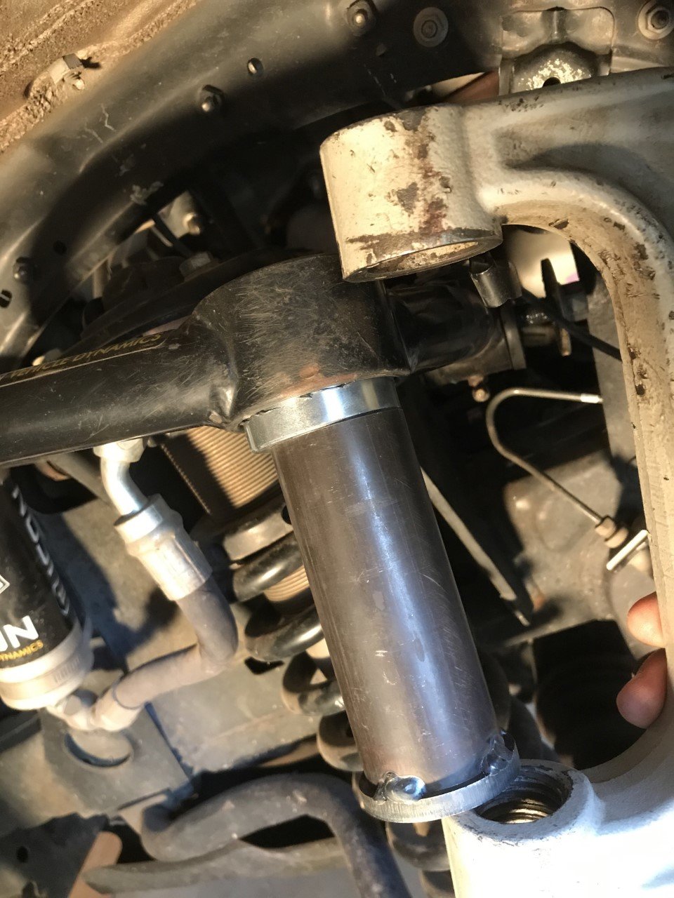

    I was able to do the install of the delta joints with the UCA's on the truck, but did run into an issue with the press adaptor tube from ICON. It was about a half inch too long - the end of the delta joint was a good inch from the end of the tube. I say a half inch because I couldn't fit the press, tube and joint on the UCA. Curious if anyone else had that issue?
    I remedied this by using some pieces from the press kit and the 2 old uniballs (as a spacer/"tube") to get the joints in place.
