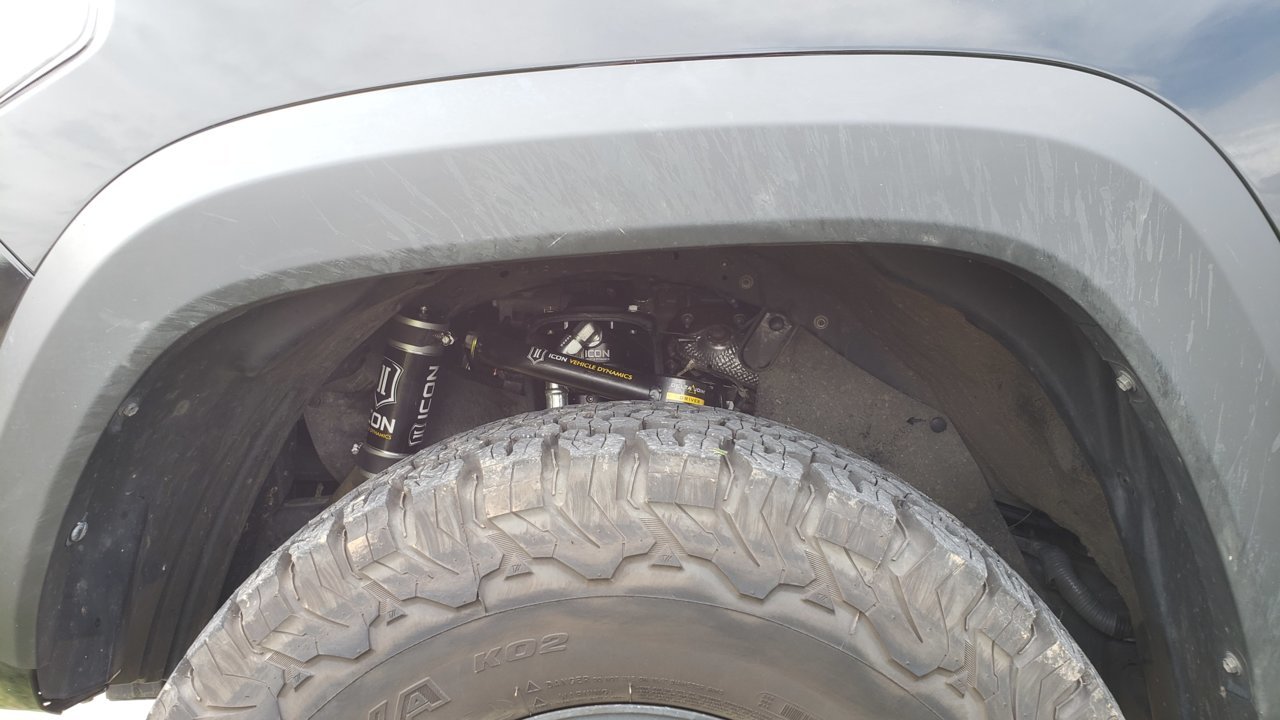

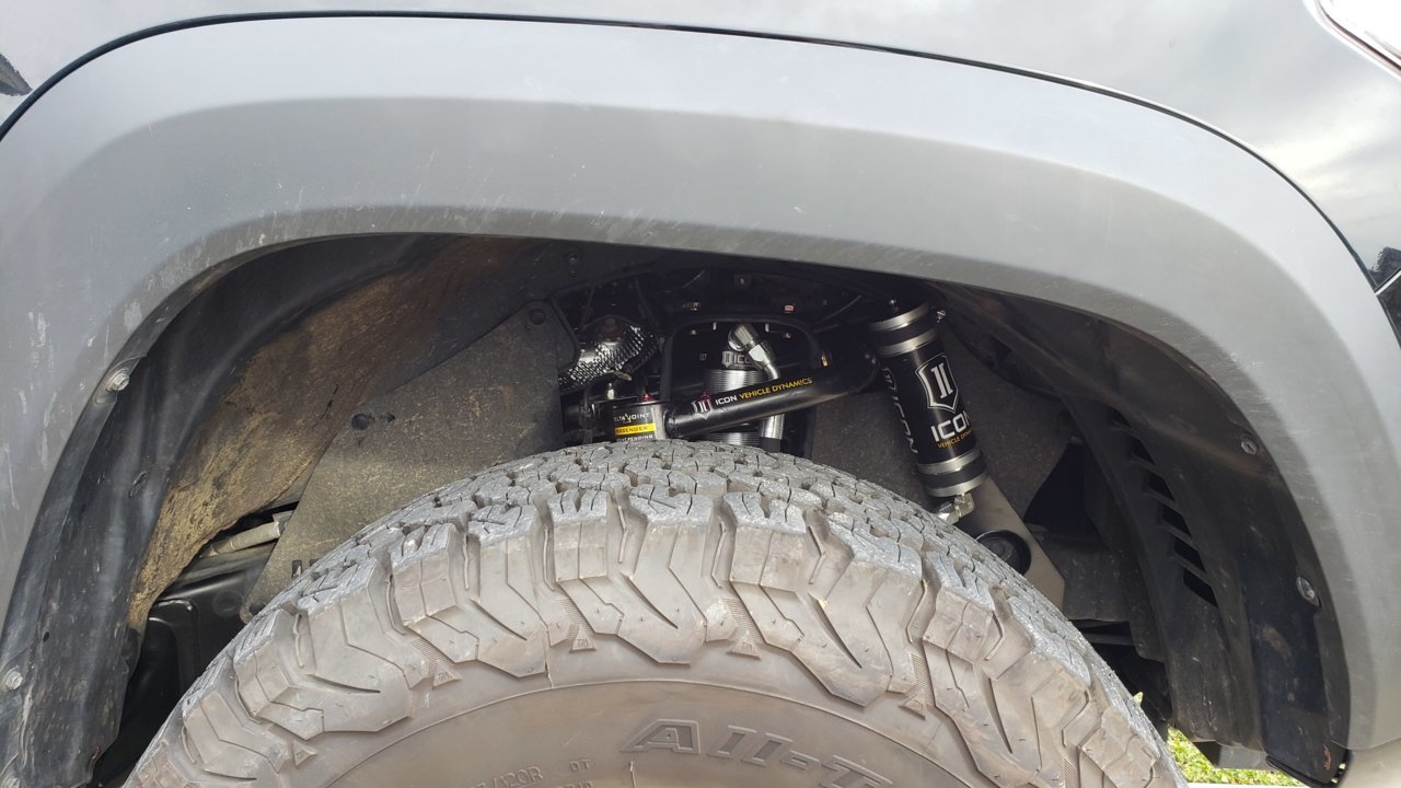

    Here's what I see -
    Driver Side:
    Passenger Side:
