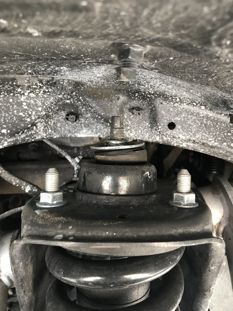

    I’ve been hunting down a noise in my passenger front end [what I thought was the UCA] for weeks now. Grease & replace the Bushings didn’t do it. Bugging the shit out me...
    Finally figured it out!
    It’s the top of the shock rubbing in the top hat because the top bushing is pretty much blown out and causing it to squeak squeak squeak... Every little nook & cranny in the road. :boink:
    Anyway... just another possible noise maker. I don’t believe this would be a problem with ICONs as they don’t use a top hat and pop up through the top like traditional shocks do. :notsure:

  19. Nov 15, 2017 at 10:53 AM
    #139
    TireFire
    TireFire Superunknown Member
    Feb 6, 2016
    #177349
    7,435
    Olympic Peninsula
    Negative, Icon does use top hats with spherical bearings. Mine never made any noise in years though
    BandanaBerg[QUOTED] likes this.
  20. Nov 15, 2017 at 10:58 AM
    #140
    BandanaBerg
    BandanaBerg Yotas Yotas Yotas Pocast
    Jan 11, 2017
    #207231
    1,126
    Jason
    Phoenix,AZ
    ‘06 PreRunner TRD Off Road
    Up Front; MaxTrac 4” Lift Spindles, Icon 2.5 Extended w/ Fox 600s, Icon Delta Joint UCAs, Total Chaos Cam Tab Gussets, US Off Road Hidden Winch Bumper w/ Engo S9 Winch, Pelfreybilt Legacy IFS Steel Skid... Out Back: Archive Garage Hammer Hangers w/ High Clearance Cross Bar, OME Expedition Pack, Icon 2.0 RR, All Pro U-Bolt Flip w/ Super Bumps, All Pro Extended Brake Lines, Dif Breather Mod, Custom Swing Gate Tire Carrier, Home Made Hi Lift Brackets & Hi Lift Jack Wheels & Tires: Pro Comp 5001 Wheels 16" on some 285/75/16 BFG AT KO2, "Custom" Frankenstein Cab Mount Chop, ARB Single Compressor (mounted in the cab behind the back passenger seat)... Up Top & Around: Trail Gear Rock Sliders, CaliRaised LED Premium Roof Rack w/ CaliRaised LED Dual Function Light Bar, CaliRaised LED Amber Fogs in CaliRaised LED LED Fog Light Pod Replacement Brackets, Anytime Fog Mod, CaliRaised LED Ditchlight Fogs on CaliRaised LED Low Profile Ditch Light Brackets, Voswitch UV100 Switch Controler, Chineseum Chase Ambers & reverse/camping LEDs, Relentless Bed Bars, Smittybilt Overlander RTT Misc Thangs: Tech Deck w Ram Ball Mounts
    Right. But the shockdoesn’t shoot up through the hole with the Bushings and washers and nut etc... right? That’s where my issue is at the moment.
