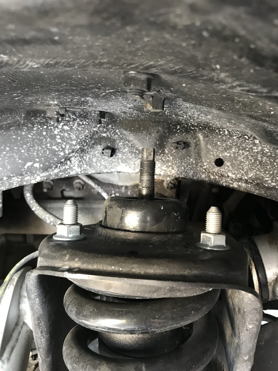

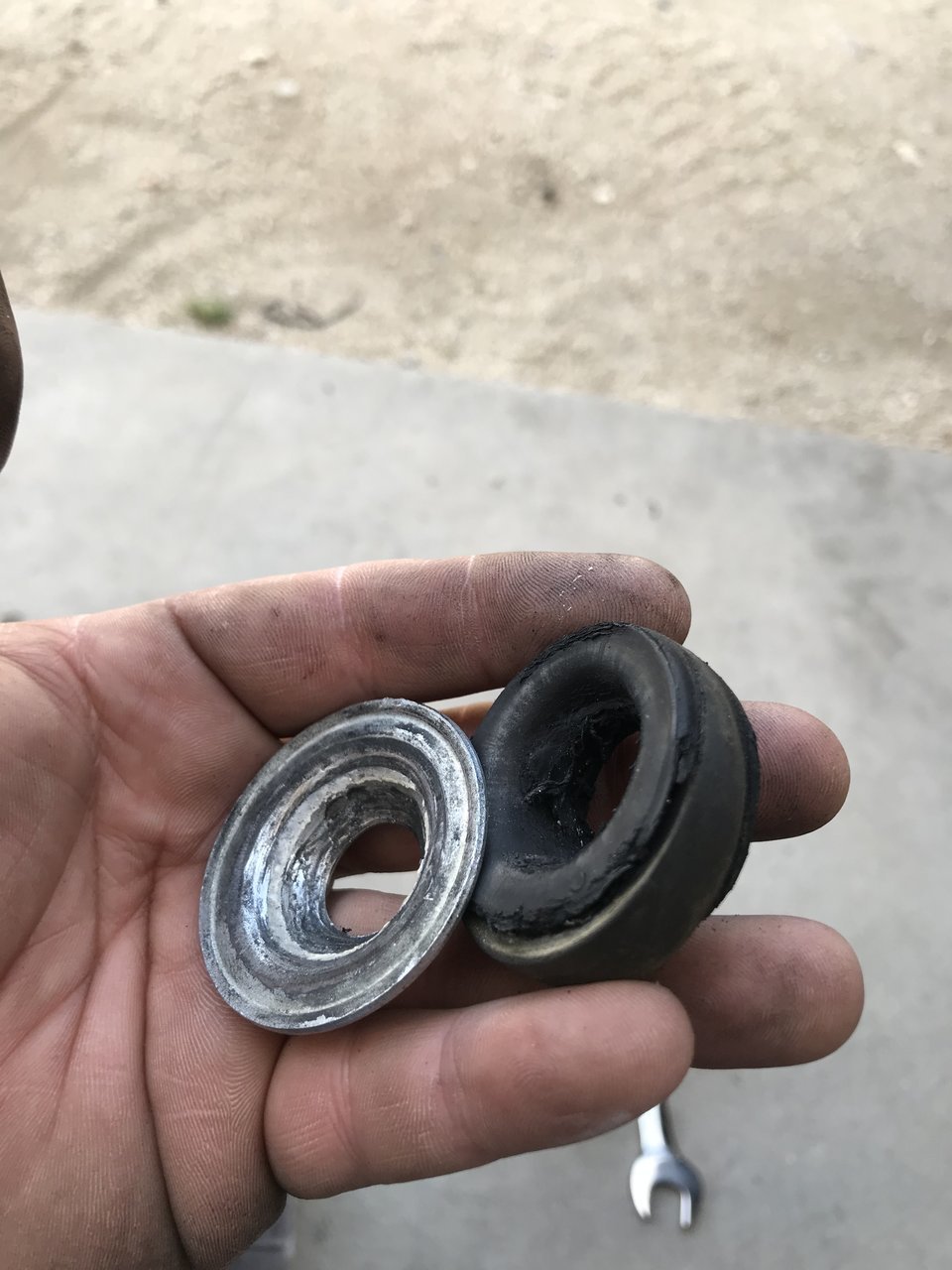

  18. Dec 17, 2017 at 1:12 PM
    #178
    BandanaBerg
    BandanaBerg Yotas Yotas Yotas Pocast
    Jan 11, 2017
    #207231
    1,126
    Jason
    Phoenix,AZ
    ‘06 PreRunner TRD Off Road
    Up Front; MaxTrac 4” Lift Spindles, Icon 2.5 Extended w/ Fox 600s, Icon Delta Joint UCAs, Total Chaos Cam Tab Gussets, US Off Road Hidden Winch Bumper w/ Engo S9 Winch, Pelfreybilt Legacy IFS Steel Skid... Out Back: Archive Garage Hammer Hangers w/ High Clearance Cross Bar, OME Expedition Pack, Icon 2.0 RR, All Pro U-Bolt Flip w/ Super Bumps, All Pro Extended Brake Lines, Dif Breather Mod, Custom Swing Gate Tire Carrier, Home Made Hi Lift Brackets & Hi Lift Jack Wheels & Tires: Pro Comp 5001 Wheels 16" on some 285/75/16 BFG AT KO2, "Custom" Frankenstein Cab Mount Chop, ARB Single Compressor (mounted in the cab behind the back passenger seat)... Up Top & Around: Trail Gear Rock Sliders, CaliRaised LED Premium Roof Rack w/ CaliRaised LED Dual Function Light Bar, CaliRaised LED Amber Fogs in CaliRaised LED LED Fog Light Pod Replacement Brackets, Anytime Fog Mod, CaliRaised LED Ditchlight Fogs on CaliRaised LED Low Profile Ditch Light Brackets, Voswitch UV100 Switch Controler, Chineseum Chase Ambers & reverse/camping LEDs, Relentless Bed Bars, Smittybilt Overlander RTT Misc Thangs: Tech Deck w Ram Ball Mounts
    It’s pulled down into the “coned washer”!!!
    I replaced these and my uniball (not Icon Deltas, still unsure if the Deltas will fit in my UCA’s or I’d def purchase them) recently and fixed my noise issues!

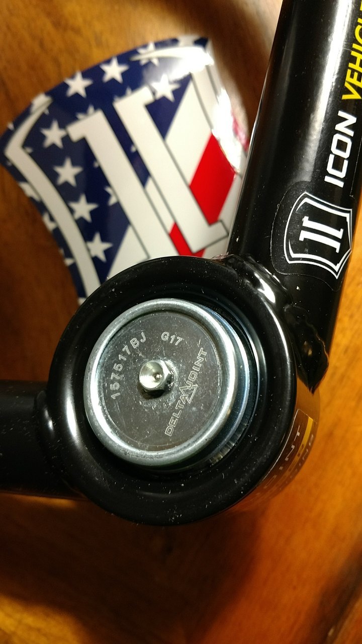

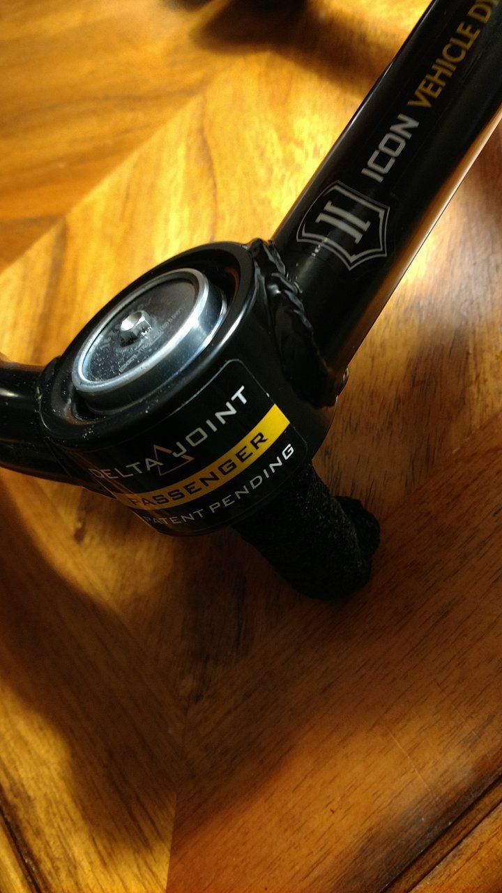

  20. Jan 2, 2018 at 6:16 PM
    #180
    SMBHooker
    SMBHooker Mag Beast
    Oct 14, 2017
    #232989
    363
    2017 DCLB 4x4 TRD Sport MGM
    These just came in... exciting! :yay:
