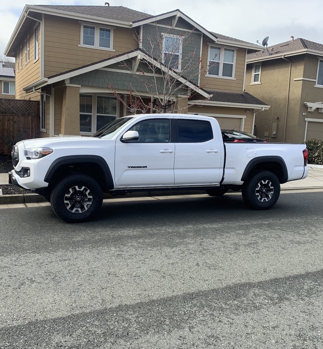

    2/1 lift done Sits perfect now Thanks for all the advice TW FAMILY 77C9A746-5D2D-44EB-8C5E-D80E96985FFE.jpg

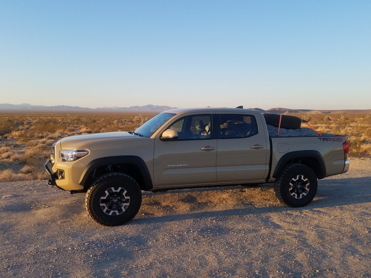

    I'll throw mine into the mix here.
    I'm up right at 2" at all 4 corners with 2" up front on the kings and 1" LROR tapered in the rear.
    Never liked the leveled look and wanted to keep a near factory rake.
    With a good heavy camp load in the back, it goes slightly bro lean, but not bad.
    Never understood the leveling thing myself either. Guess it looks okay when unloaded, but throw any weight in at all or throw a trailer on, and it's like.....

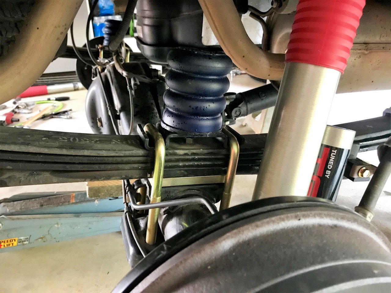

    Finally installed the 1/2" spacer under the rear leaf pack. Now the rear sits exactly one inch higher than the front. Perfect for what I wanted them for. Very Happy.

    I tow a 20 foot Center Console Bay Boat. This setup works so good. When the boat is loaded, the rear comes in contact with the Sumo Springs, nice and smooth, very little sag now. I will get a pic of the truck hooked to the boat and post later.
