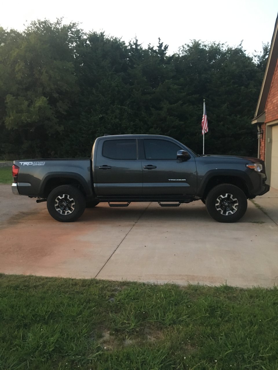

    #360
    Ceaven
    Ceaven Active Member
    Jun 9, 2019
    #295836
    31
    2019 Toyota Tacoma trd off-road
    Ok guys here is my 2019 with OME 2887 springs and bilstein 5100s I have a 1.5 -2” pro comp aal but these dons even look the same size or deflection so I think I’m sending them back . I only want 1.5 or 1”
