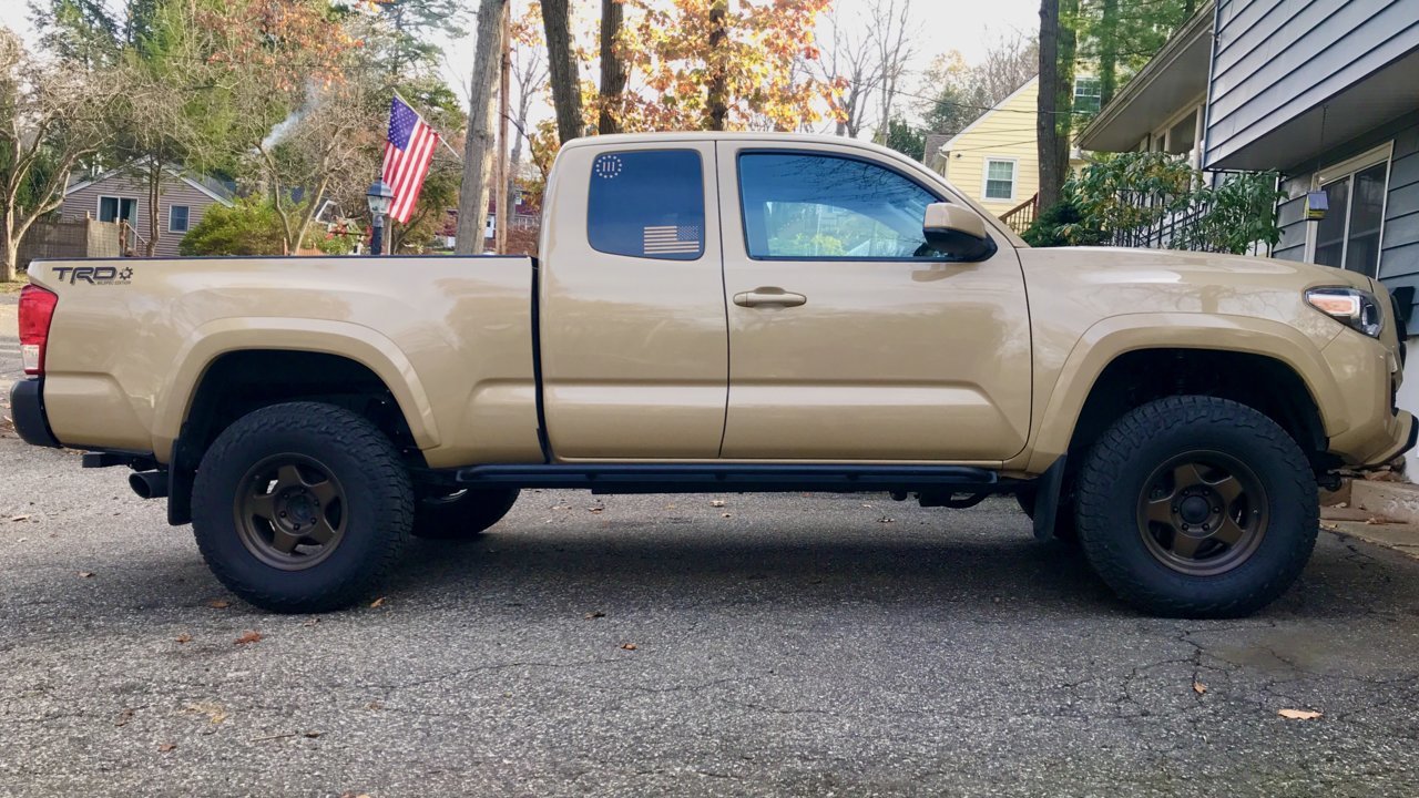

    Bilstein 5100s with OME-885 and 1.5” rear blocks (I am gonna swap and put 1” blocks since there is too much rake). 265/75r16 tires...

    Really? Nah. I think it looks good. I would leave it as is.

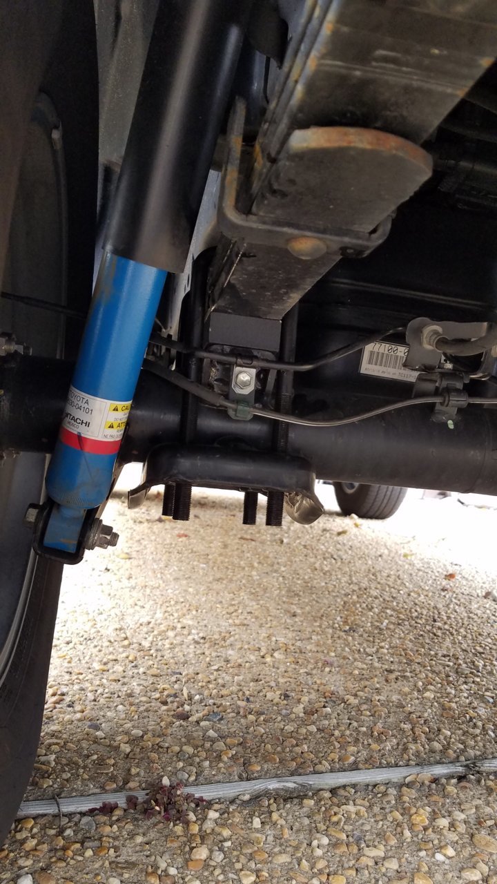

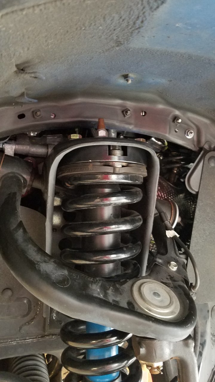

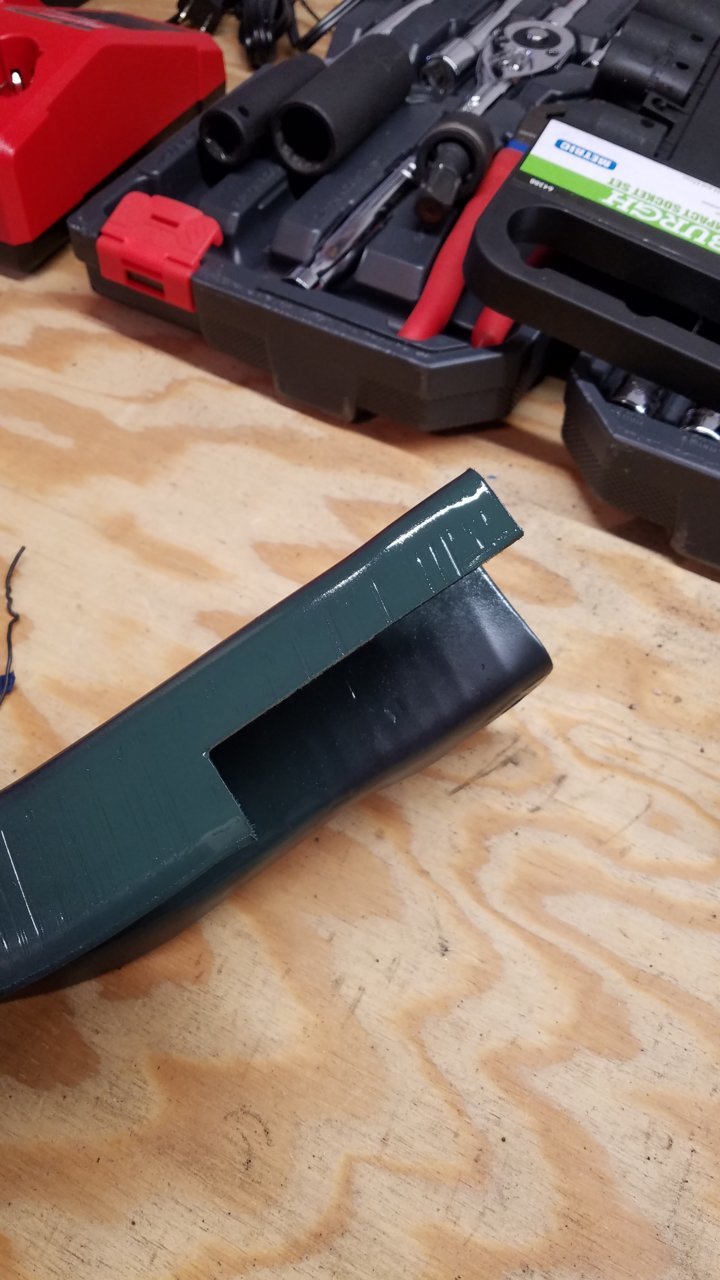

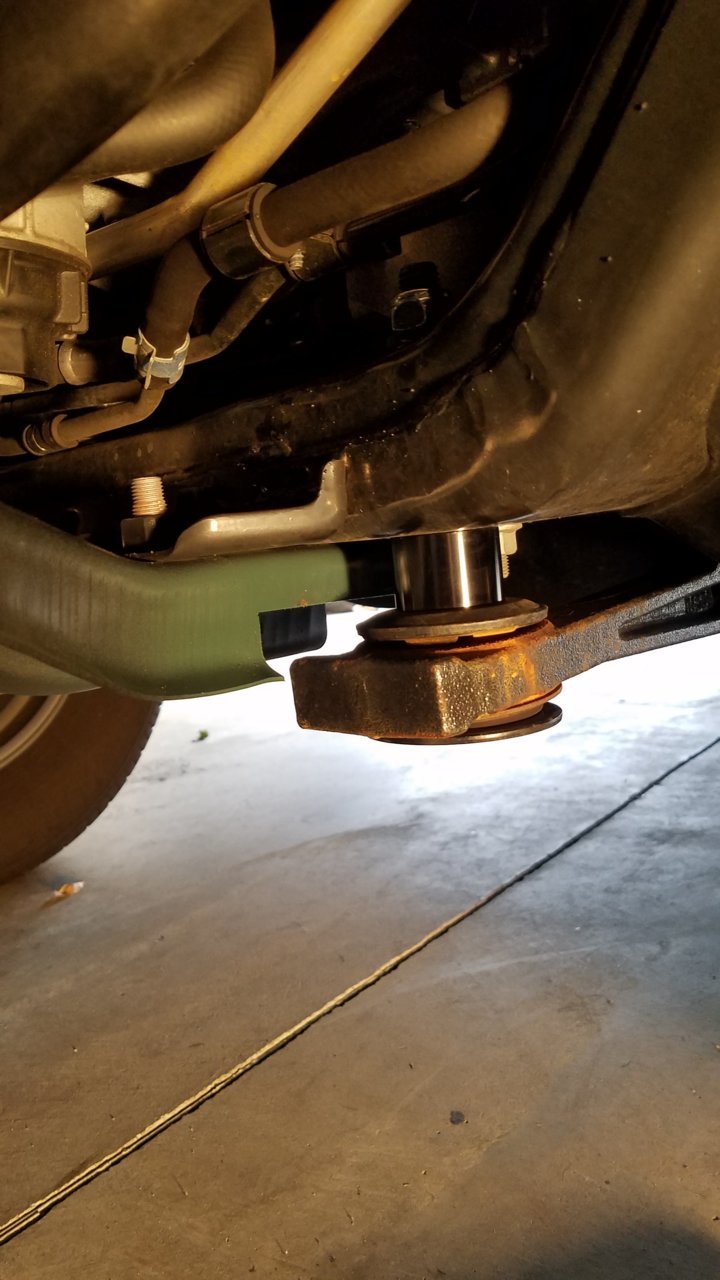

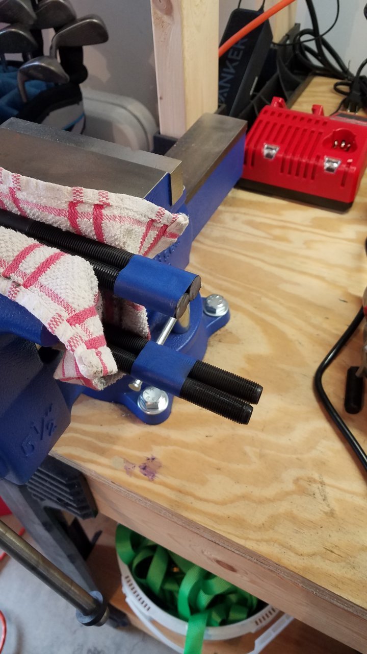

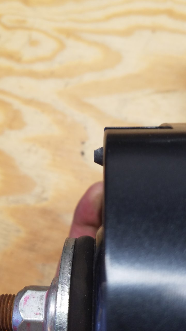

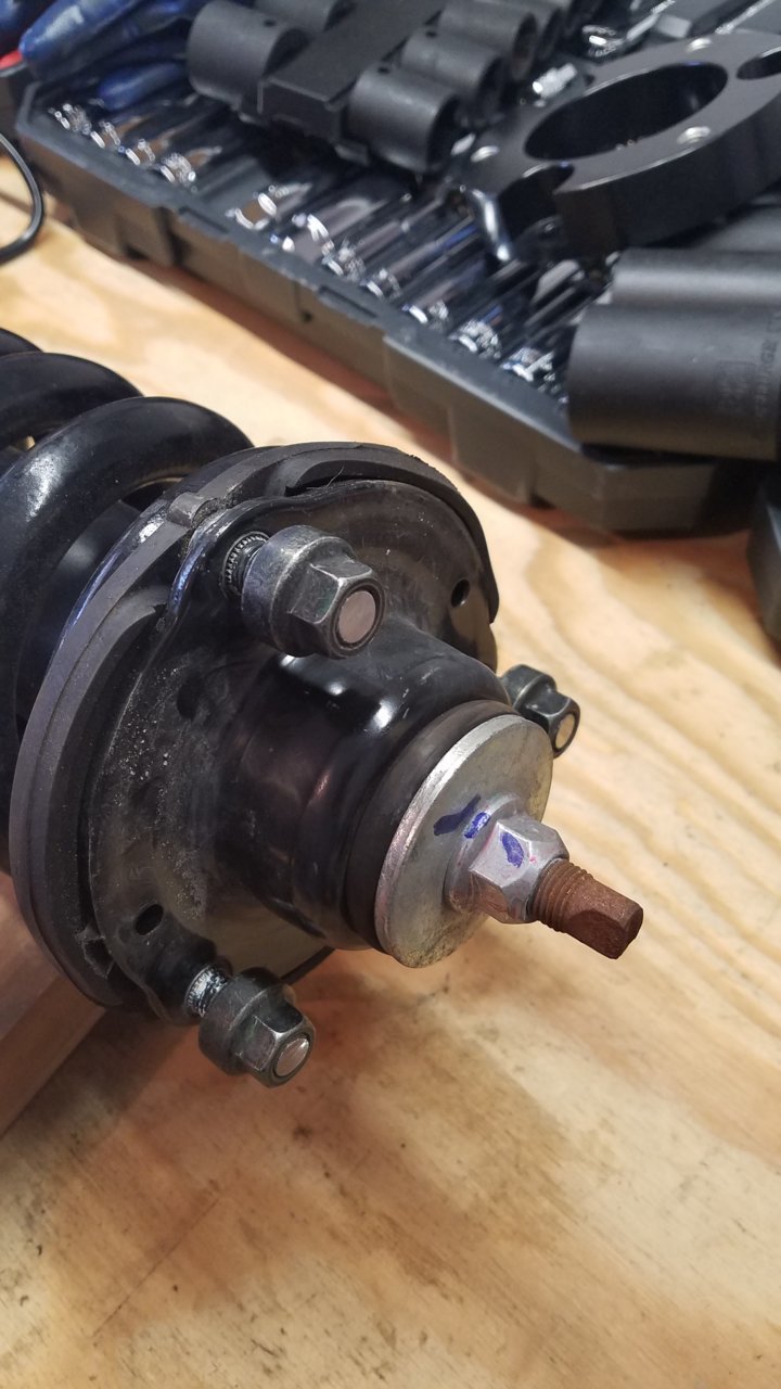

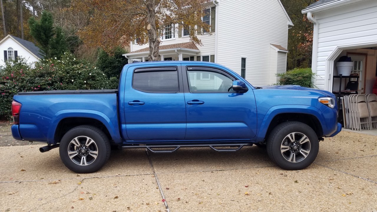

    Installed Supreme Suspension 2/1 with diff drop. I did it by myself and it took about 5 hours using a floor jack and a pair of jack stands. I had to grind down the fixed shock tower studs a bit for a flush fit. I also had to cut rear aftermarket u bolts as they were too long for deep well socket. The skid plate bracket also needed to be trimmed to clear differential.
    I couldn't have done it without this video
    https://youtu.be/kru76w4GqZI
    I also couldn't have done it without my Milwaukee 1/2" impact driver. I purchased it specifically for this job.
    https://www.ebay.com/ulk/itm/183907971374

    Ok so my 2/1 lift is installed to include diff drop. I notice a vibration around 20 mph when decelerating. It's not bad but definitely wasn't there before. Do I need the carrier bearing shims? Just to confirm, is what I'm looking for, OME part # FK29?

    I didn’t think you needed a diff drop on a 2/1 lift.?

    Mixed answers. I did it for good measure. Seems logical though. Strut spacer is 1" thick and diff spacer is also 1" thick.

    I did the carrier bearing drop as well
    Rear shims? FK 29 is correct bro
