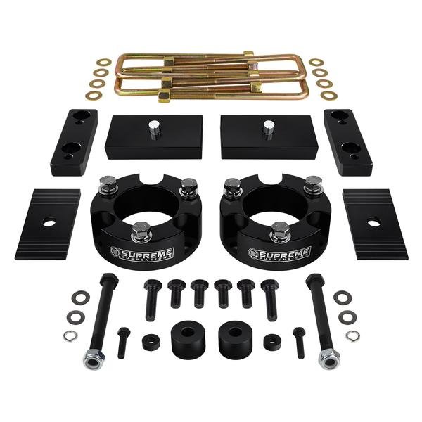

    Thanks. They look like shims. Do you have the vibration I described when decelerating through 20 mph?

    Once and while I have noticed a vibration. Not all the time at first install.Did you also get axle shims for rear? Helps correct angle a driveline

    No axle shims...

    Pm me if you want bro

    I was just pm'd by another member suggesting that maybe the blocks I have are directional. I don't believe the Supreme Suspension blocks are directional. Can anyone else confirm?

    They are not. They sell a shim with rear blocks in lift kits.

    Why would Supreme Suspensions not include that in the kit? Makes zero sense!

    In there lift kit sections they have choices in lifts with choices for shims and diff drop etc. I agree makes no sense. I did my research and purchased all items in kit just to be safe.

    Order the shims you’ll be good. No stress.

    I contacted Supreme Suspension asking if they sell the tapered rear block shims to keep costs to a minimum. If they dont then I need to decide on Heavy Metal 1" tapered blocks $65 or Supreme Suspension 1.5" tapered blocks $33 (no u bolts) Then sell my 1" flat blocks. Not happy about needing to drop my rear end again!

    Low range offroad 1inch block is also tapered if you want another option.

    At first glance, the front appears to be a bit higher. Since I'm having vibrations around 20 mph due to 1" non-tapered blocks, I may install 1.5" tapered blocks. Once I hear back from Supreme Suspensions about ordering the shims alone, I will post.

    kit with rear block and shims
