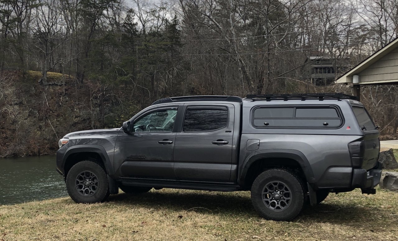

    I’m going to run 275 next went with the 265 like but I think the 275 will look better

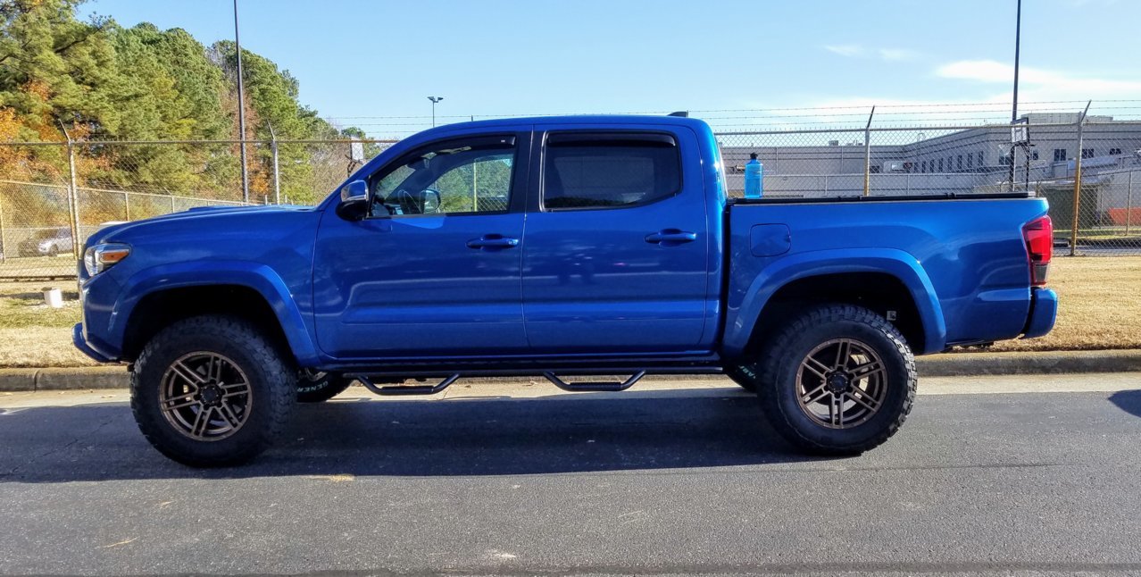

    I contacted Supreme Suspension and I have a set of shims in route. Will report back once installed.

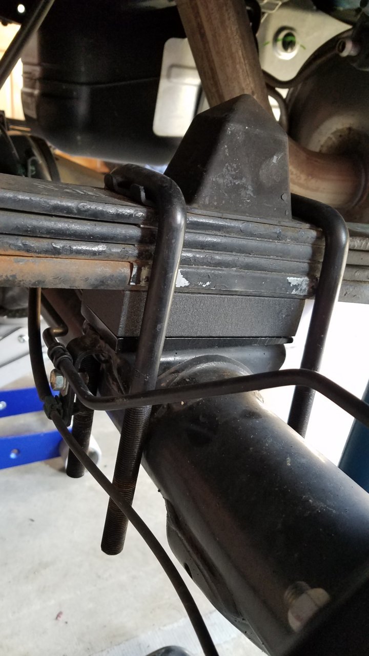

    With the one inch block are you guys using factory u bolts or getting new ones?

    New ones.

    Personally I shopped around before buying, I found eBay and Amazon offered low priced parts. I believe I did the math it was something like $70 after taxes and shipping off eBay using different sellers to piece together the parts. What I did though was order from supreme suspensions, I bought the set from them. Good quality parts, paid $110 shipped. I didn’t get the differential drop nor the shims. Some say it’ll vibrate without them, I had no vibration. Others get one or the other and get vibration. I followed the track of 2 other buddies who did the same without any problems.

    Shims installed. Vibration gone. Very happy with result. No loss in ride quality.
