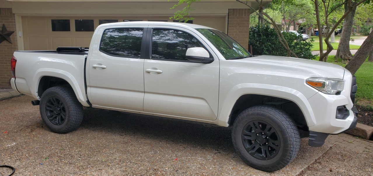

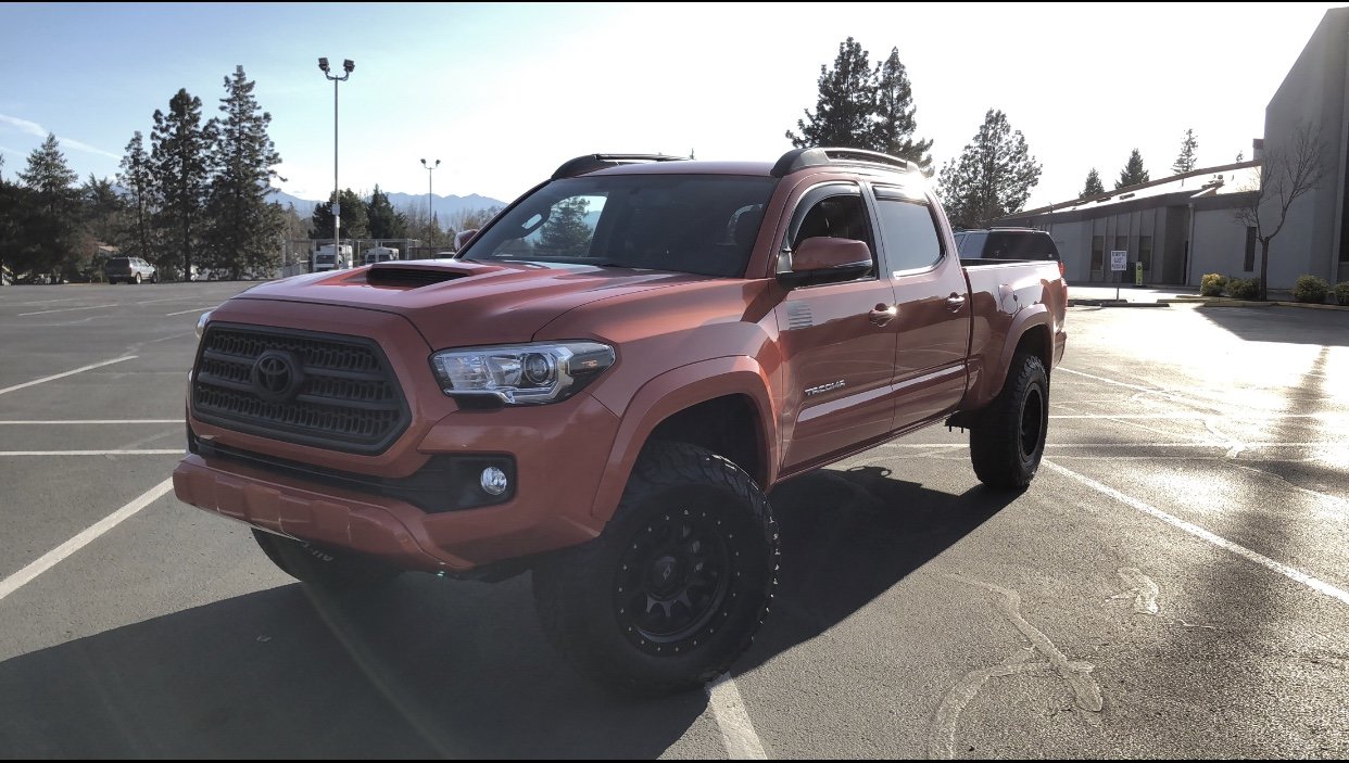

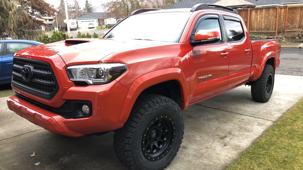

    here it is after the front billsteins at 1.75 inches and a 1 inch eibach block in the rear. I have about a .5 inch rake, which I’m totally ok with. I think this amount of lift looks good with my setup, but obviously I’m biased. Some of my buddies said I should have lifted more. I disagree.

    Looks good man. I like how you took off the Tacoma and other emblems. Never seen that.

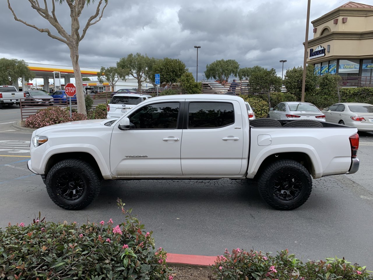

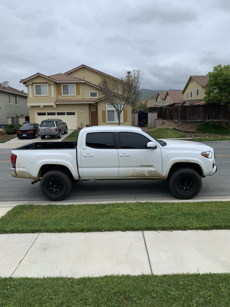

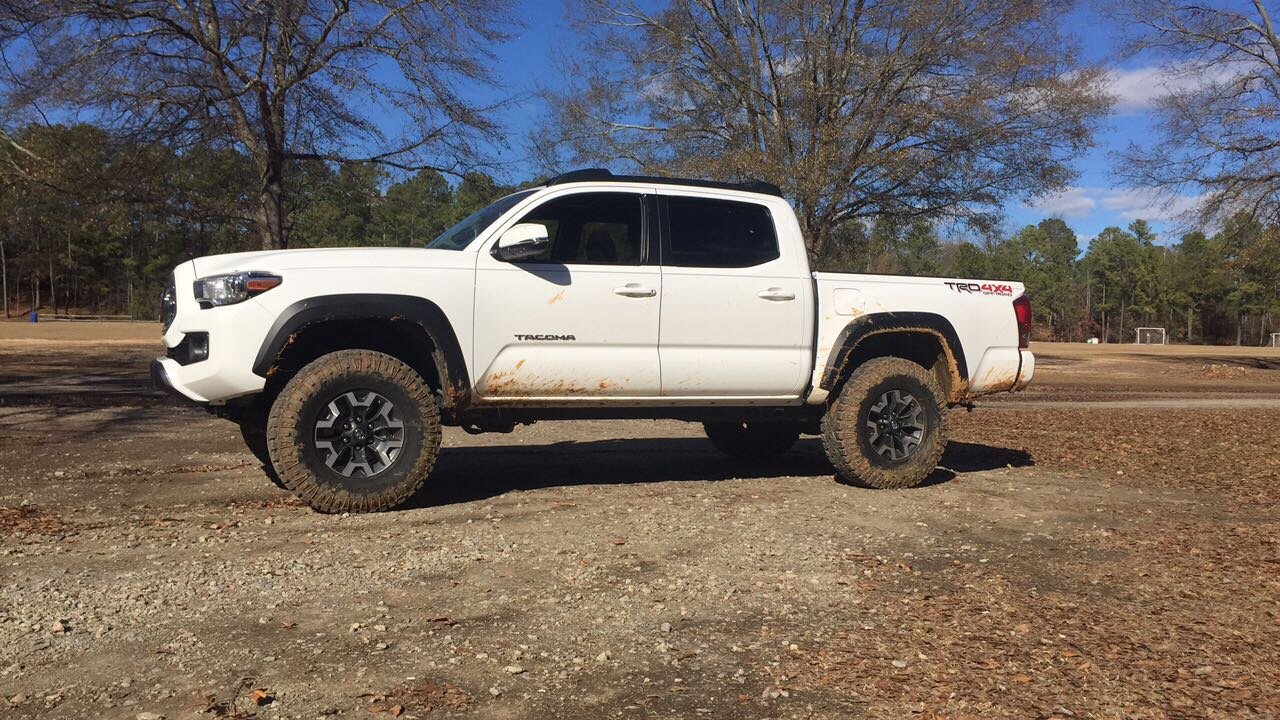

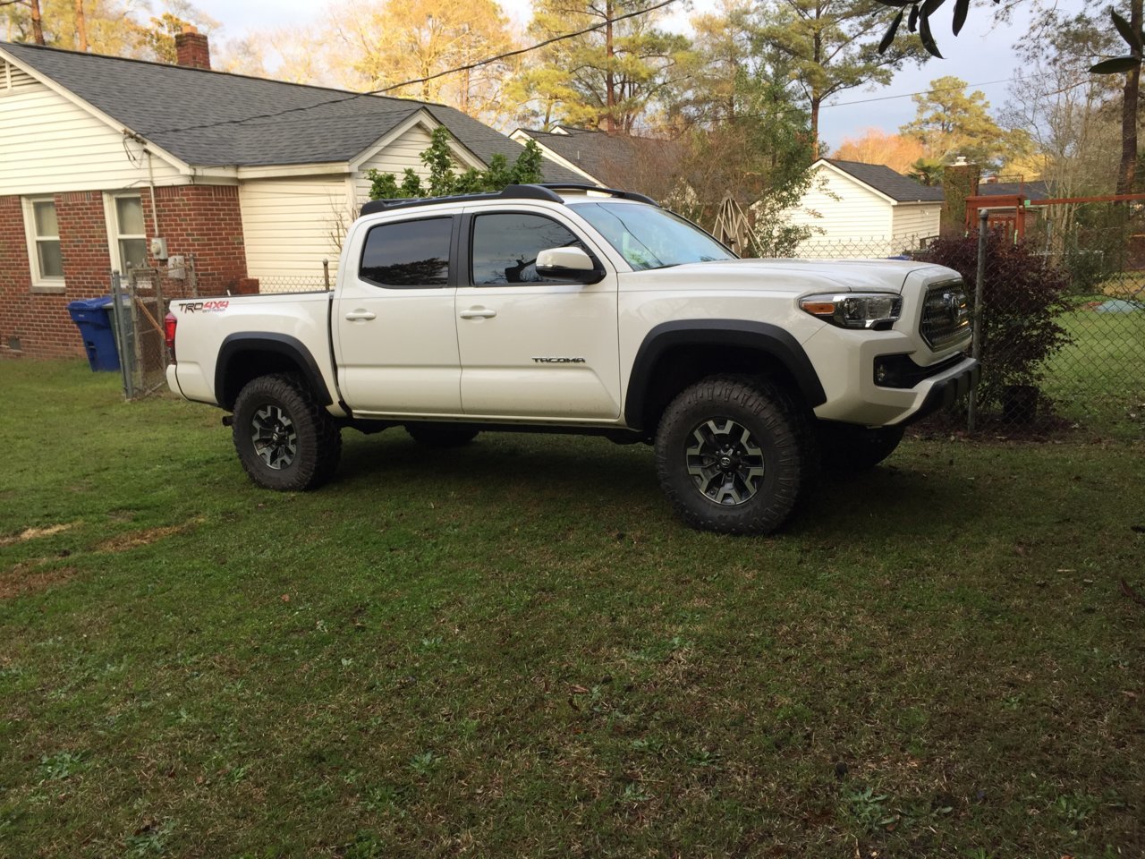

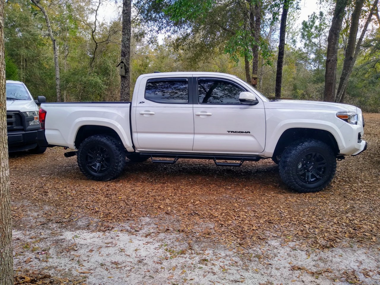

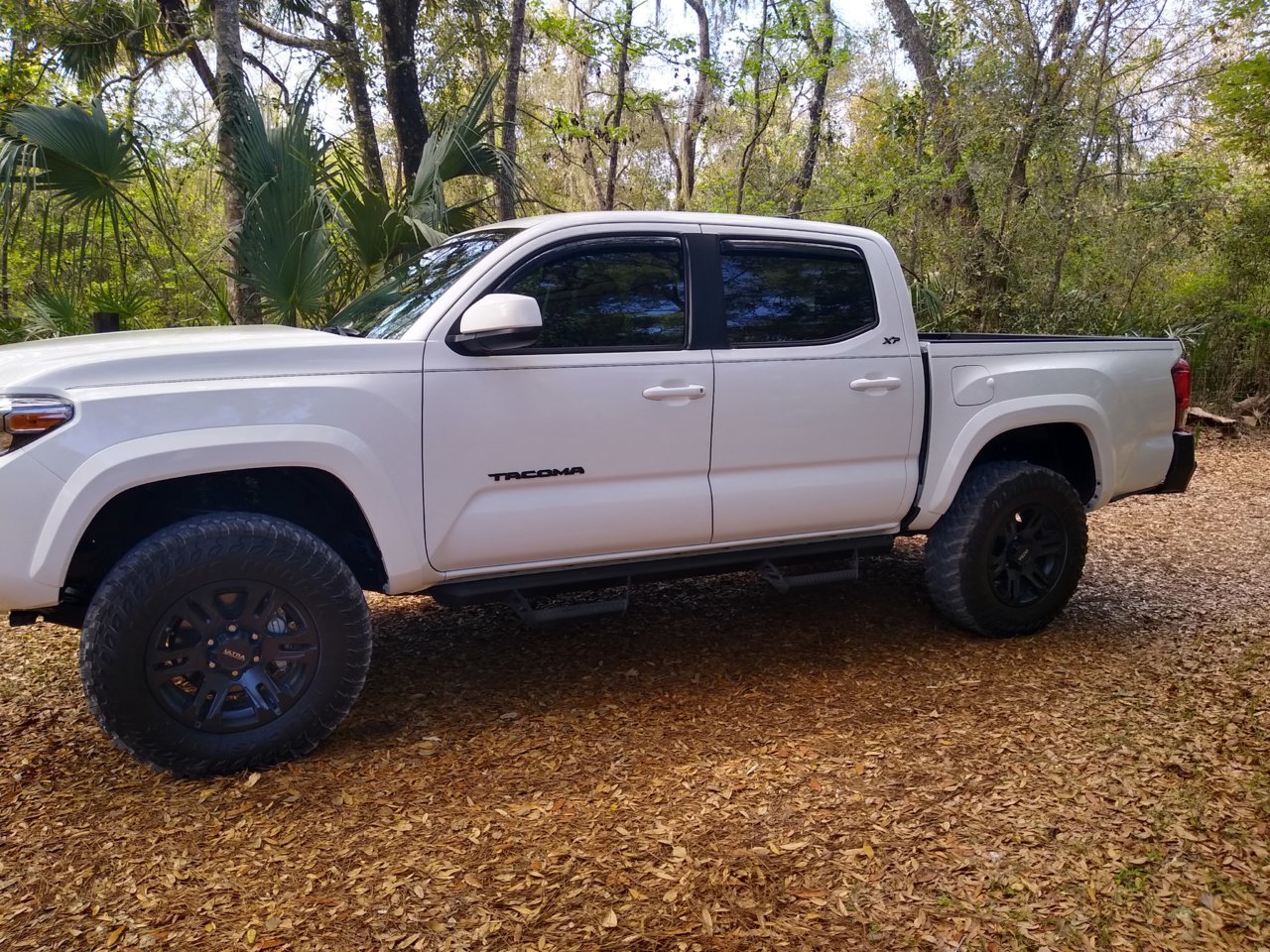

    2/1 with 265/70/17 buckshots IMG_20200315_112244750_HDR.jpg IMG_20200308_162444650_HDR~2.jpg

    Are you exactly level? I’m about .5 inch high in rear. I’m thinking about going up another notch on the bilsteins but that would leave me about .25 inch high in the front.

    Honestly never measured it's pretty close I'd say. Maybe a tad bit rakeof . think it looks fine.

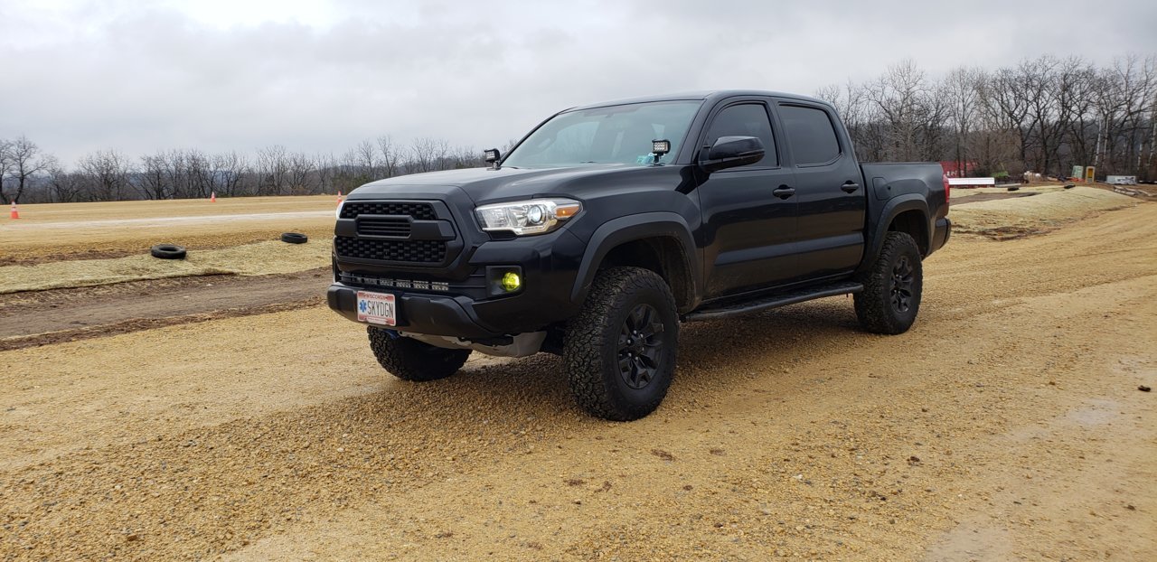

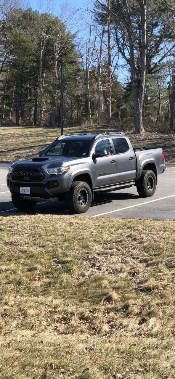

    2/1.5 with bfg ko2 265/75/r16 plus slider weight. Did supreme suspension block leveling to hold me over until adding weight is done and I'll do shocks/struts and probs at a leaf.
    Wanted some rake because I don't like a saggy back end.. I also have a bumper from at the helm waiting for powdercoating...

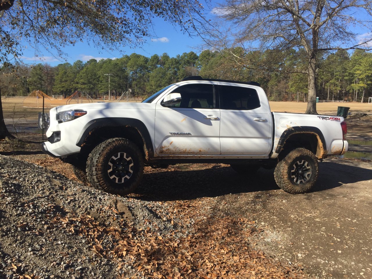

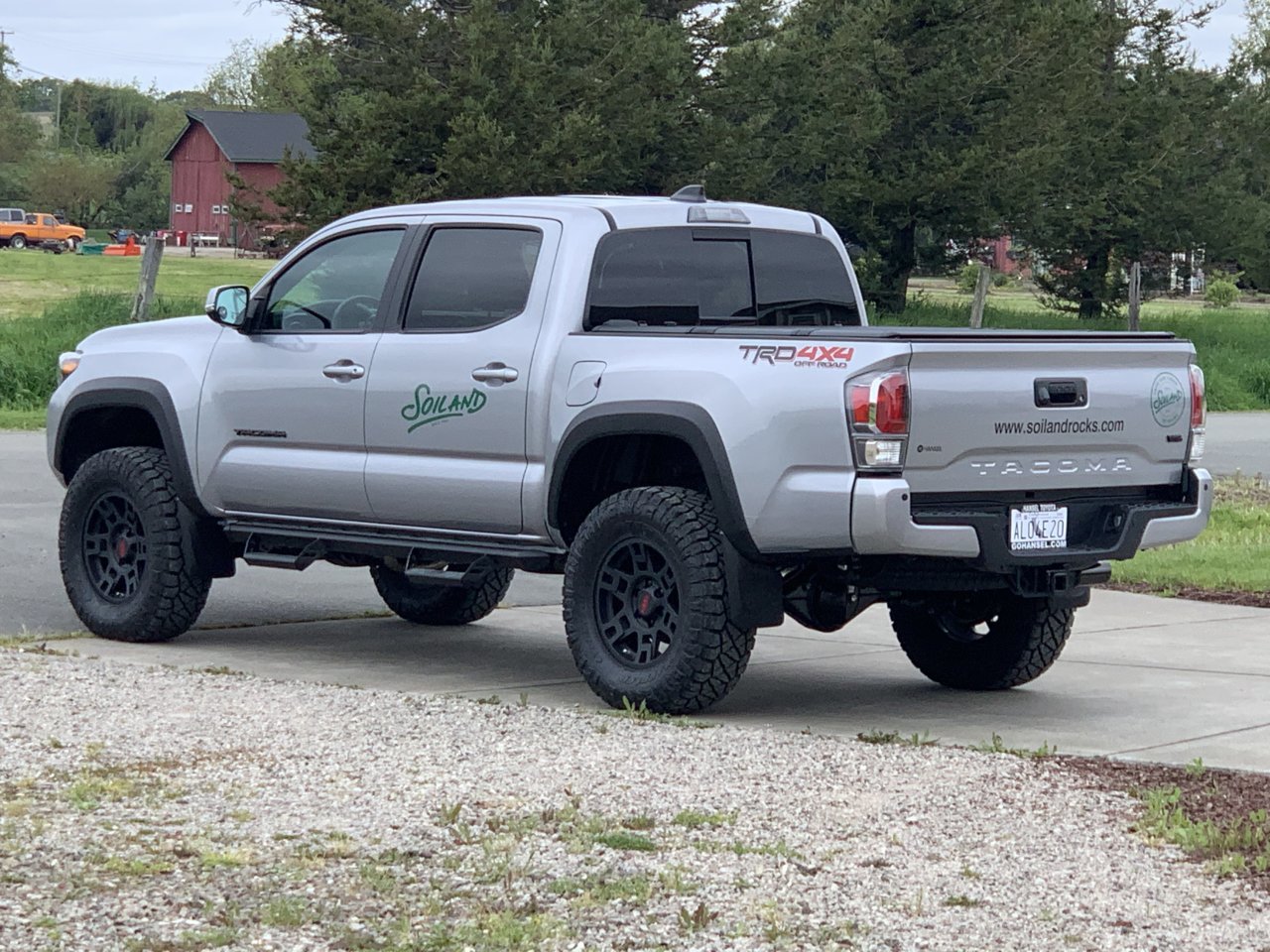

    Rugged Off-road 2.25” and 1” blocks. 285/70r17 on TRD 4Runner SEMA wheels
    This 2.25” up front with spacers. 2” block out back. Tried a 1” block and it was not raked enough for me. E0151D63-C97E-4086-9DD1-748366164F36.jpg

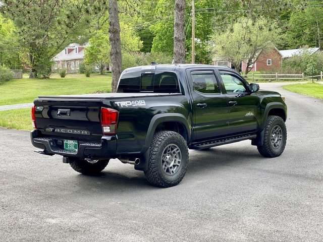

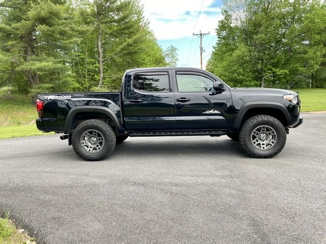

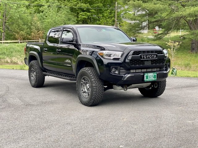

    I just did 1.75” front with top spacers and 1” rear with a block. 285/70/17 ko2 tires with 3/4” Bora spacers. It rides just like stock and just barely doesn’t run on the cab mounts.
