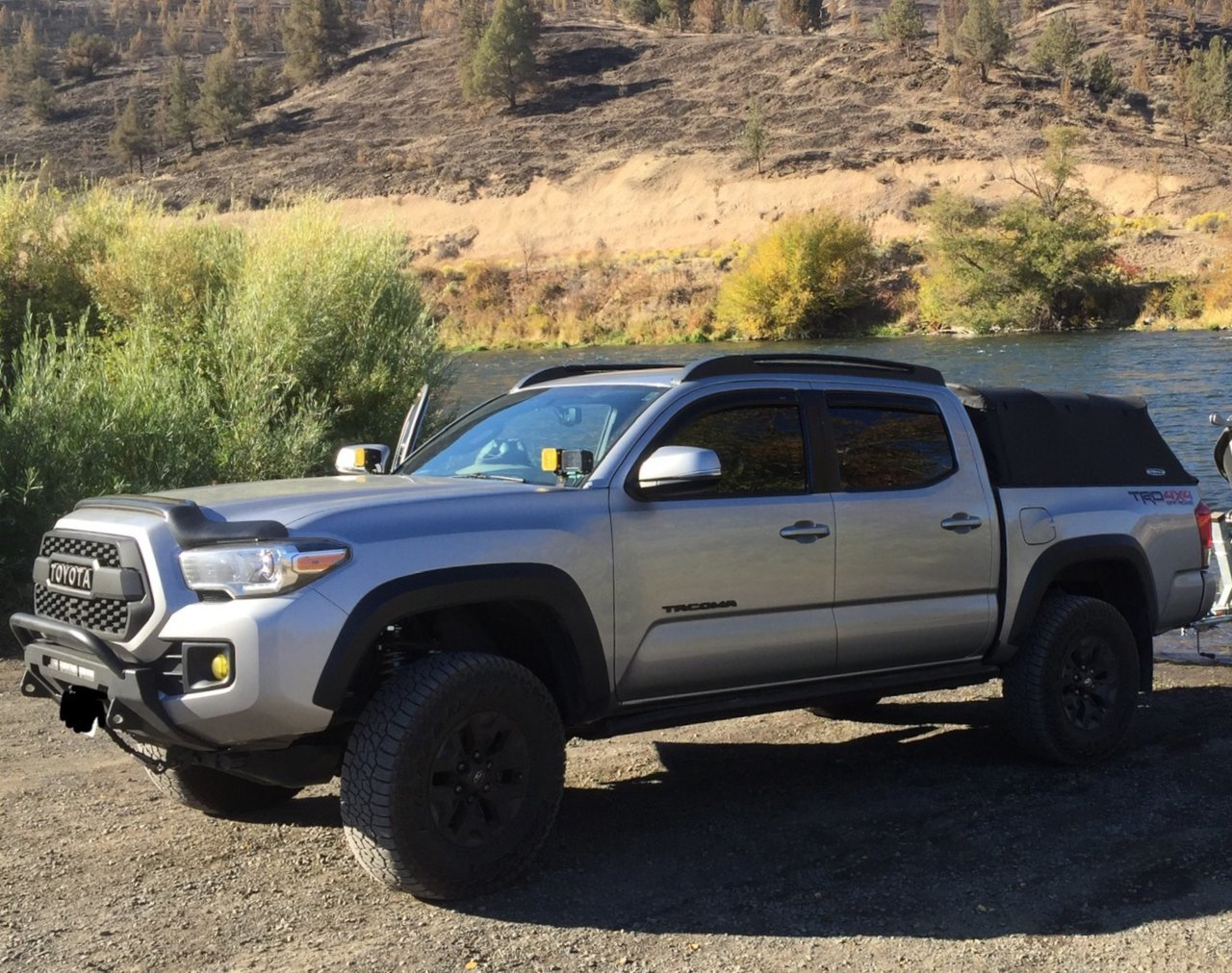

    Zyborg, what wheels and tires are you running in the photo in your signature? Exactly the look I am going for.

    I’ve been through a couple of set ups. Currently (sig pic), I am running F5s with 285/70/17 Nitto Ridge Grapplers.
