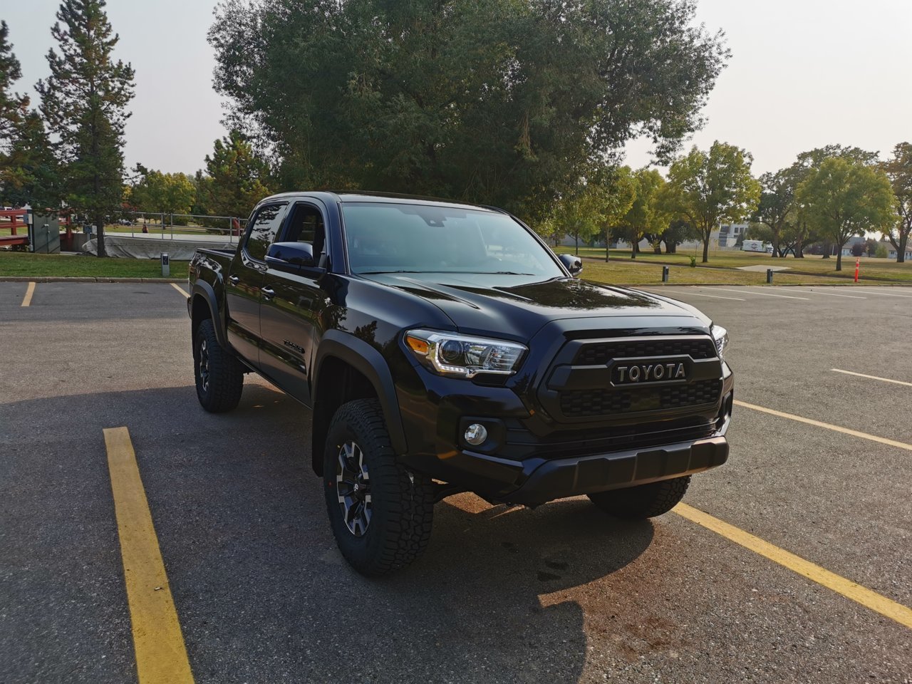

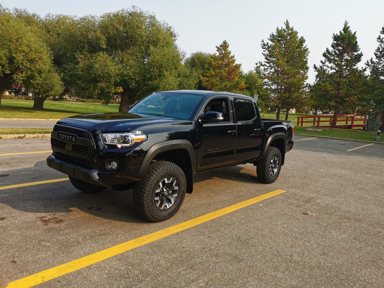

    Did a 2/1.5" on mine, added 265/75/16 Falken Wildpeak AT3, it looks a little bro leany here but it was parked on a slight grade
    The rear sits .75" higher than front measured from center caps
    MTB58, J&ATacoma, Fast1 and 3 others like this.

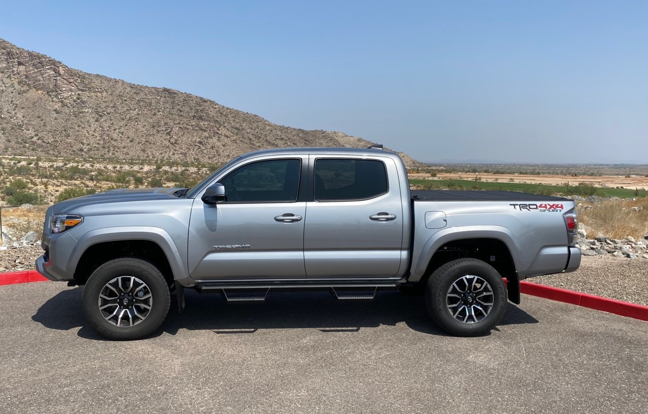

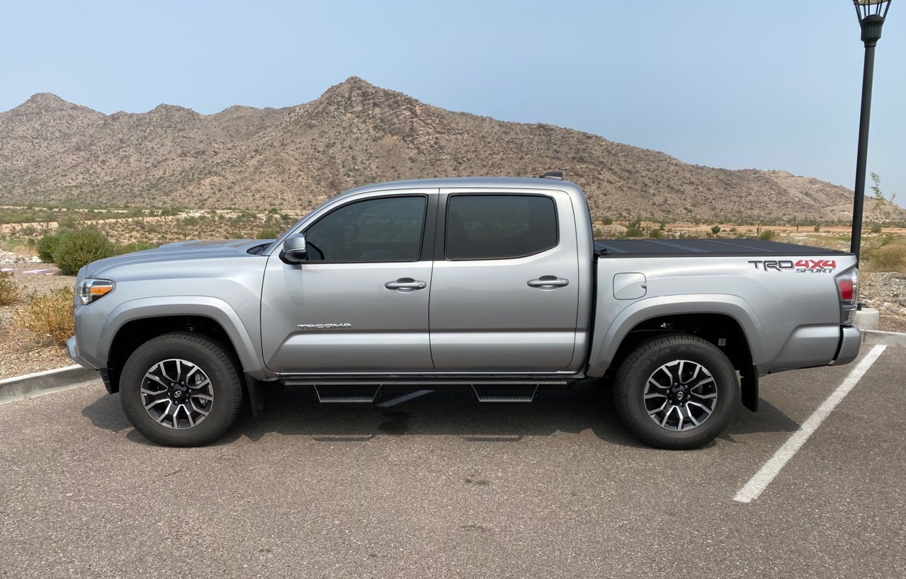

    Bilsteins 5100 all around. I said to put on the 4th perch but I'm not sure if they did. I also did the toyota tech 1.5" Add a leaf. Parts total was about $500 and Desert Rat Off-Road has the 5100s in stock and on sale. I did not do any other mods...no diff drop, 1/4" spacer, etc....Stock I was 35.5" in front to fender and 37" in back to fender. I am now at 36.9" Front and 38.25 in the rear. The rake is fairly close to factory still and no visibility issues. No vibrations on the freeway and no taco lean that I've noticed. Overall I'm pretty pleased with it. Now to add some 275/70/17s on SCS SR8's and I'll be right at 2.5" taller then stock which was my target. I really couldn't tell the difference on the ride home either...seems very nice. I think I like the ride a little better actually...the Bilsteins are better then the factory shocks.

    Thanks! Honestly you were the inspiration to do the 5100s after seeing your posts several times. Even did the Toytech add a leaf since I thought that is what you said you did.
