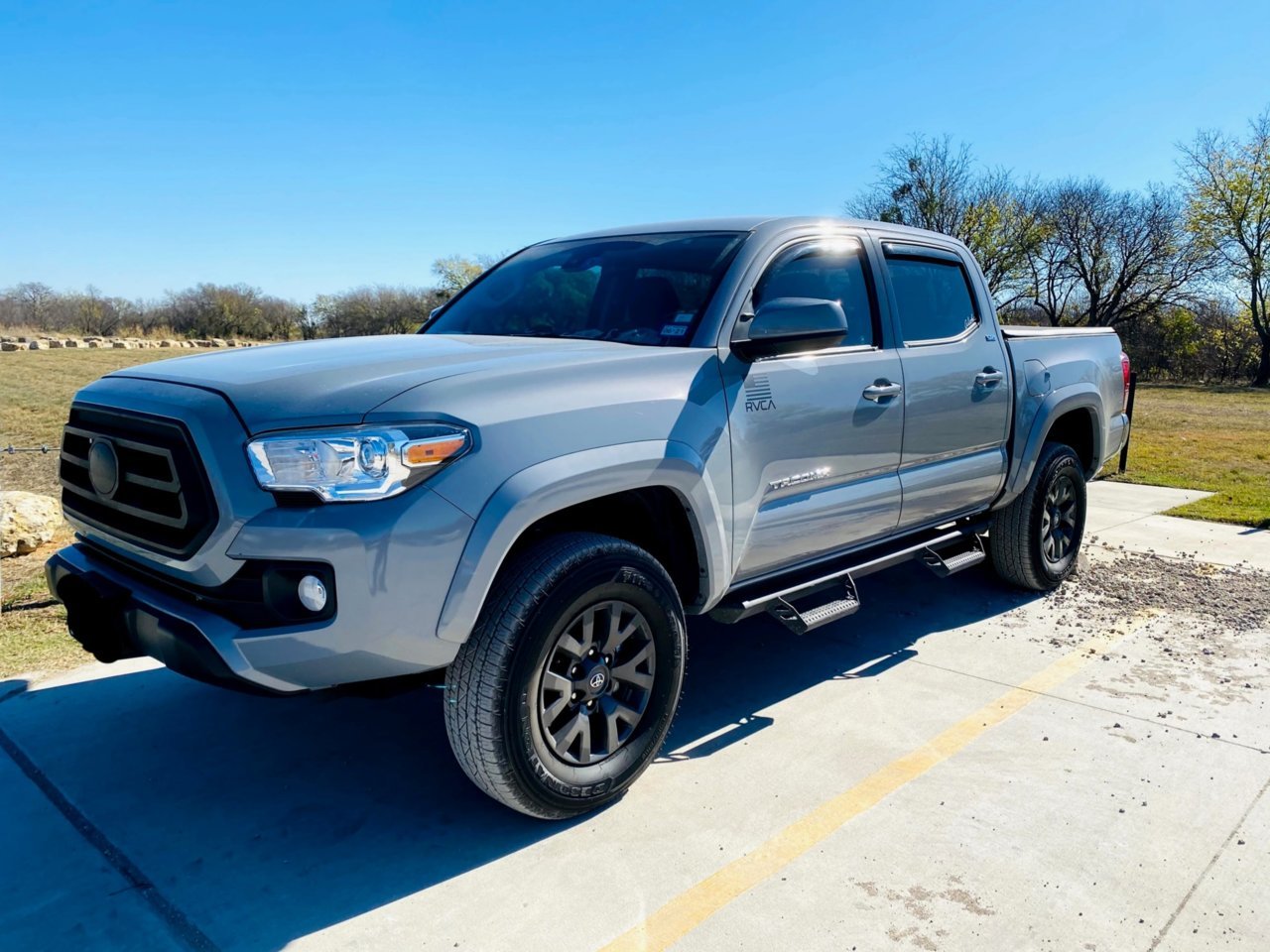

    Got the lift installed yesterday,1 1/2” front and rear,and new Wildpeaks on this morning.265/75r16

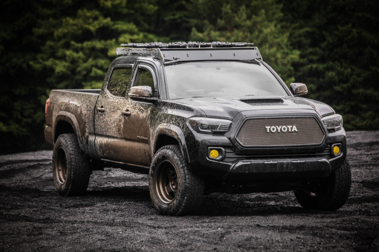

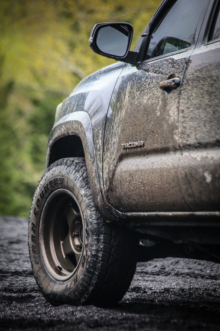

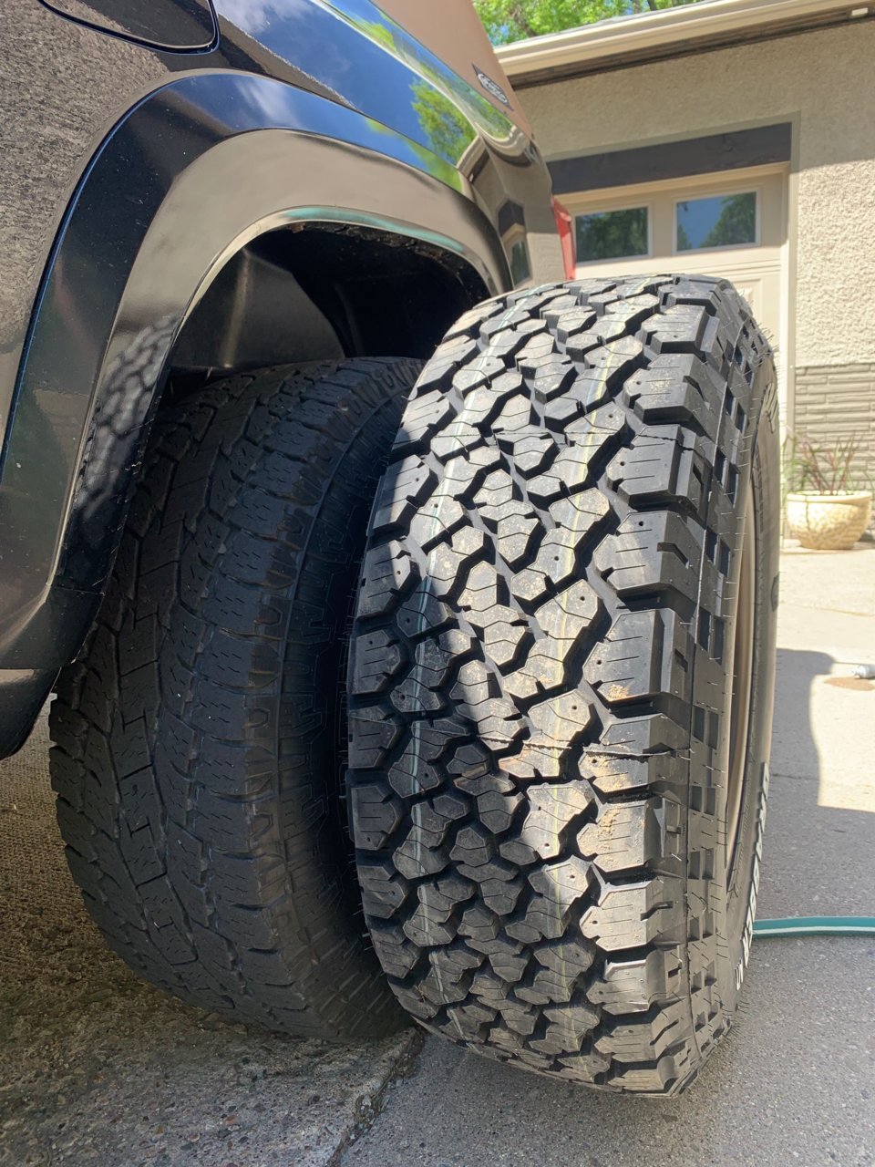

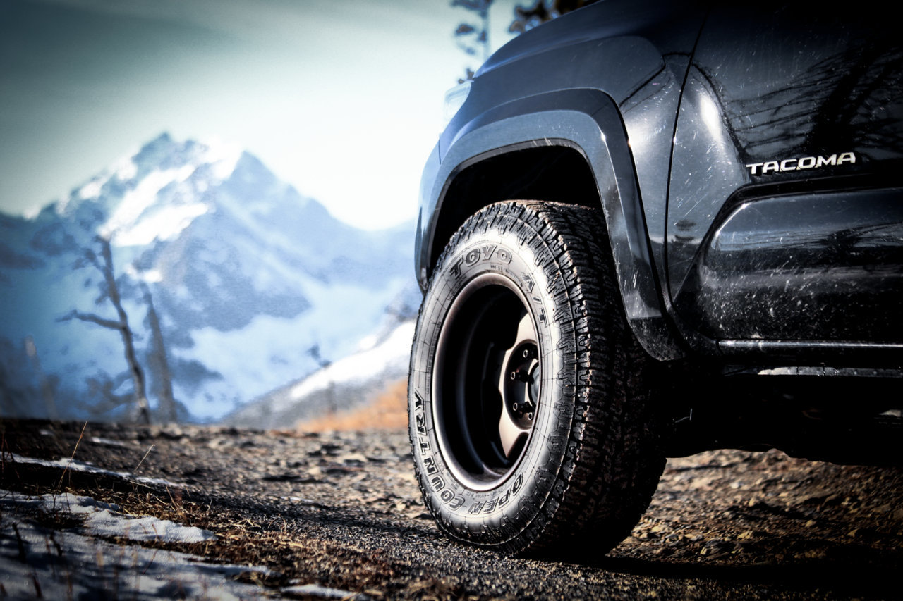

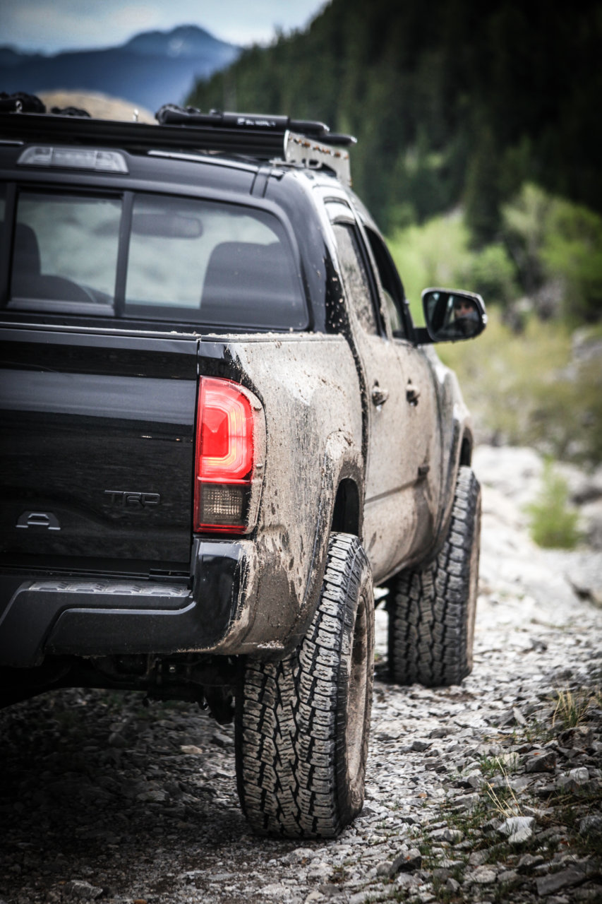

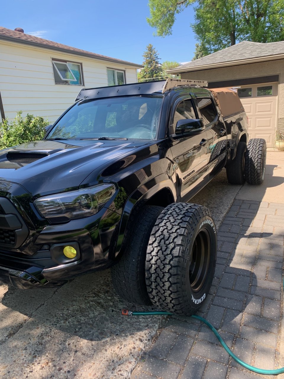

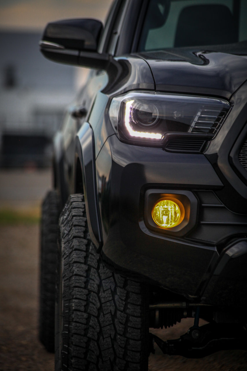

    Much appreciated! Sure will, and to stay on topic (lol) I did order this very setup and am waiting for the lift to arrive. Loooong wait, backordered till late August. In the meanwhile I picked up a set of 5 General Grabber ATX 285 70 17's. What a step up from my current tires.

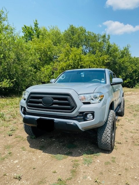

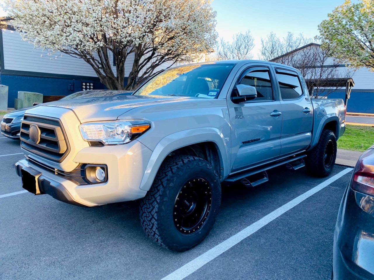

    Stock Height With 17x8 0 Offset Method Wheels(No Rub)IMG_2428.jpg IMG_5379.jpg
    After pics with 2/1 Inch lift With 1.25 Spidertrax

    Looks great! What size tires?
  10. Jul 22, 2021 at 8:30 AM
    #690
    J&ATacoma
    J&ATacoma Member
    Nov 23, 2020
    #347629
    15
    Joseph & Apple
    2020 Cement Tacoma SR5
    They are 265/70r17

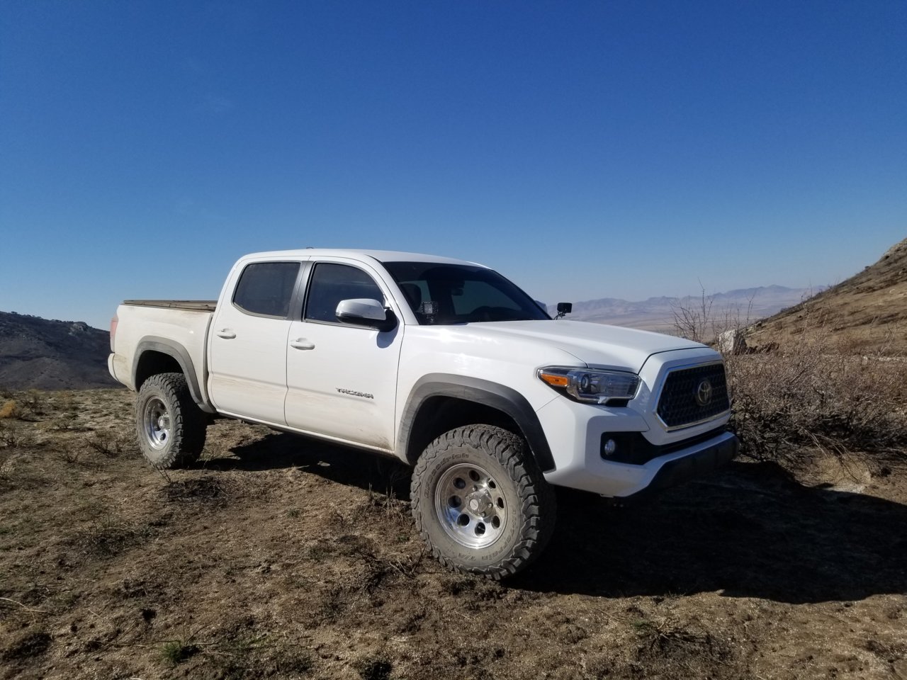

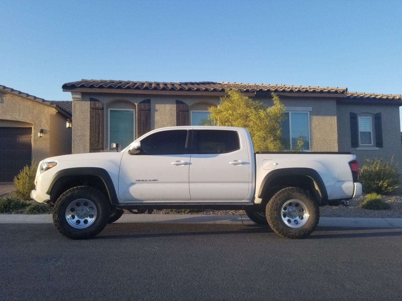

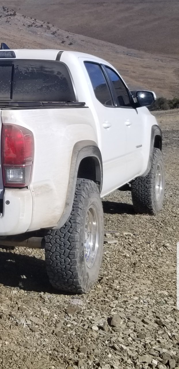

    1.5" Eibach springs, 1.5" Icon add a leaf, Bilstein 5100 shocks, 1" rear blocks.
    The rear settled to 1 1/4" higher than the front. When I first put the blocks in it was at 1 1/2" rake. The blocks are 1" steel non tapered. I forgot the brand. Ride is great.

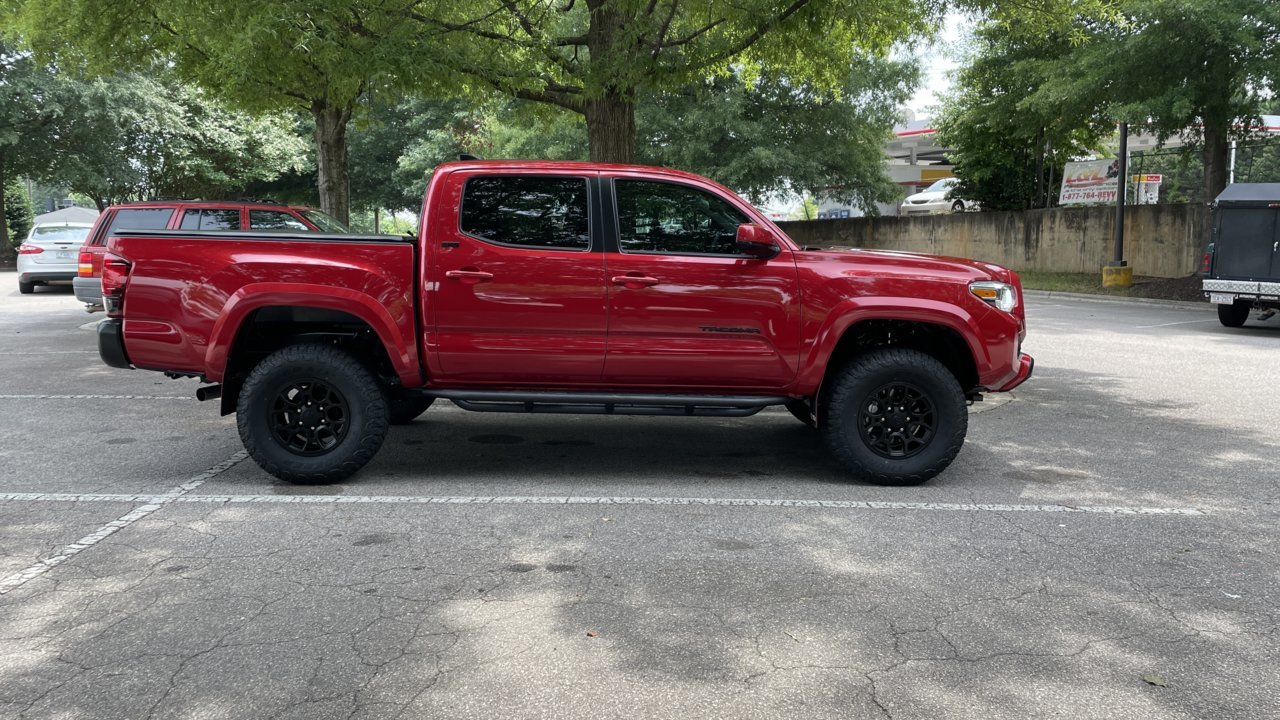

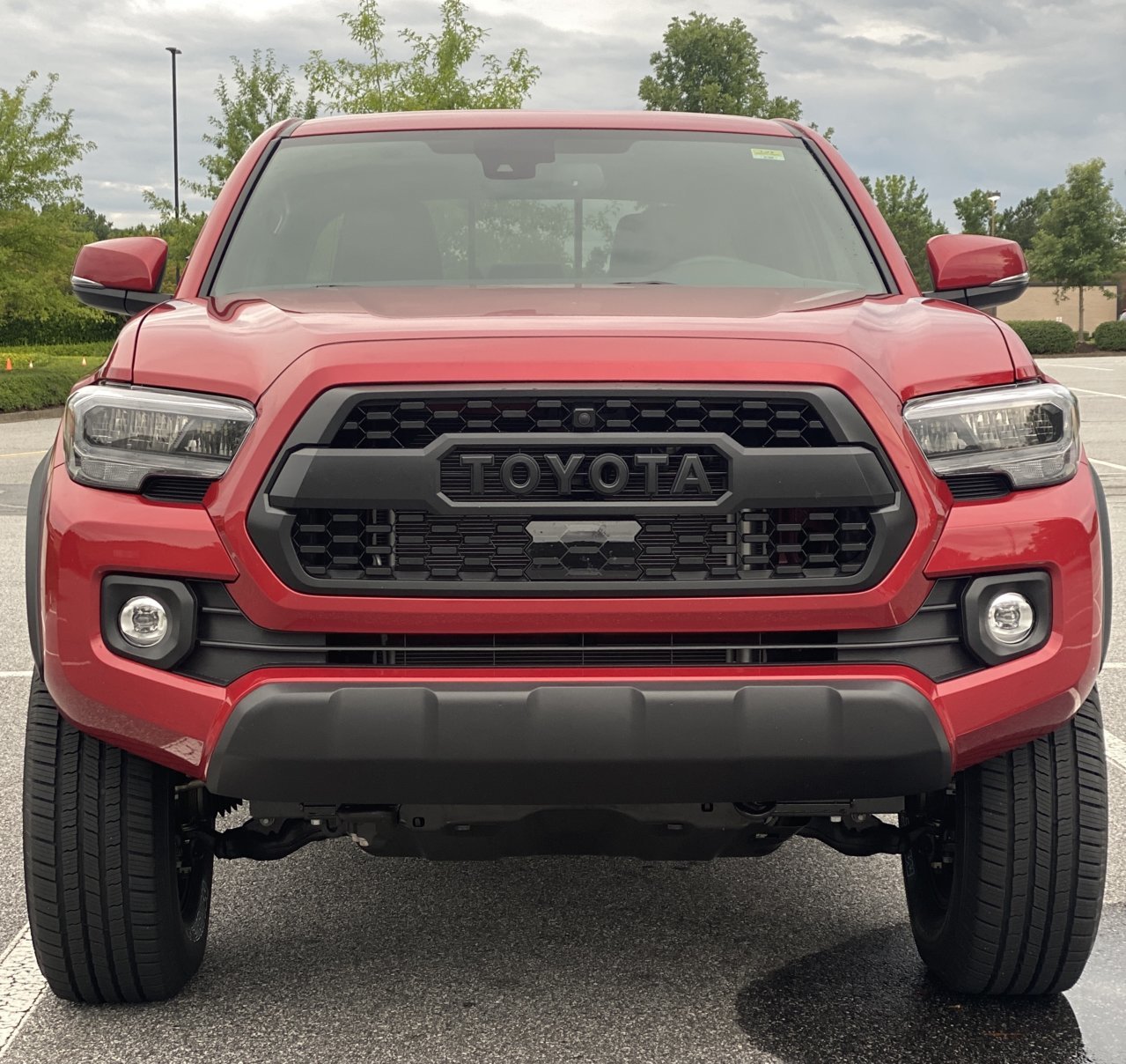

    TRD Lift Kit on mine - 2” front / 1” rear.

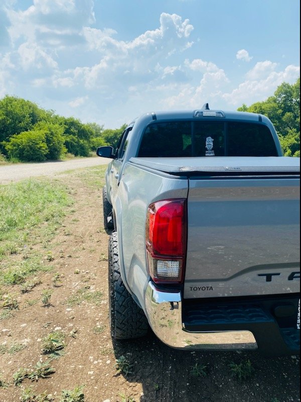

    2/1 on 16x8 with 265/75/16

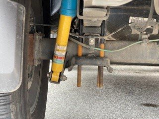

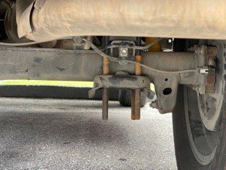

    With the 1" block in the rear, do you use the OEM u bolt? My friends came supplied with the u bolts that are too long in my opinion and is sticking out in the bottom about 2"-3" I think. And I am thinking that the company she bought it from just uses the same u bolt for their 1", 2", or 3" lifts that's why on the 1" blocks it looks way too long. I was wondering if I can put back the OEM u bolts with the 1" block.

    cut em down

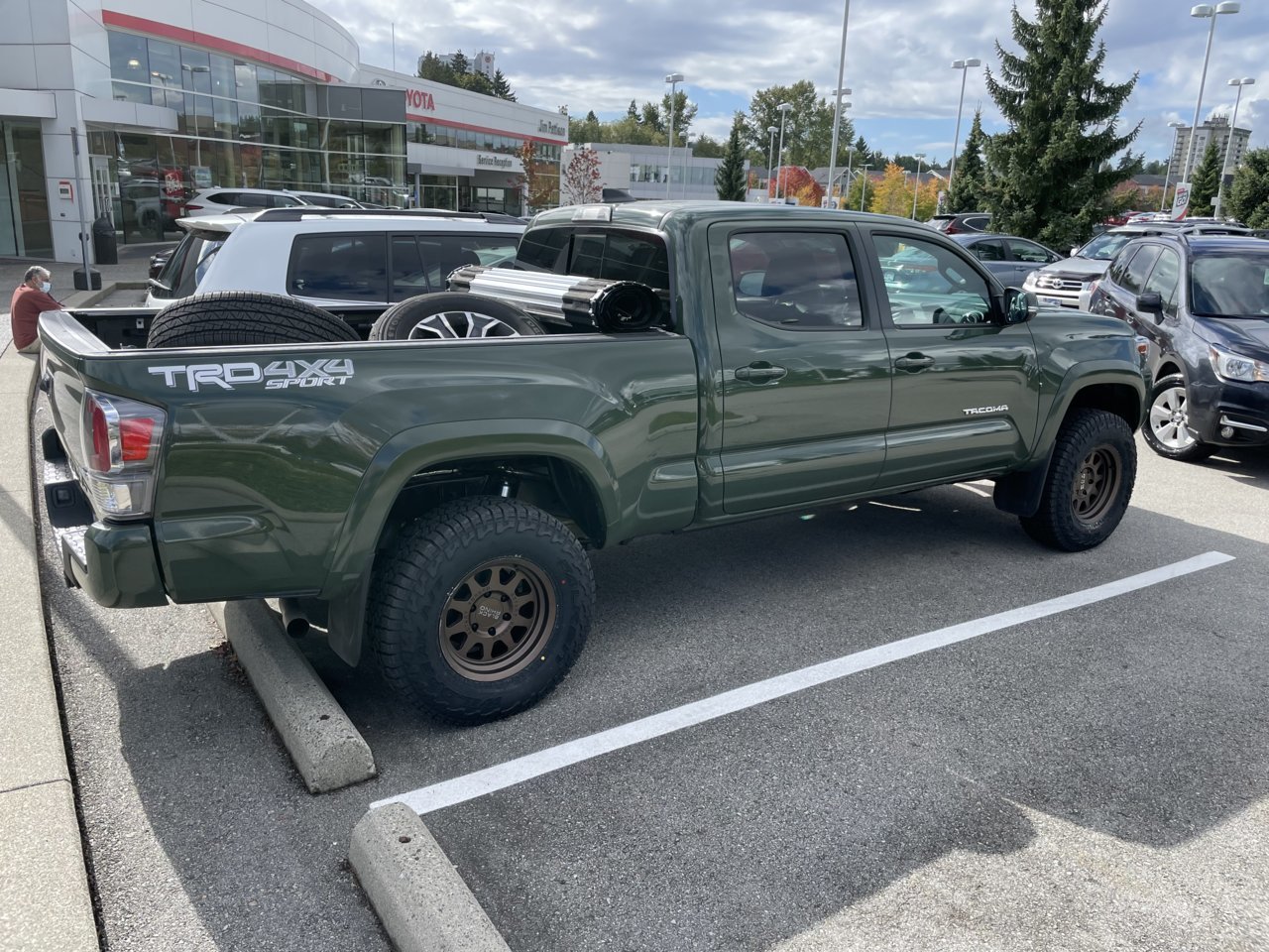

    Eibach lift. Around 2” up front and 1” block in back
