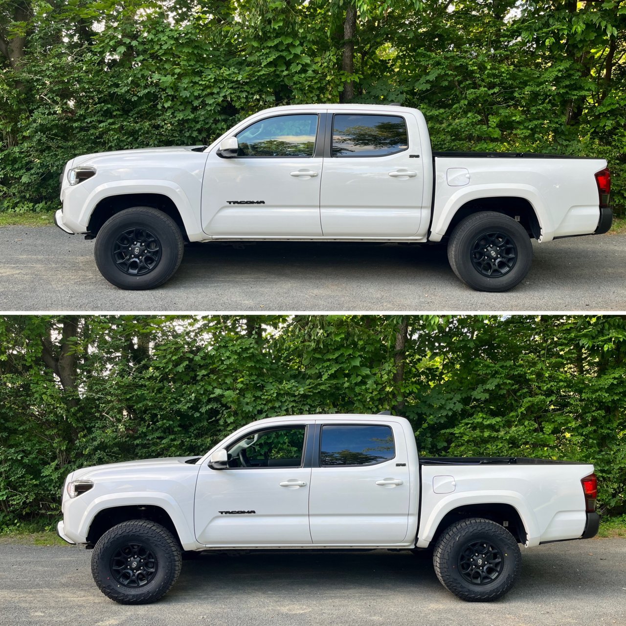

    Here’s my 2020 SR5. Top picture is stock bottom picture is with supreme suspension 2/1 kit and 265/75/16 wildpeaks. 9E6DEFF4-CEFE-47BE-8BCA-9BAA873DDFEA.jpg

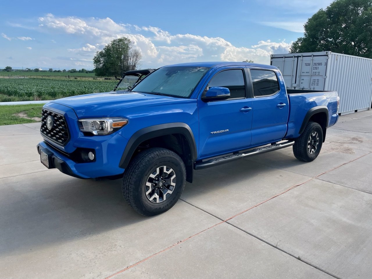

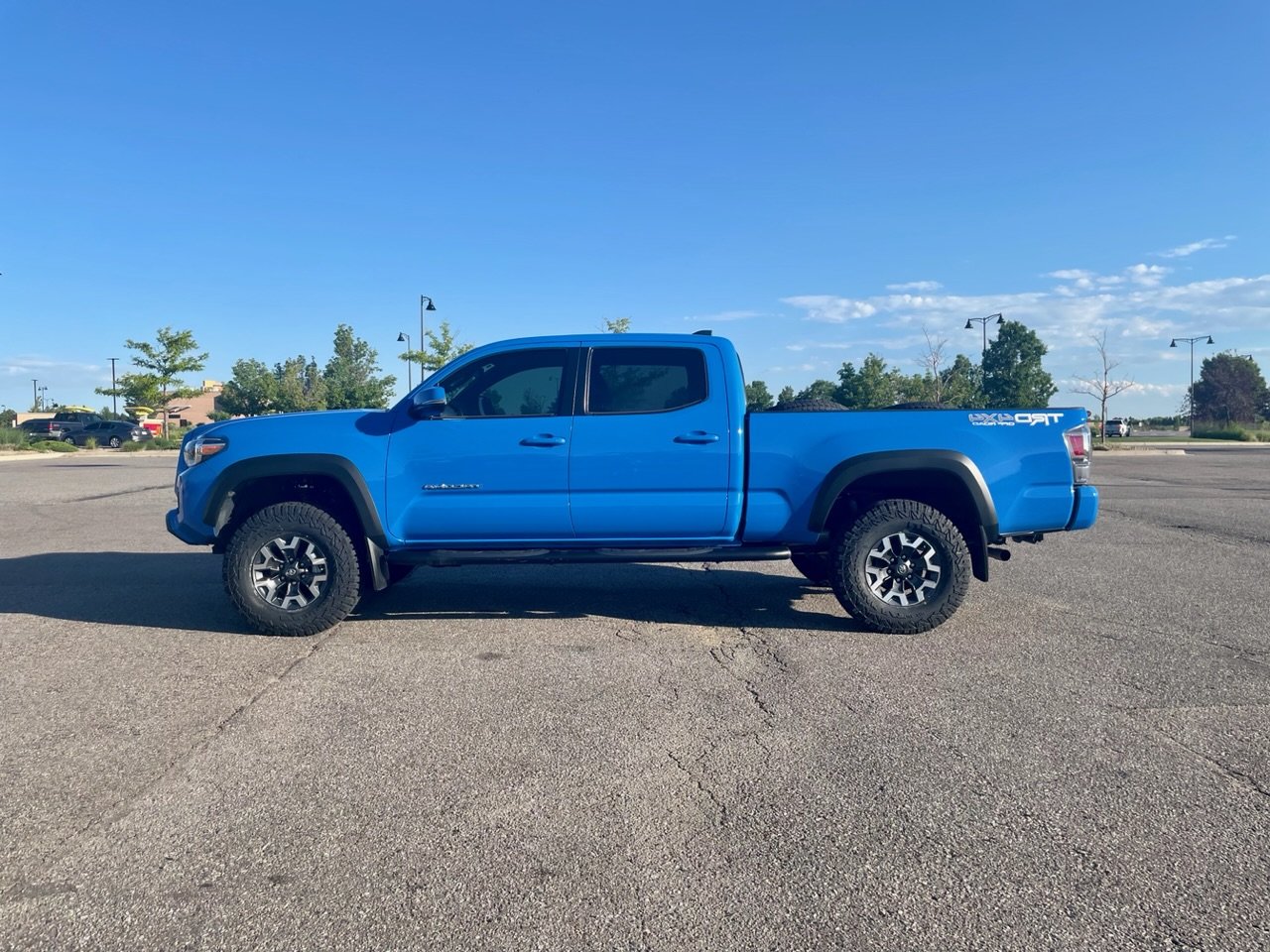

    2”/1.5” - 265/75R16 - FALKEN WILDPEAK R/T01

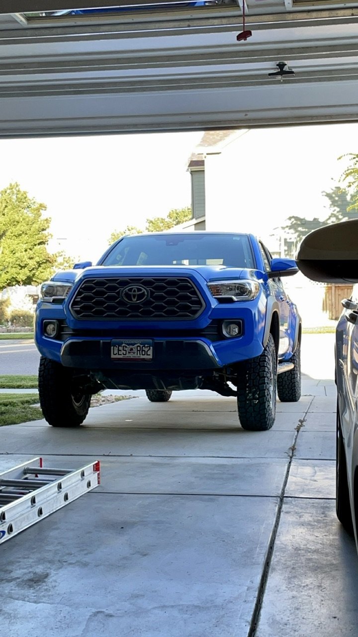

    Been scrolling this thread for a long time and finally did something about it.
    RC 2” leveling kit / RC 1.5” lift blocks (these are tapered) / Don’t forget: Universal U-bolt kit.
    1:Stock / 2:Lift / 3:Tires (265/75R16 Wildpeak R/T01)

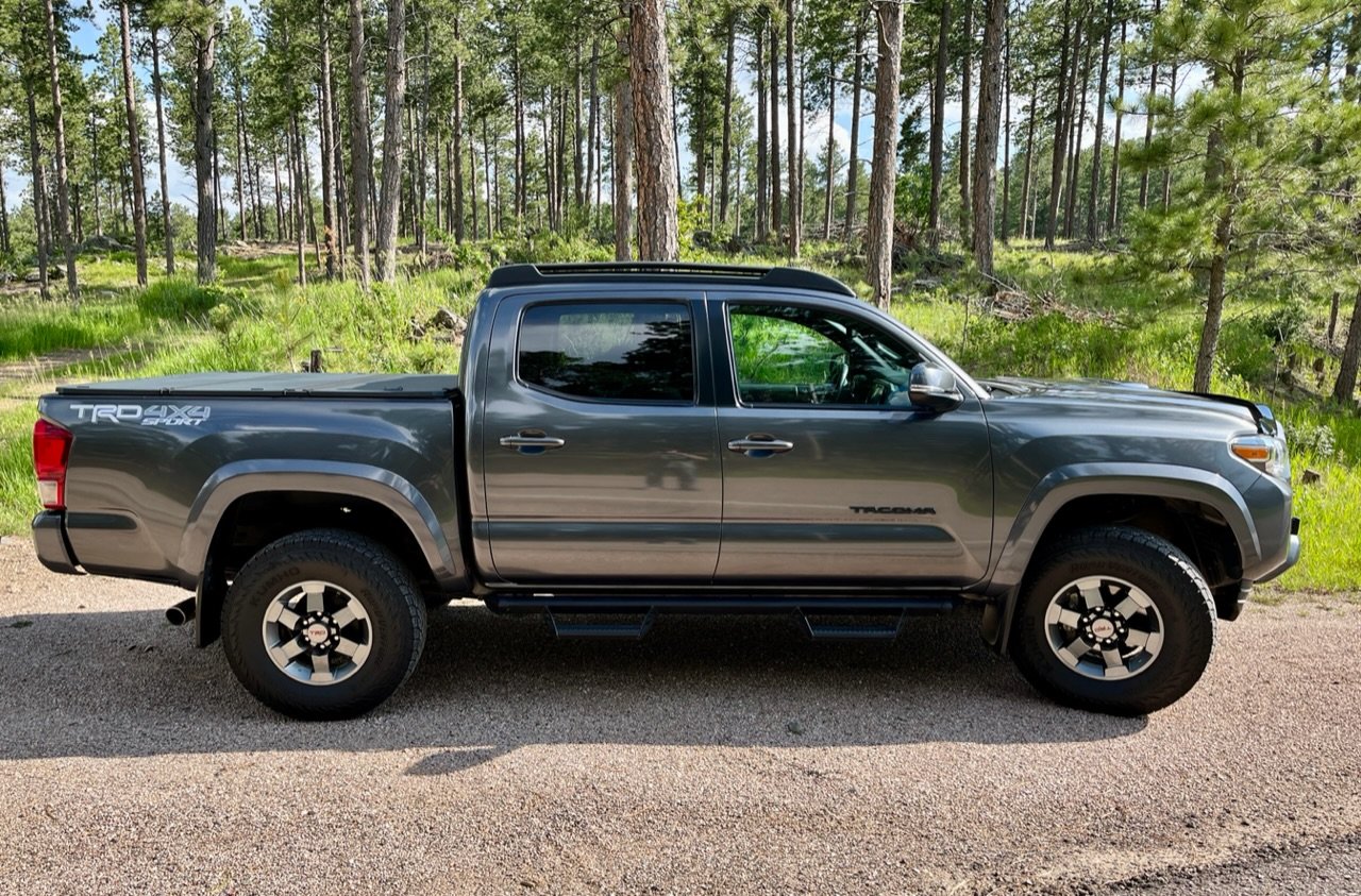

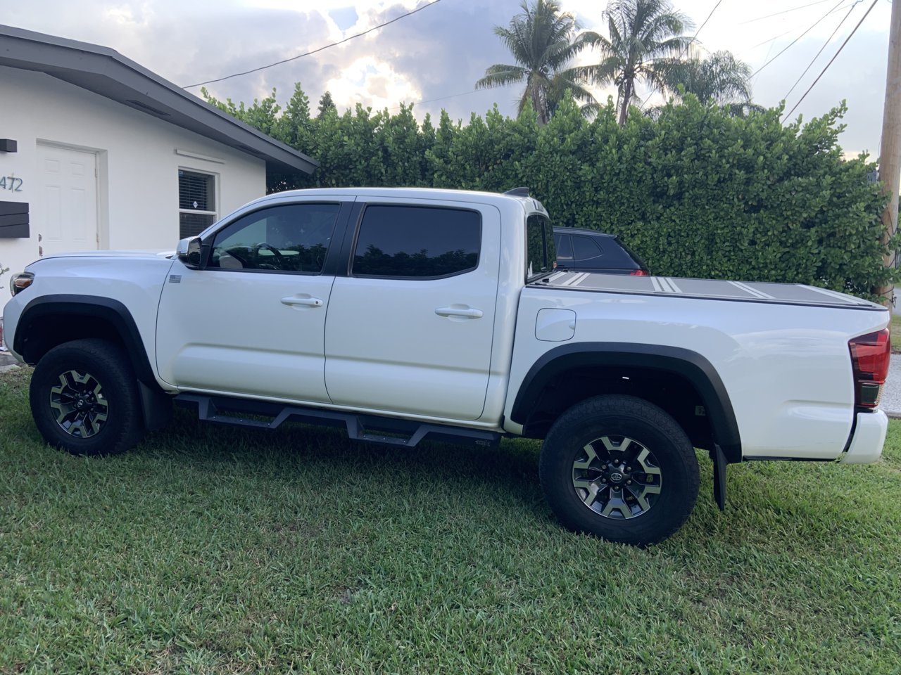

    My 2017 now has 1 inch blocks in rear with 5100s in front. I have about 1 inch of back to front rake which I prefer. I have P rated 265/75/16 tires. I like look and feel. IMG_6872.jpg

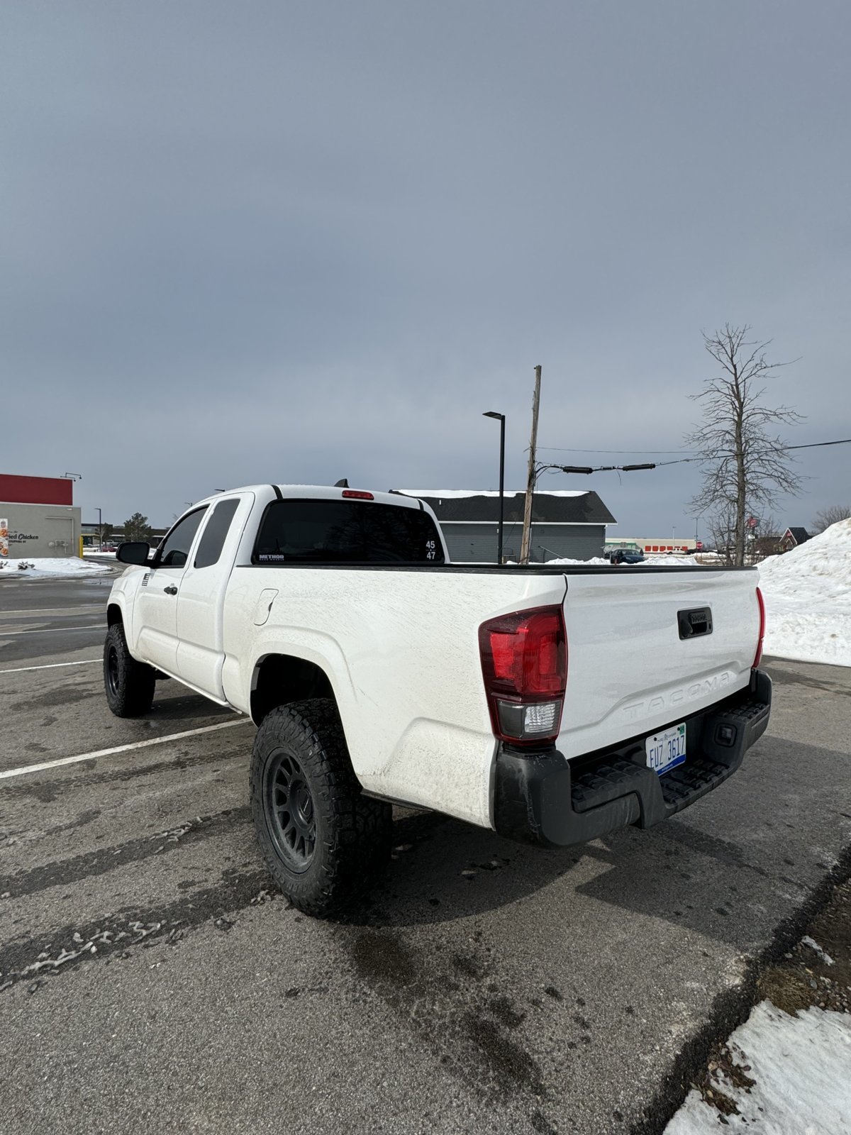

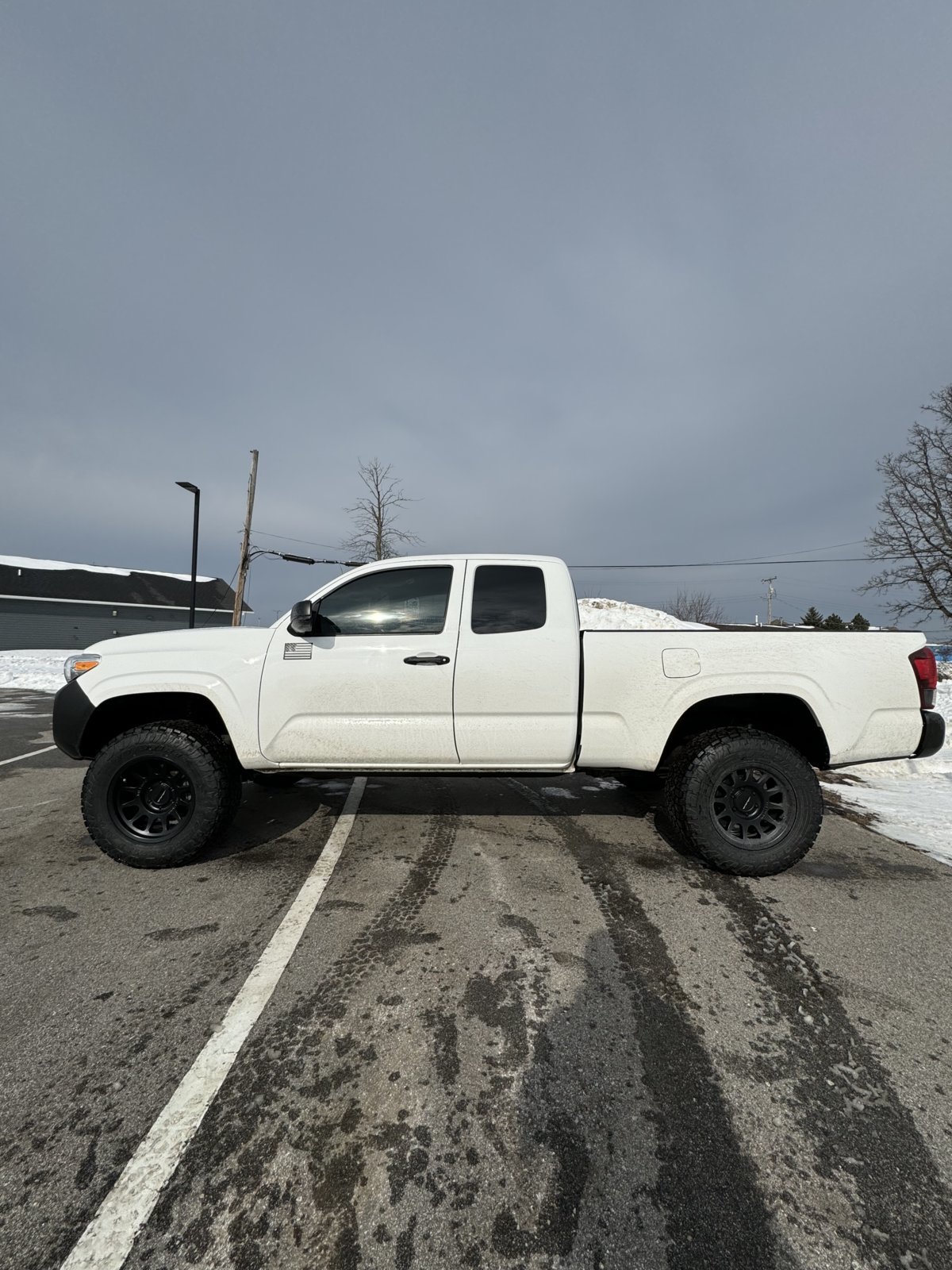

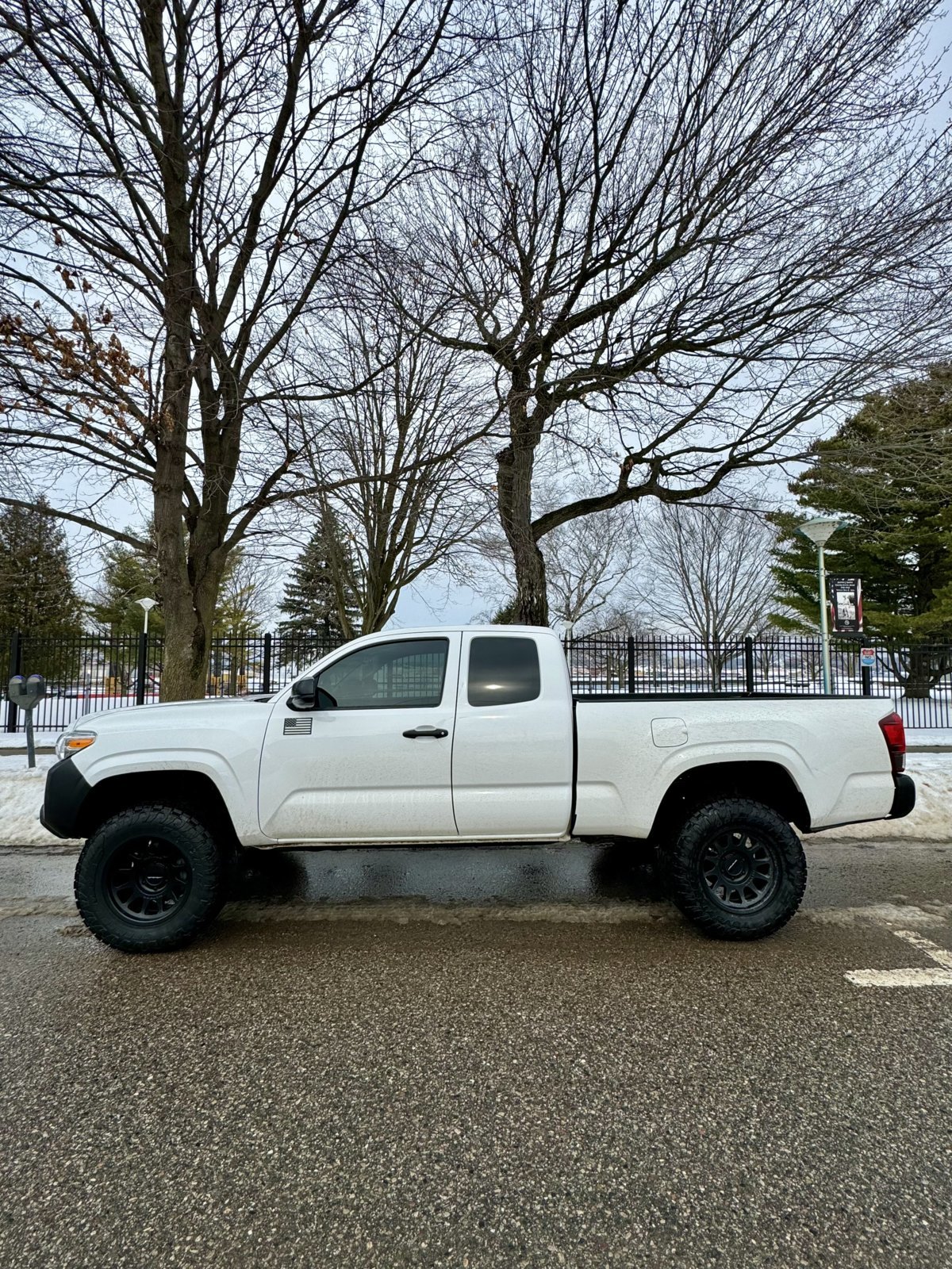

    2/1.5 spacer and block. Hate away, cost me a whopping $100+$60 for the alignment. Can’t beat it

    Looks great! What kit did you go with? And can you link it please

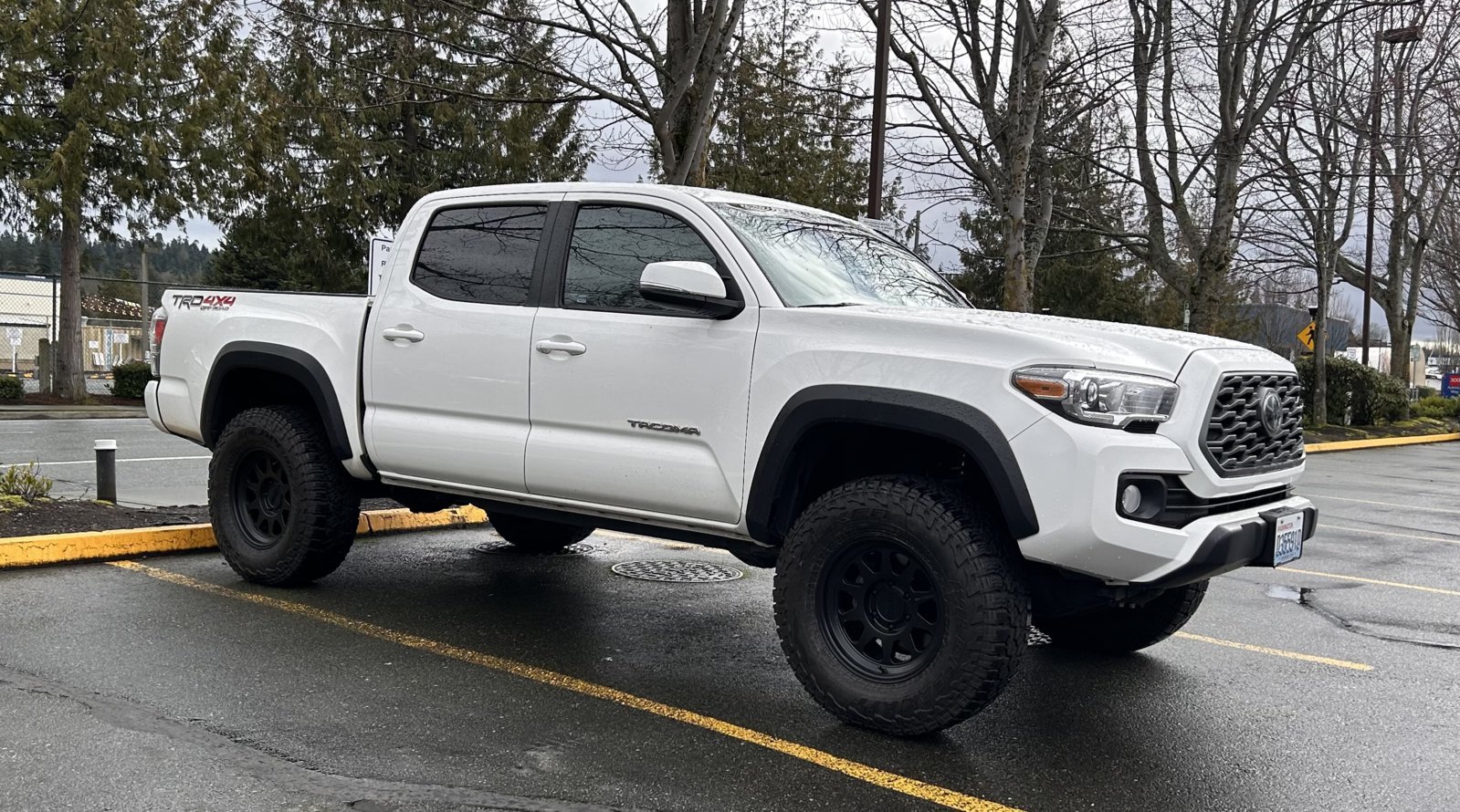

    2/1 lift. 6112/5160 with 1” block in the rear on 285/70/17s

    What settings are you on? Thanks!
  15. Mar 21, 2024 at 2:47 PM
    #775
    cahzbrah
    cahzbrah Well-Known Member
    Apr 3, 2015
    #152462
    327
    Newcastle, WA
    21 TRD OR 6spd
    11/9

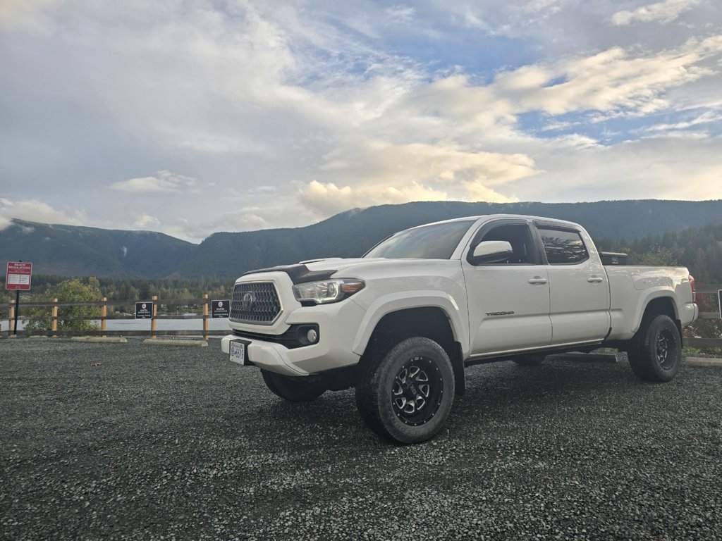

    Rub?
  19. Oct 16, 2024 at 5:56 PM
    #779
    Van_island
    Van_island Well-Known Member
    Sep 5, 2023
    #432887
    95
    Isaac
    2019 taco
    Just got it out of the shop. 2" in the front 1" in the rear.
    I went with the bilstien 5100 on all four corners. Kept my factory spring. I got a 1" block in the rear end . And also had the needle bearing replaced with the ECGS bearing instead, no vibrations driving the 100km back home from the shop,
    now I have to decide on tires.. I have the Ray10 17×8.5 -10 wheels with the 4.30 backspace hope i can run a 265/75R17 but we shall see.

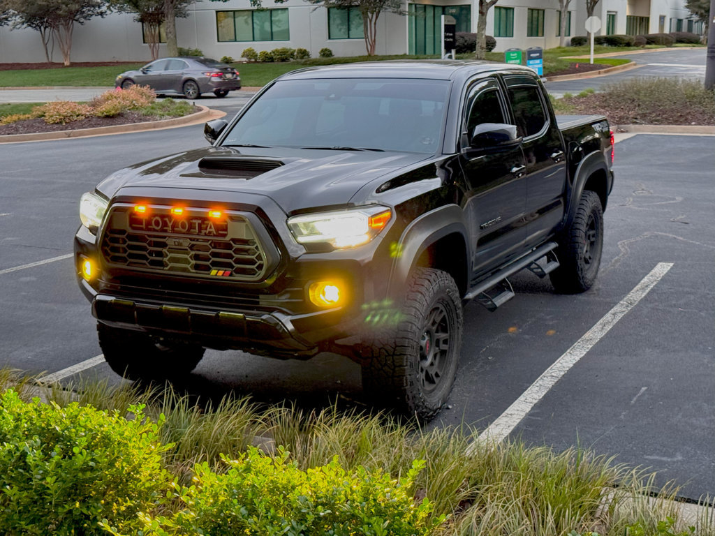

    This is a Bilstein 5100 with the setting on the top notch (2") and a 1" block in the back. I'm on TRD SEMA wheels that are 17 x 7 with a +4 offset, and 275/70R17 Falken Wildpeak AT4's. I was able to keep the mudflaps after a proper alignment and the truck rides great.
    Until about 3 weeks ago I got side swiped on I-285 on a rainy night in Atlanta, which blew a tire, took out my mirror and scratched the heck out of my fenders. I got some matte fender flares and luckily bought the extended warranty on the tires so that was replaced for $40. But the mirror has the 360 camera and all that, so it cost me $617 to replace the mirror from BAM wholesale.
    I also tinted the windshield 50% and put a 5% strip on it. I love the feeling of privacy over the fishbowl.
