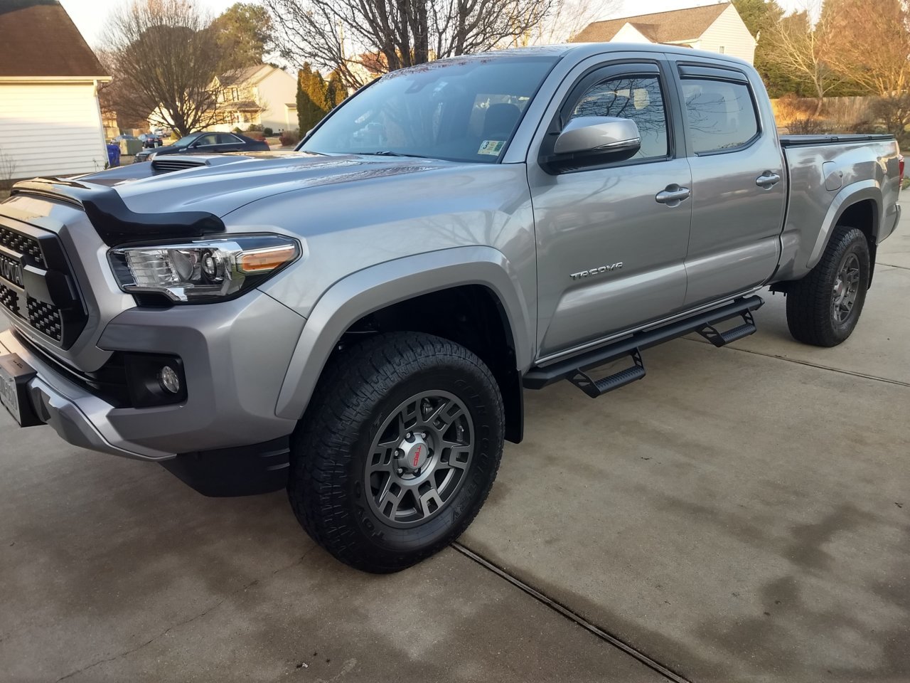

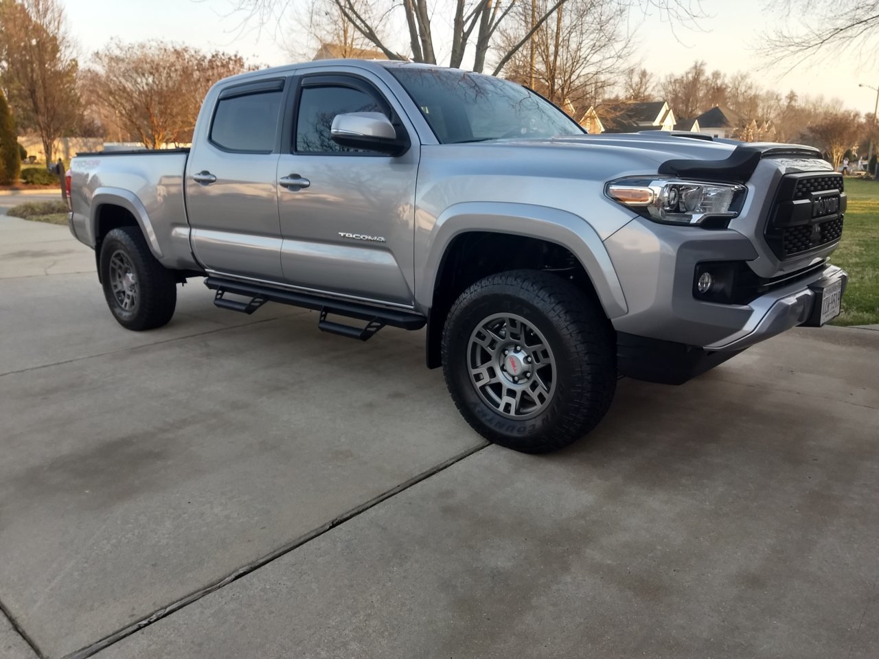

  4. Mar 2, 2019 at 2:02 PM
    #84
    VaToy
    VaToy Life Long Member
    Mar 26, 2018
    #248467
    4,745
    Parts Unknown
    2018 TRD DCLB Sport 4x4 Silver Sky
    Bilsteins 5100s on the top setting, 4runner Gray TRD Pro Sema wheels, 285/70/17 Toyo AT3s, Sumo Bump stops, TRD exhaust, ECGS Clamshell bushing, 1/4 shim for the lean and one inch rear block, OEM Pro grill and garnish OEM TRD Skid plate, TRD CAI, Demon Brackets, Rigid Industries Pro fog lights, OEM Trail Rails sidebars, Diode Dynamics LED SL1 high and low beam lights, OEM Roof racks, Clazzio leather heated seats, Remote Start, TRD Pro shift knob, tinted windows, Rockford Fosgate 4 channel amp for the headunit and sub and amp combo, OEM Puddle lights, OEM tailgate lock, OEM bed mat, LED interior lights, OEM blackout kit for letters, JLT catch can, upgraded 27F toyota True Start battery, Vleds led tail light kit with Pro tail lights, OEM Rave4 side mirrors with convex spotters,just to name a few mods.
    5100s front and rear, set on the 4th perch, one inch block in the rear, 1/4 shim for the driver's side for the taco lean, ECGS clamshell bushing to replace the needle bearing. I did the bushing for a preventive maintenance and didn't want to get a vibration. Allignment was perfect and I m on stock UCA and stock sport springs. The ride is cushy, don't let them tell you need new coils because Bilstein designed the 5100s for stock coils. My truck rides better than the stock sport shocks. I then added some Toyo open country at2 SL tires on some TRD pro Sema wheels, no loss in gas mileage, speedo is dead accurate and the tire setup is about the same weight as the factory set. Added some OEM predator step bars, OEM pro grill, Clazzio leather heated seats, and a N2 Design plug and play remote start. IMG_20190208_074034716_HDR.jpg
  5. Mar 2, 2019 at 2:03 PM
    #85
    VaToy
    Mar 26, 2018
    #248467
    4,745
    Parts Unknown
    I say Bilstein shocks or low range 3/1 levelling kit. I really liked their kit and was going that route but got a great deal on the Bilstein.

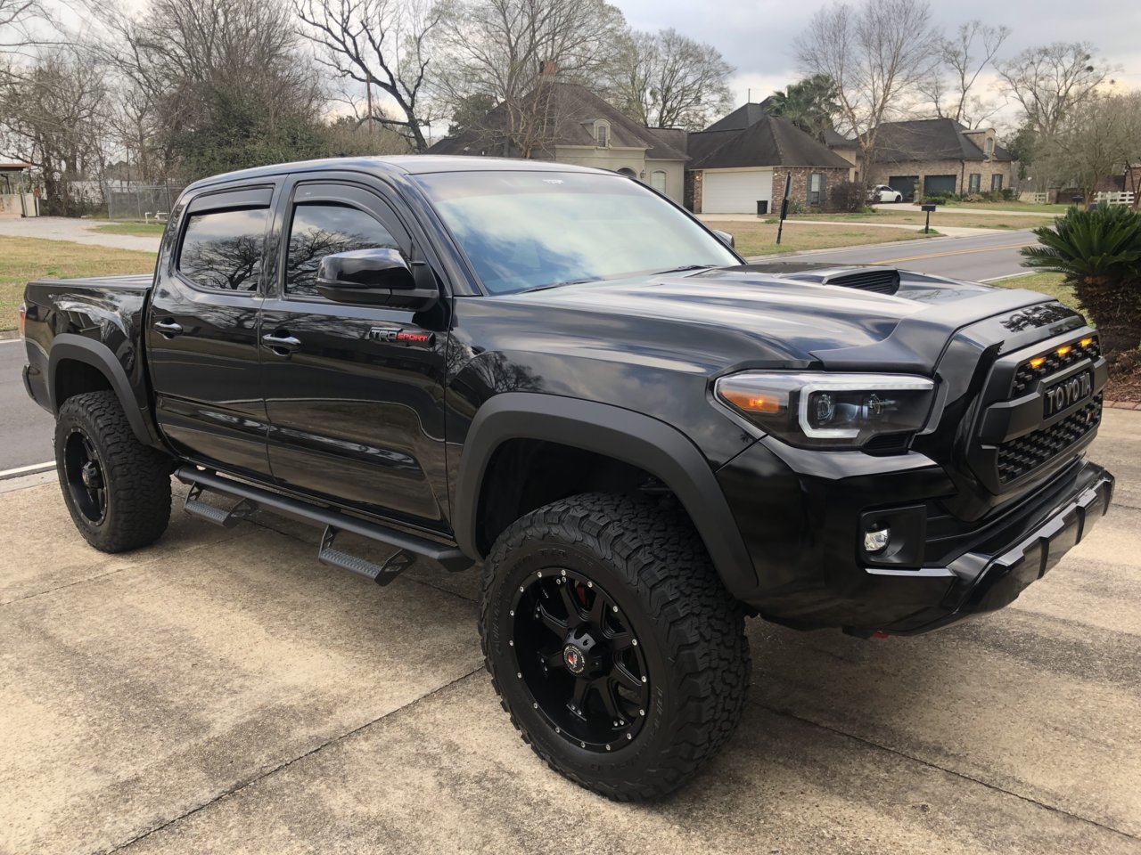

  8. Mar 2, 2019 at 4:25 PM
    #88
    PapaRee
    PapaRee Pro Tuner
    Oct 31, 2015
    #168275
    3,249
    Kreg
    Prairieville, Louisiana
    2016 Black TRD Sport, Tuned, BHLM OEM LEDs

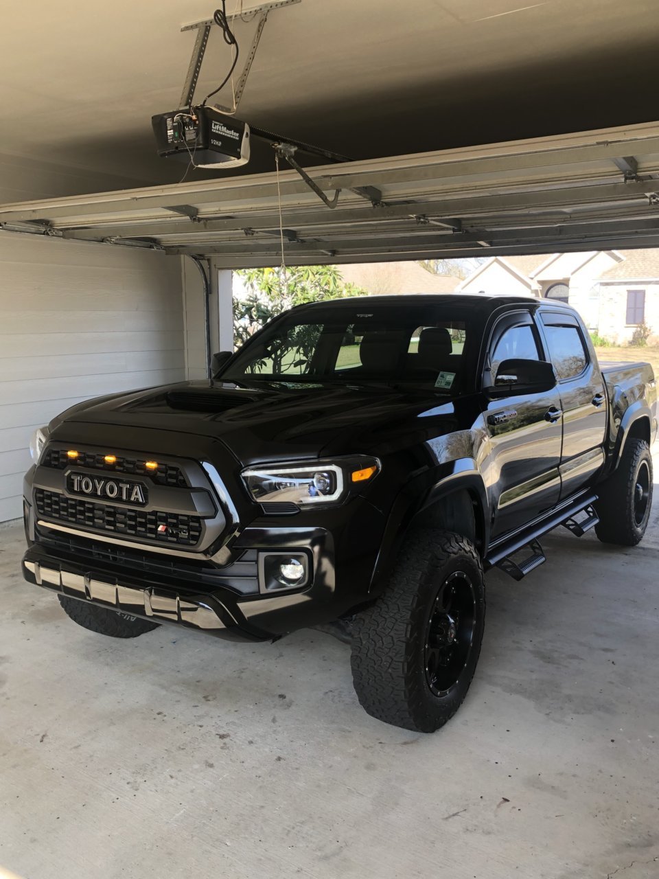

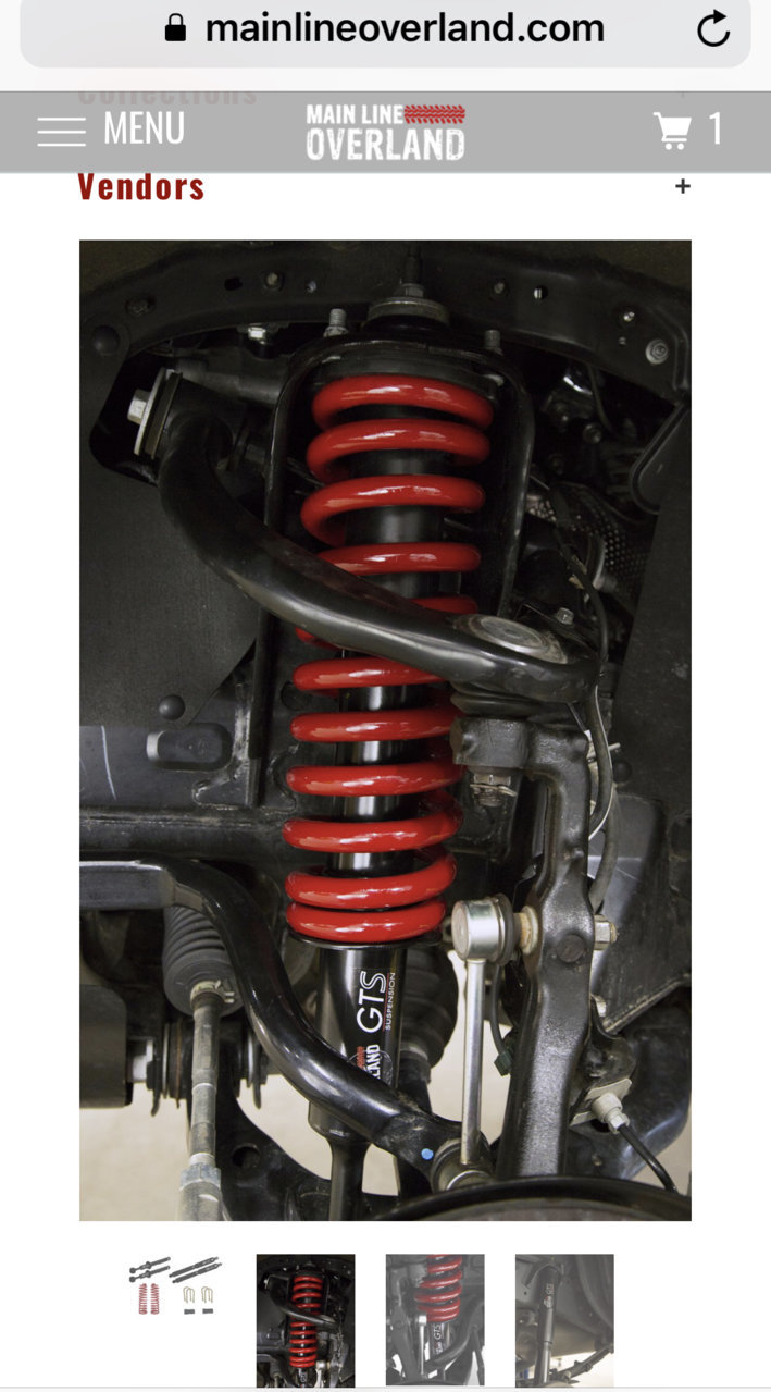

    GTS Dobinson's lift, 33"-Wildpeak Atw3-18x9 -6 Offset ,265/70/18 tires, Raceline Assault wheels, Backflip G2 bed cover, Magnaflow exhaust, Pro tail lights, Pro fog lights, Pro grille, Raptor grille lights, Predator side steps, RedLine Hood Struts, Toyota bedmat, tinted windows, Retrofitted-BHLM-Amber Halo-Amber DRL-HID headlights, LED Highbeams, LED Hood Scoop lightbar, LED hidden bumper lightbar, LED under hood light, LED Bed lights, LED license plate lights, Tacoma tailgate 3d letters, Tacoma glovebox 3D letters, removed air dam, Custom TRD Sport emblems, Pro Shift Knob with Meso ECT Stealth button, Meso LED dome and map lights, Meso V3 smoked mirror turn signals, Meso Stage 2 Tail lights, Meso Mirror Puddle lights, Meso KC-5 Brake/Cargo light, Meso center console bucket with OG lid, Tailgate PNP kit, Garage door opener button in overhead console, Meso Minimalist keyfobs, Matte black Pro hood decal, KTJO4x4 Led door handle LED lights, Pioneer 6x9 3 way front speakers, Rockford Fosgate 6.75' rear speakers, TacoTunes tweeters, AJT black vent rings, JDM Gas cap cover.
    I have a 2/1” (spacer/block) lift. With the C rated (6 ply) tires, it rode good- just like stock. Then I put on 18” wheels with 33” E rated (10 ply) tires, and now it rides like I’m riding on rock tires (I know, I am). Even with them aired at 32 psi.
    So my solution is the GTS Dobinson’s suspension from Mainline Overland. I talked to Eric (@eevaldes) on the phone and ordered their suspension kit ($740)
    https://www.mainlineoverland.com/pr...-2-0-light-load-front-and-quick-ride-rear-kit
    I opted for the 314 springs to get 2.5” in front and tapered blocks to get 2” in rear. Should be here and installed next week.
    Just wanted to share my experience and give everyone another option.

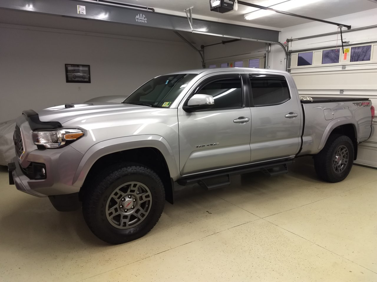

    Any pics of our truck? Love seeing the Longbeds, seeing so many shortbeds on here always gets me second guessing my choice for a LB. Didn't realize the SB was so popular on here before I got it. Rarely ever see a SB where I live.

  19. Mar 3, 2019 at 3:19 AM
    #99
    VaToy
    Mar 26, 2018
    #248467
    4,745
    Parts Unknown
    IMG_20190208_074034716_HDR.jpg IMG_20190208_074053360_HDR.jpg IMG_20190101_121203445_HDR.jpg IMG_20181216_145707763.jpg IMG_20190101_121203445_HDR.jpg IMG_20190219_215900261.jpg IMG_20190219_215912580.jpg
