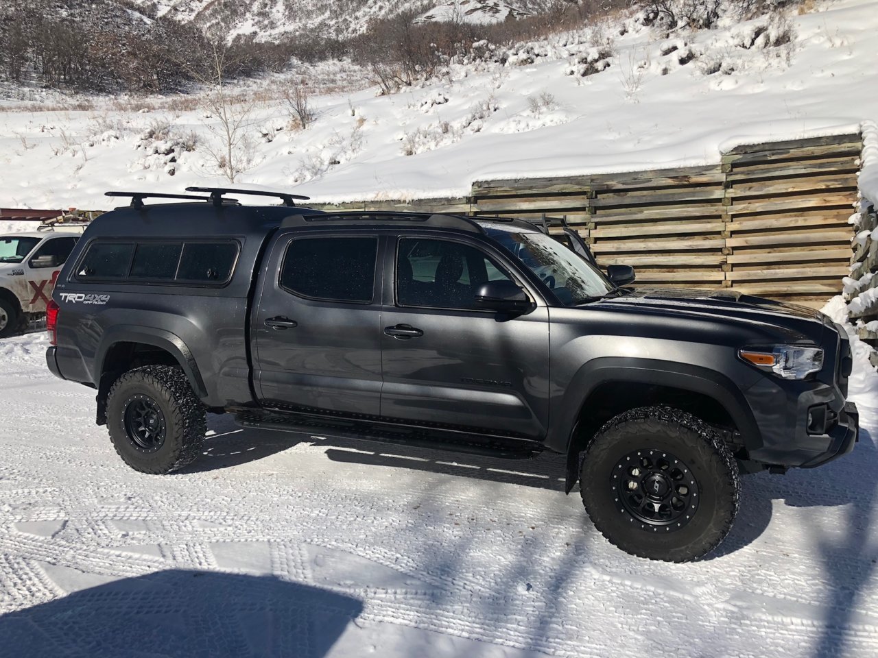

    8E008DD5-BFA9-46FF-BA5E-1DFDDC1E40BB.jpg Blistein 5100 at 1.75” up front and Extra AAl rear. 265/75R16

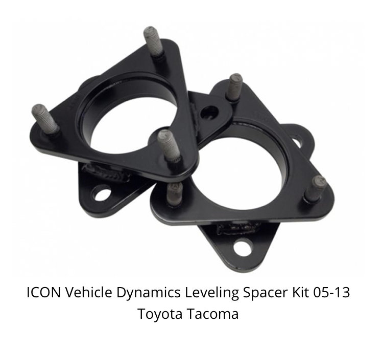

    Couple years back when I had my 09 Tacoma I ordered icon 2” leveling spacers for the front and I ended up not using them. I emailed icon to see if they’d work with my 18 and they said that they should. I still have them brand new if anyone is interested! Rando google pic for now, but I have both spacers and the hardware included. I believe I paid around 180 bucks.

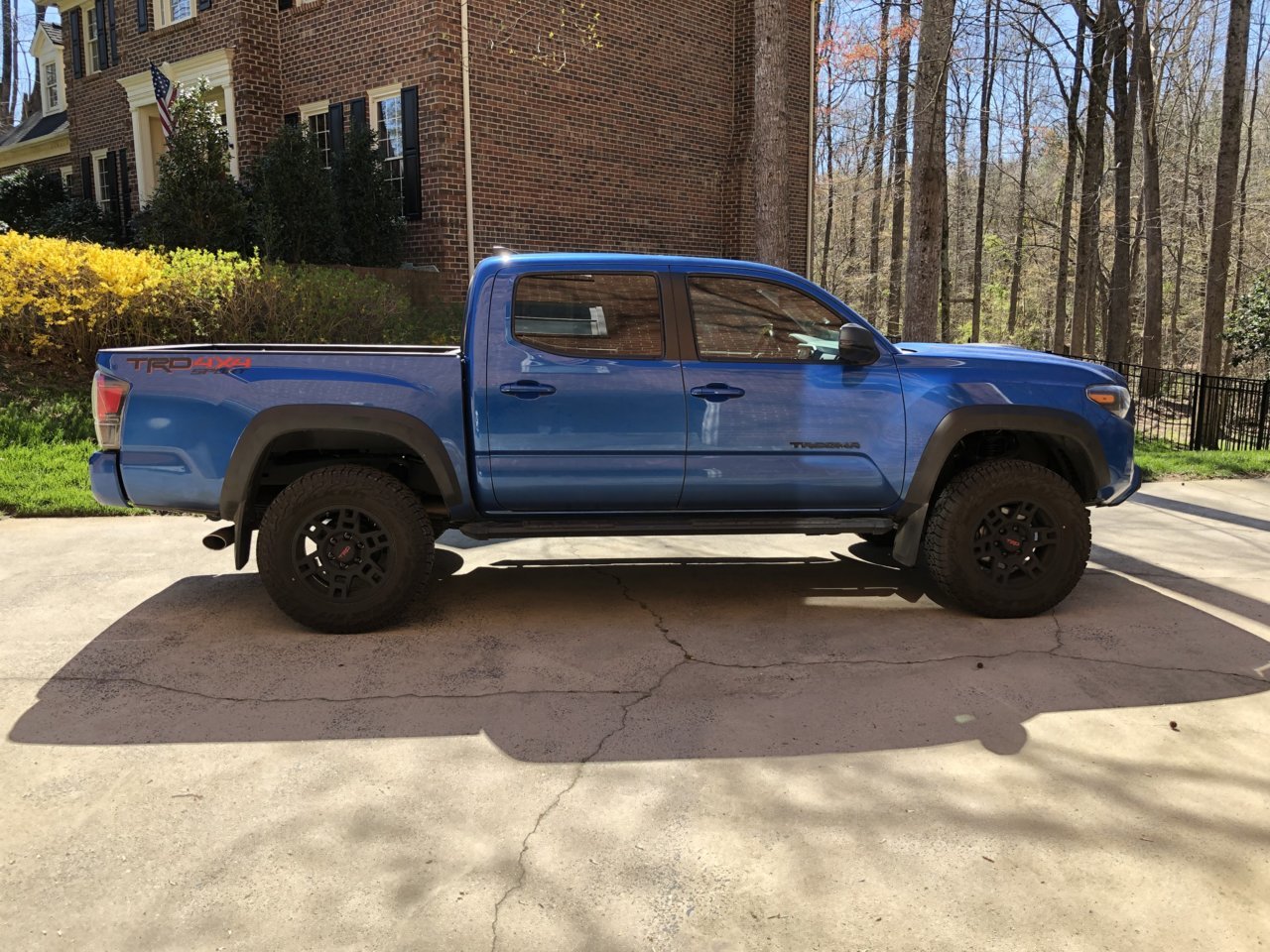

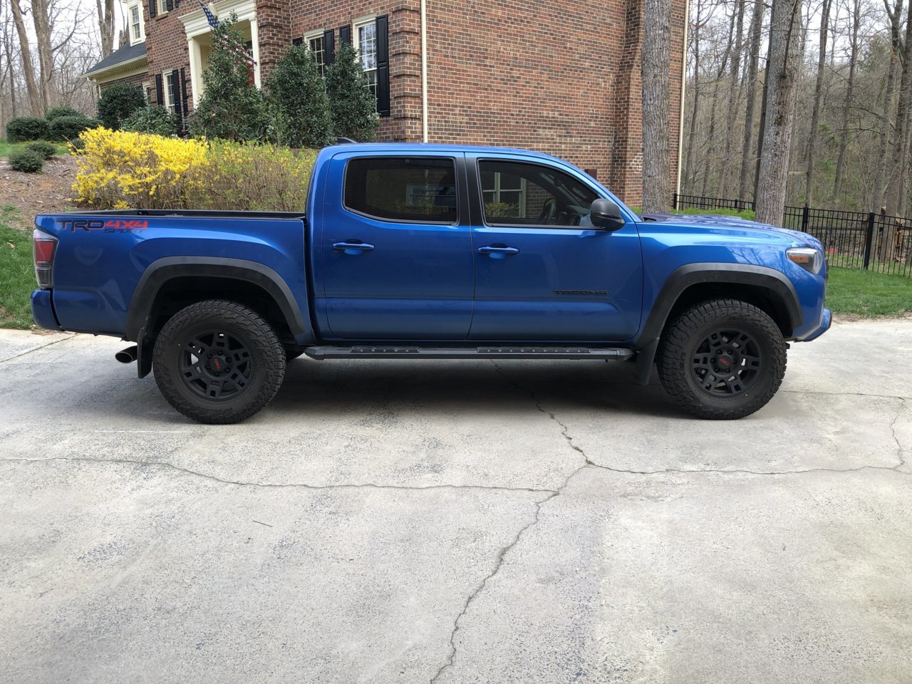

    Bilstein 5100s all around, front set to 4th notch (1.55 inch lift), with 1 inch block in rear. Still have 1 inch of rake which is what I wanted. Decided to have the ECGS bushing installed as well at the same time. My tires are 265/70/17 so this mild lift works well in my opinion. Before and after below.
    Before
    After
