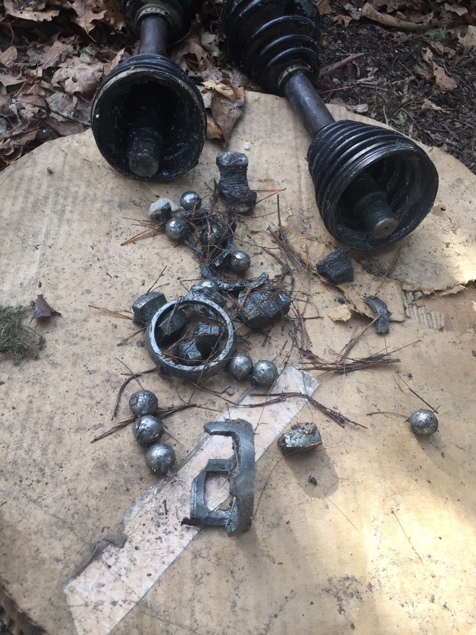

    As others have said Remans are crap. Weak bearing cages...
    Mine are autozone remans. No issues with the warranty even returning two at once. They break pretty easy but I guess they are free after the first one.
    The OEM ones sometimes even break on the shaft which just goes to show how much better they are built.
