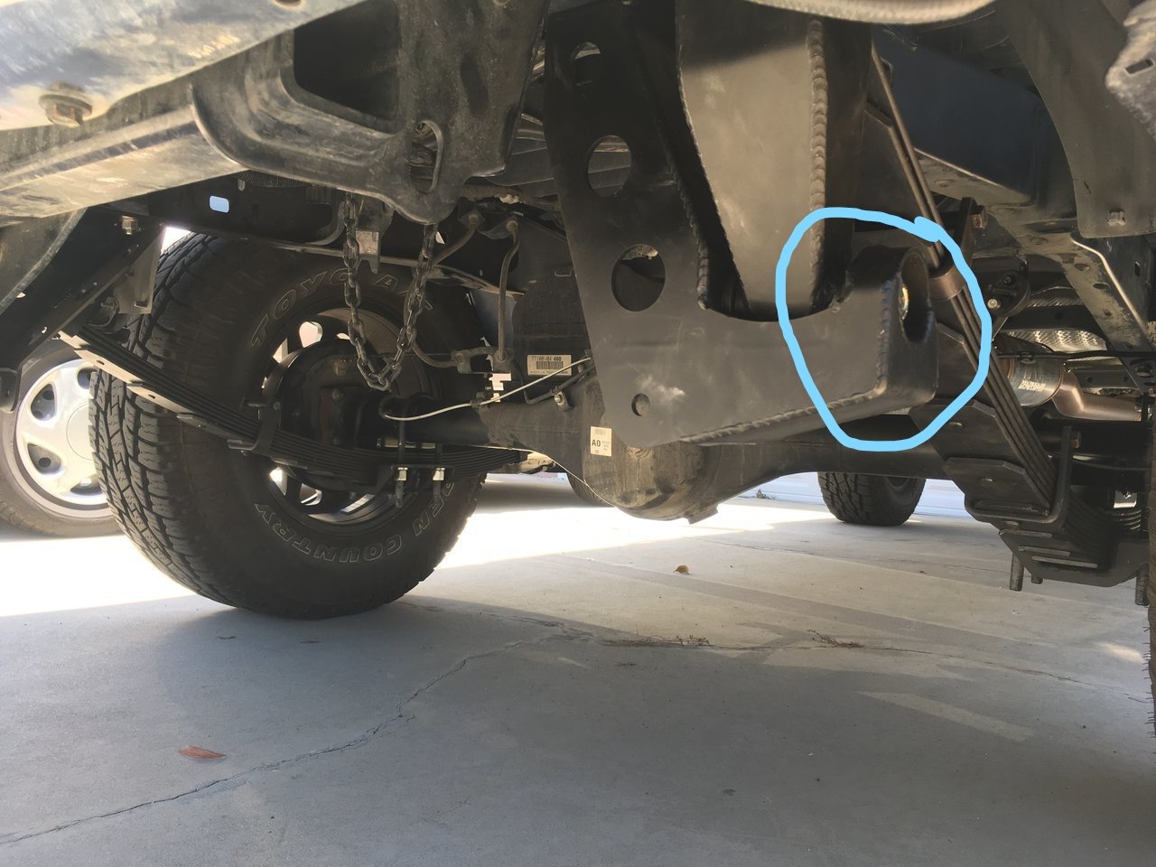

    everyone that i have talked to about the kit says the same thing about the bushing and they ended up putting different ones in ...

    For me, its the bushing thats circled. The whole flair end of the bushing looks worn through at the base and peeled right off. The other side is starting to bulge in a similar manner, and I'm expecting the same to happen soon.

    I would call Tim at DMZ fab and see what he has to say about it ... also the reason why i never went with that kit is because c.a.m.b.u.r.g customer service is not the best and
    that why I did TC all the way around because of the great customer service.

    I'm planning on calling him. Hoping I can just replace the hangers. I also need to call the shop that did my cantilever and make sure that won't change any geometry...

    Replacing the hangers won’t do you too much good. You’re going to just have to get new bushings to fix the issue. Cool to see someone leaked pictures of my truck on here.
    Nobody said LT was going to be easy... Nothings perfect and as you all know, this stuff requires extensive upkeep.

    I was thinking maybe if it would bring everything back square. I'm going to try higher quality bushings first and go from there.

    If the leaf spring perches we’re welding on in the correct location it would also cause the issue you’re having. Next time you install new bushing completely unbolt the axle from the springs and once the new bushing are installed see how close the perches are to the width the springs naturally want to sit at.

    Ill take a look at it when I go to replace the ones I have.

    So I talked to burg and they gave me some delron bushings to try. Installed them yesterday. Not super confident they will last any longer. But they said if these fail, they will look into replacing parts. At least it seems like they're standing behind their product.
