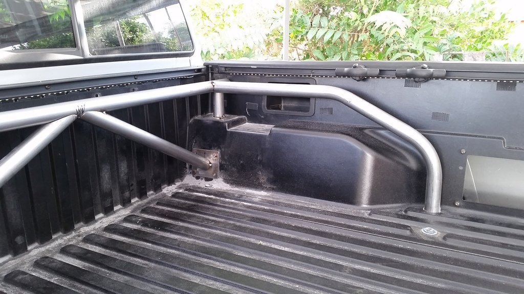

    Give Tim at DMZ a call. He has a bolt in bed cage for around $1500 I believe. If you let him know you want to save as much space as possible I'm sure he can design one that won't take up much space.
    Example, here's one that @jeffz0rz did that is not bolt in, but you get the idea.Or just give Jeff a call and see if he can make you one and ship it up here
    And the Camburg kit should be pulling something around 18" of travel in the rear.
