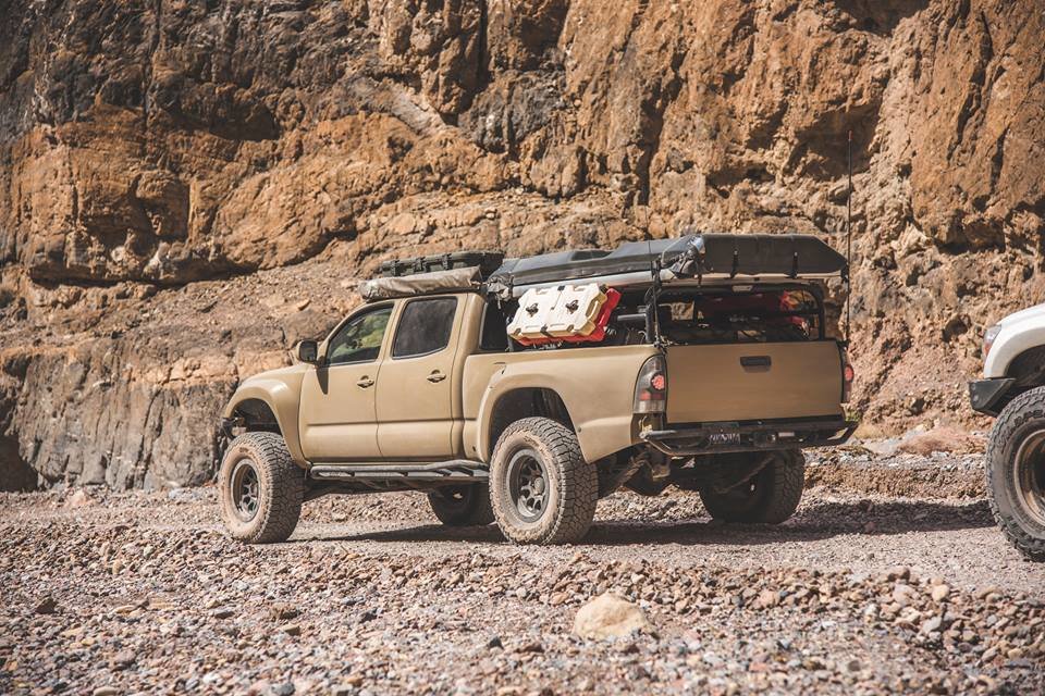

    It's all good in the hood. I do. Just know your limits and where the lowest points are.
    DMZ SUA kit with 11 Leaf Deaver HD pack. Although @dirt designs did come out with a 3 link setup for OEM gas tank/frame setups. I am considering as my rear sags when loaded all up.
