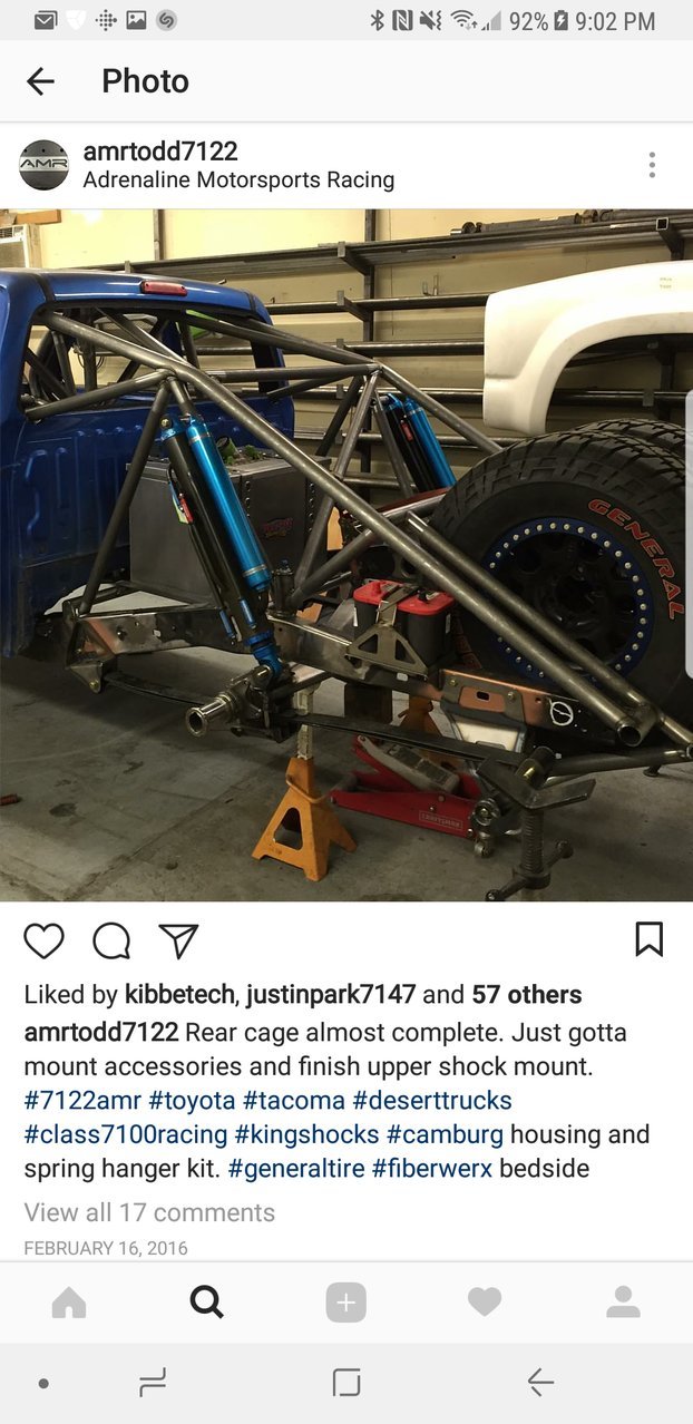

    I’ve thought about C-notching the frame, to gain more up travel for the axle, with either Camburgs kit or Giants kit (whichever I go with).
    But with this picture, you probably couldn’t do that? As the main leaf is already flat, and any more up travel, it’d be going into negative arch, which isn’t good.
    Has anyone ever c-notched the frame with an SUA kit?
