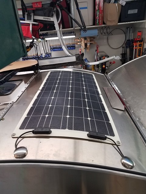

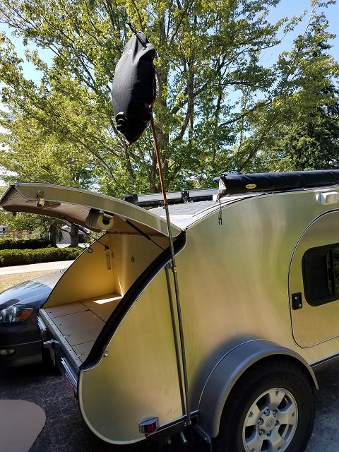

    • I have a hard mounted flexible 100w panel on the back of the trailer:
    I used Blue Sea Cable Clams for routing the cables inside. If I were doing it again, I'd use Scan Strut cable penetrations. I used the Scan Strut for my truck's 160w panel and I think they are easier to get to seal. I had to use a crap ton of sealant with the Cable Clams. I'll know if they leak though, since the water will drip right next to where I'm sleeping :)

    I love your water setup - actually makes a lot of sense to have that level of flexibility. Had any difficulties when you're refilling having to do so many containers? It had actually crossed my mind to go with a bunch of 2 gallon jugs.
    Your solar setup is almost exactly what I'm thinking. Thanks for the tip on the cable penetrations. How well does it keep your battery charged? Any additional charging you use regularly?

    The panel does a decent job when we have enough sunlight. It is convenient having it permanently mounted, but that convenience comes with a loss of efficiency. I don't usually bother trying to keep it pointed at the sun since I'd have to move the entire trailer. I think that a temporary portable panel would yield better results but it would also increase the odds of theft and entail more setup. My fridge is plugged in the bed of the truck (which has a separate 160w panel), so really I'm just topping the battery up from running the lights and fans, plus whatever is used charging phones. The only other draws on the electrical are the propane/co leak detector and the solar panel charge controller. The controller is actually a bigger draw than I'd expected, pulling about 0.2 amps. It's enough to run the battery down in storage over time, so I've added a switch that disconnects the panel and controller from the battery.

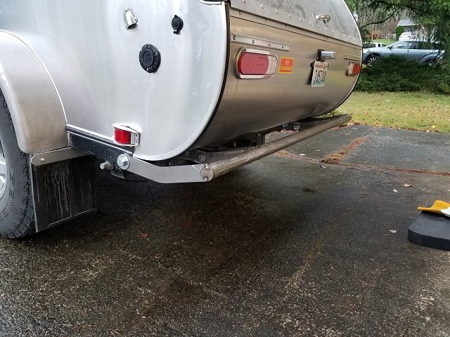

    For additional charging, I've got a 10a NOCO in the battery compartment with an external plug that I can use as a poor man's shore power. My battery compartment is on the aft driver side corner of the trailer, under the galley counter. You can see the silver clamshell vent I'm using to vent the space. The small black fitting is a 12v cigarette lighter style socket that I originally used for connecting a battery tender. It's no longer connected, though I keep thinking I'll wire it up for external power. In reality, I haven't had a need for power in the galley, so right now it just seals the hole. The bigger black fitting is the NOCO socket. I'll use the NOCO for a day or two after a trip to top off the battery before it sits, then I'll throw it on again the night before hitting the road to make sure it's topped up.

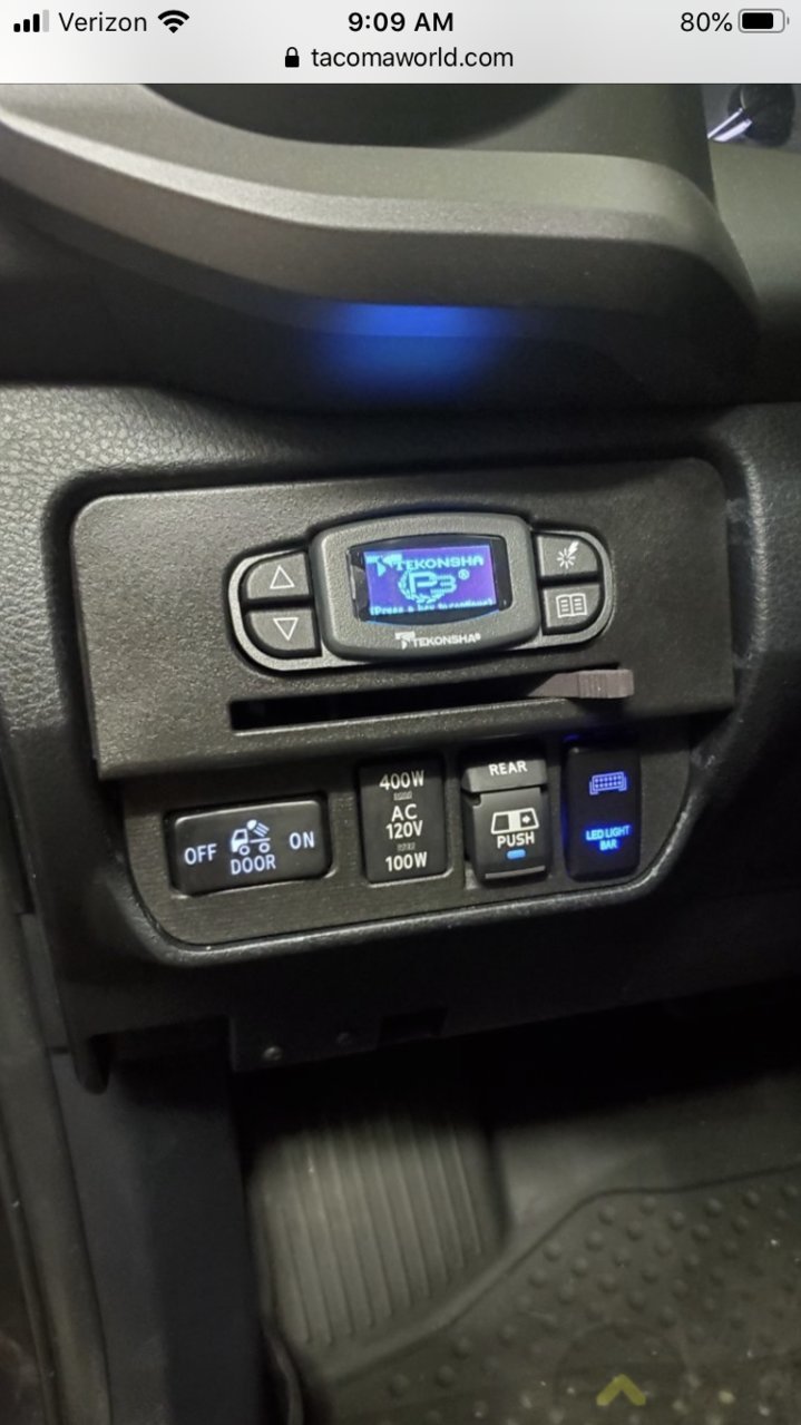

    On your brake controller, someone makes a really clean mounting plate for the P3 and the 3rd gen. I thought it was @MESO but I don't see it on his website. Here's an image I found online (ha! it's on TW somewhere...) I'm going to try and print up something similar for the 2nd gen, though it's going to be a while before I get to it.

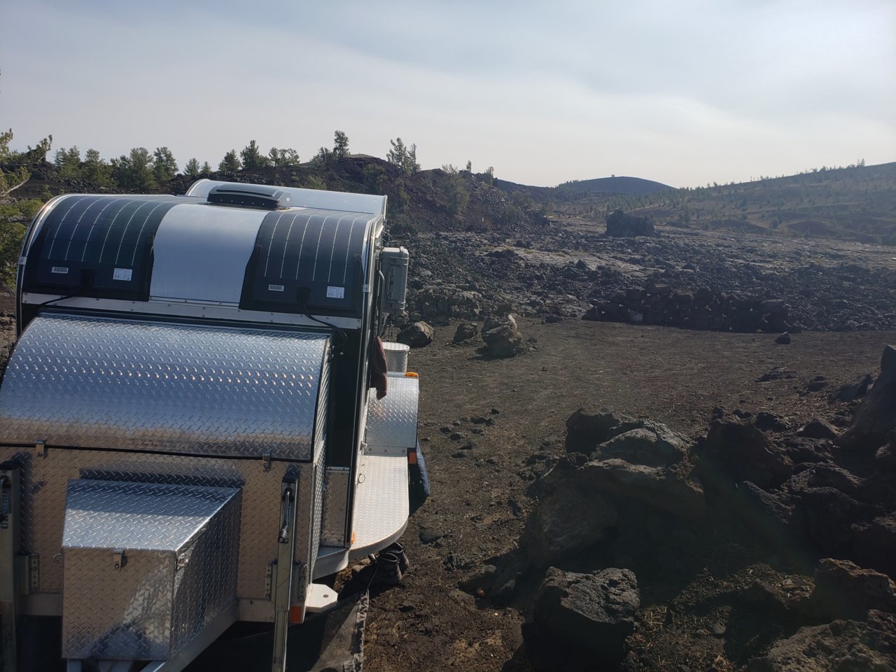

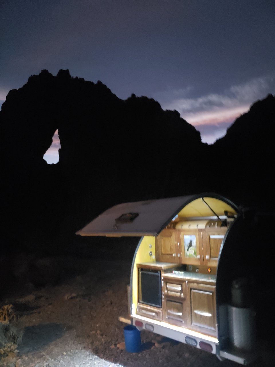

    Solar panels are flexible self stick variety from Amazon
    Water heater on side connects to propane tank and water tank. Lights instantly with water flow, heats quickly. Hatch under bedroom is the basement that stores all the camp gear for a base camp. Chairs, tables, ez up, awnings.
    Full kitchen with fridge, oven, stove, and wine cabinet.
    Yes, we're more than most want in a trailer but we live comfortably anywhere we can tow it. We've got 30,000 miles on this set up, nearly 10,000 miles since June.
    Build thread is on Expedition Portal ( CrowsWing) and TNTTT ( so long and thanks for all the fish )
    *in my short sightedness I edited the quotes with answers. You'll need to expand the quotes to read those
