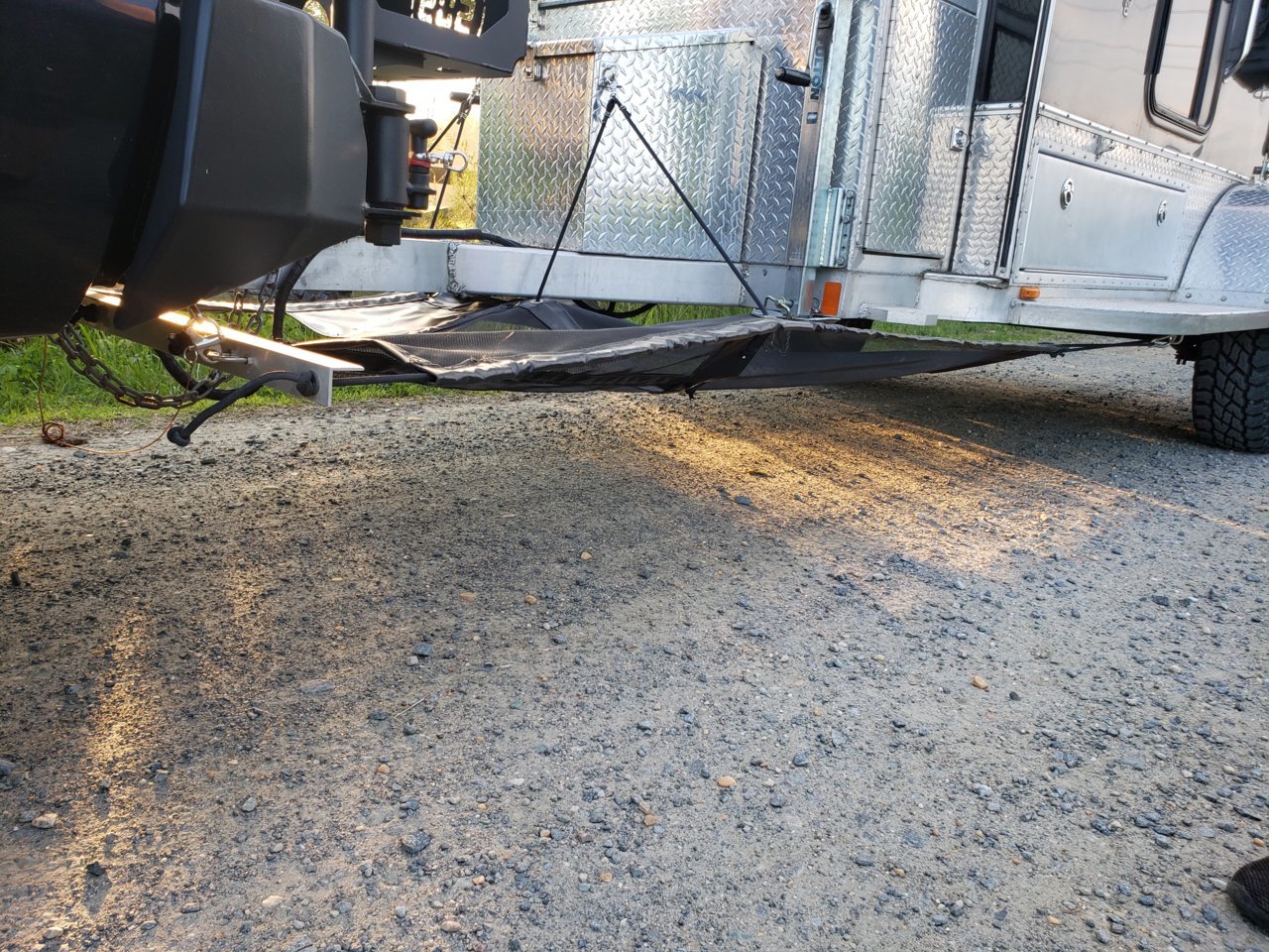

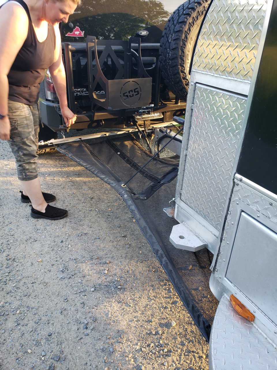

    We made this Aussie style rock guard. Actually works great on gravel roads.

    That looks amazing. Guessing it's removable?

    Yes. Has carabiners that attach to truck and trailer for easy on and off. Its worked very well.

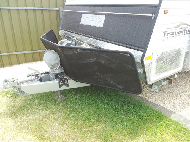

    That looks good and light! I was thinking of going something more along these lines:
    Your style looks like it would offer more protection up higher... Hmm....
