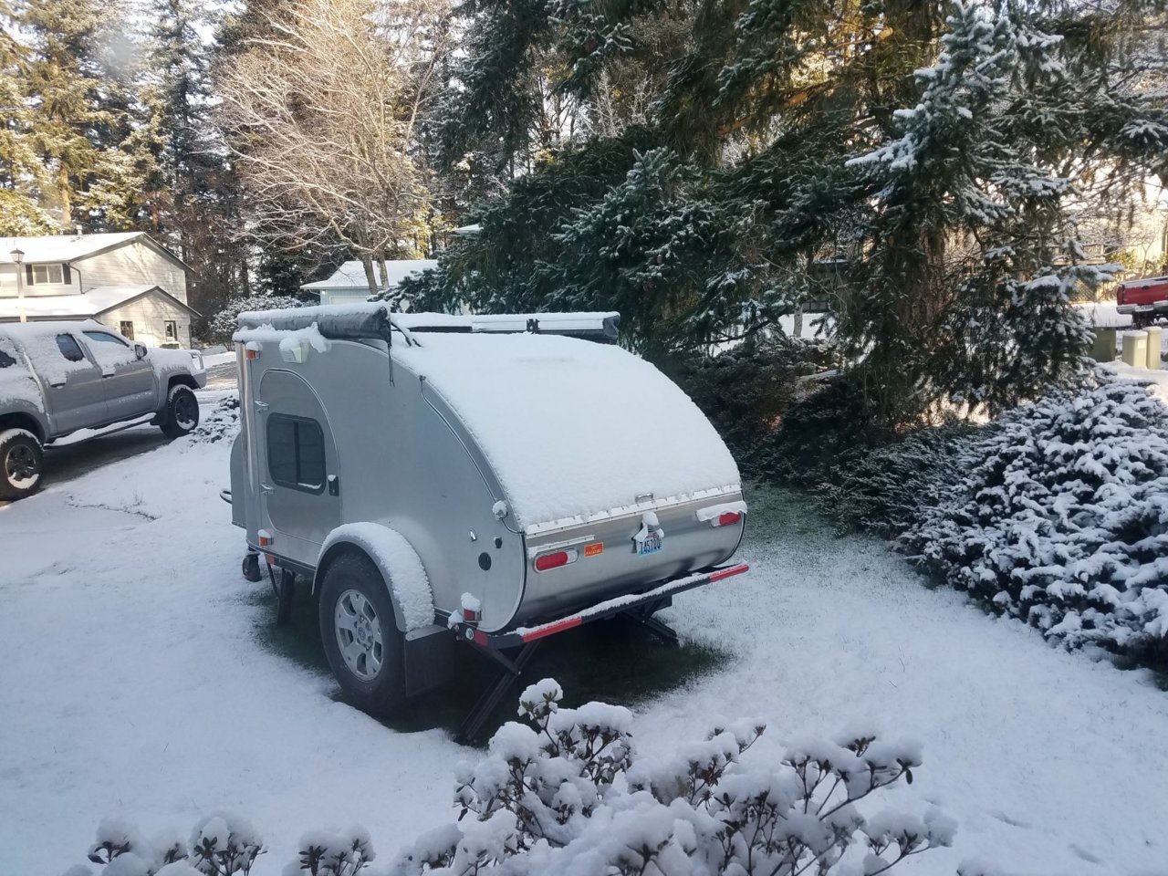

    Everyone getting their trailers out? I've managed to get two trips under my belt this month, one with my son and I and then one with the whole family. Managed to not take a single picture of the trailer during either trip. I did a test run last month during a cold snap. I was curious how the furnace would do and how it would be in the trailer. I wound up making a set of insulated curtains after that night.

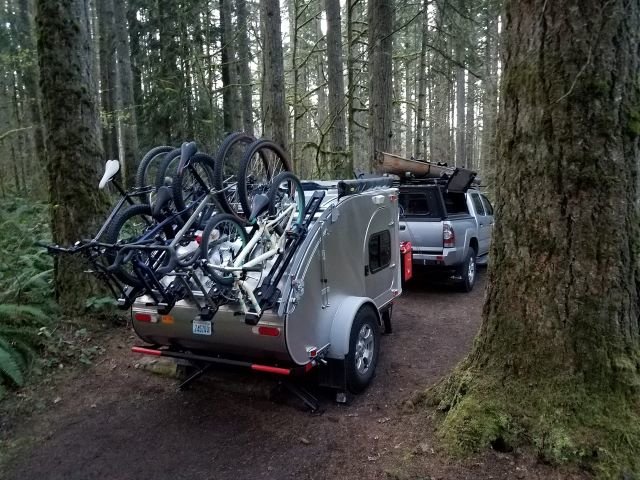

    More recently the kiddos have gotten comfortable enough on their bikes that we started taking them with us. Unfortunately, with a DCSB full of camping gear the only place for bikes at the time was the roof of the truck. Want to guess what four bikes on your roof does to your freeway mileage? Hint: It's far worse than carrying the canoe up there. The other issue with bikes on the roof of the truck is that it's a complete pain to get them up there or down.
    So what to do... Well, I looked at those fancy newfangled racks that go into the hitch. My trailer has a hitch, but after talking with a buddy who travels with one of the vertical racks on the back of his trailer, he didn't recommend it. They're very expensive and the back of the trailer can bob up and down quite a bit. Heck, most of the manufacturers don't recommend using them on the back of an RV or trailer. The other issue is that I would have to figure out how to pivot the rack out of the way of the galley. Not insurmountable, but it seemed kinda hokey to me.
    Which led me to the idea of putting my existing bike racks on the trailer. Except that's the same problem with putting them on the roof of the truck with the added aggravation of two solar panels and a vent to work around. The hatch would be the ideal place if only it didn't have to move. Well, what if the rack moves with it? I don't trust the hurricane hinge to support that much weight without help, but I also figured it'd be a pain to make a strong hinge line up with the hurricane hinge, plus I had to keep in mind that if I weren't careful I'd have the racks hitting the solar panel when the galley opened.

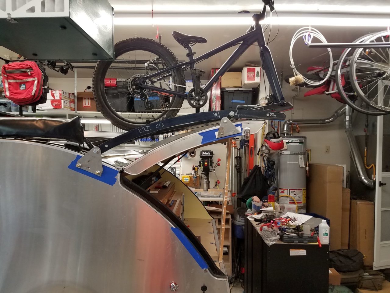

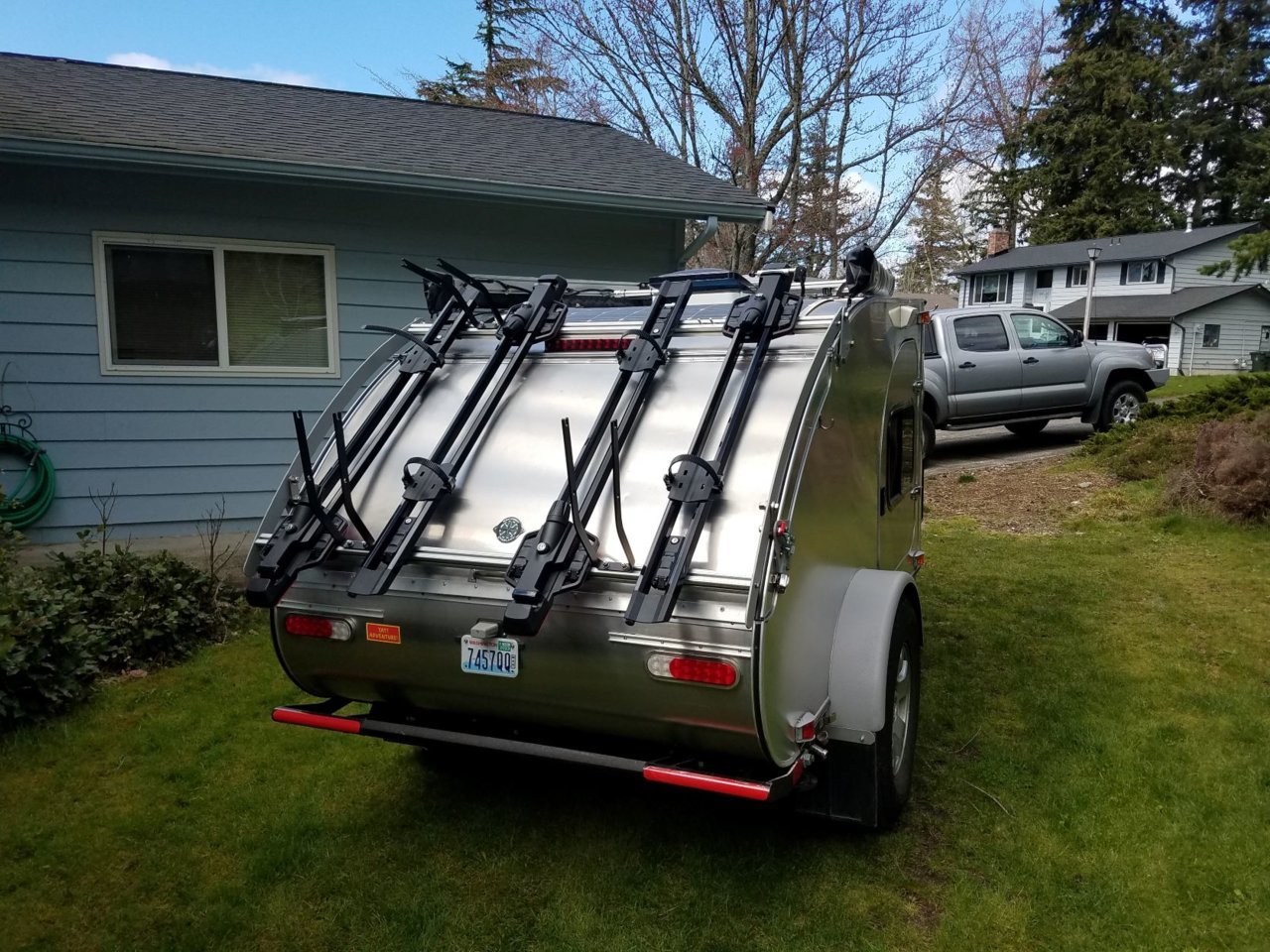

    So, what we have here is quite possibly the first four bar linkage teardrop trailer bike rack:
    So yeah, there's a linkage on the galley hinge bracket which allows the rack to stay more level as the galley hatch opens. It also allows the load to be shared between the trailer and the galley hatch, with most of the load being on the trailer side of things. The whole setup is low enough that putting the bikes on is really easy with both feet on the ground and the bikes don't stick past the rear bumper nearly as much as they would with any other 4 bike rack on the market. The teardrop is also wider than the roof of my canopy, so there's the bonus of having more space. I did leave a gap down the center to minimize blocking the 3rd brake light, the gap also makes it easier to get in and put the center bikes on the rack:
    I beefed up the latches for the galley lid and made some solid latching points to transfer more force off of the galley lid and onto the trailer when the hatch is shut. I'm not completely finished yet though. I beefed up the gas struts for the galley hatch so that they will hold the hatch up with the racks on, but not enough for when the bikes are on. I'm currently waiting on an additional set of gas struts that will go from the latching plate on the trailer up to the roof rack. These will be removable so that I can pop them off when we have no bikes and install them when we do have bikes.
    Camping season is almost here! Everyone else getting ready?

    Great idea on the bike rack. That seems like the ideal solution. And, you can carry a kayak as well!

    The bike rack worked awesome, no issues there. We had a couple of long days of gravel and washboards with no issues.

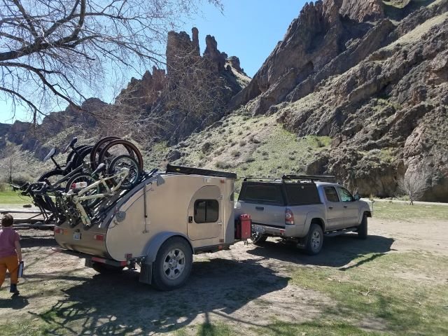

    Lunch stop at Succor Creek State Park OR. There's camping here as well and I think if we do this loop again that we'll add a day. There is a ton to explore:
    The road between Succor Creek and Leslie Gulch is fairly remote:
    Leslie Gulch was pretty neat, and there's a campground at the end (Slocum Creek). It was the coldest night of the trip (28*) despite being the warmest day (65*)

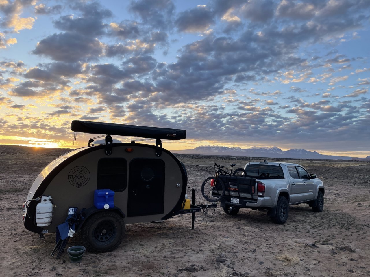

    well, might as well throw my teardrop setup in the mix. This is my fourth TD and basically 'upgraded' each time. Just started towing with the Taco. Came from a 5th gen 4R
